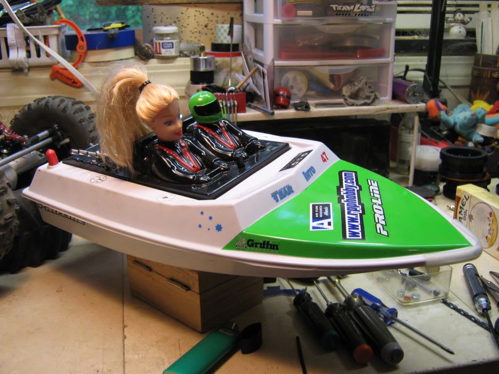

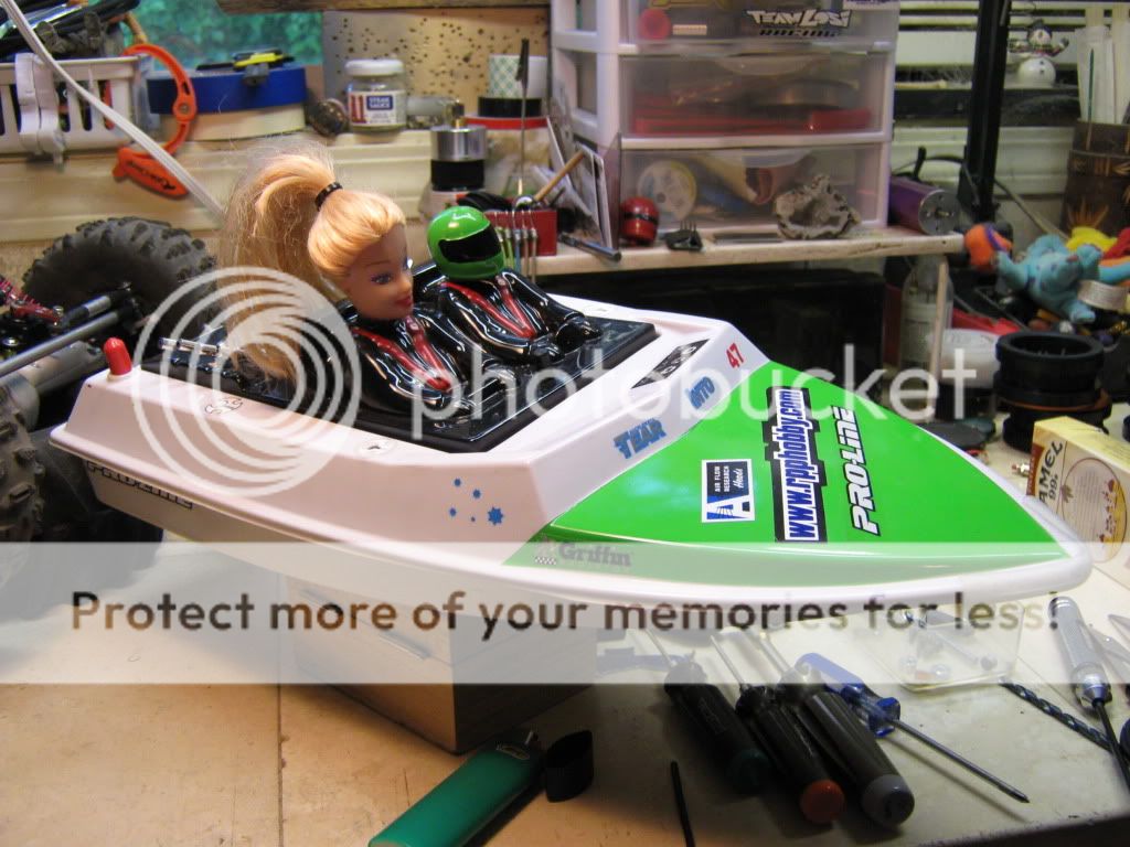

    I love me some boats ;D ;. I usually run my jet at least 1 night a week, more if others are around. Its a modded nqd hull and is setup for running rapids and rough water as opposed to top speed. for the money its the best rc I own. You can run them in almost no water, jump them, run into each other, it doesn't matter they come back for more. A couple weeks back me and another buddy went out and jumped them close to 30 feet in the air :eek: and they took it no problems.

    Does your girlfriend complain about the wind messing up her hair?
  4. highlandcrawler
    No, just when we flip and I drag her head across the rocks hahahaha
    I thought those boats are molded hulls so what kind of mods can you make?
    Maybe you need some Chucky heads...

    A lot! The boat is undrivable as it comes out of the box. No proportional controls for anything and slower than a walking pace. First thing you have to do is cut the top section of the hull off to gain access to the insides. Then you have to gut them completely. Then find what power system you want to run and install your goodies. While I have the jets out I like to do a few little mods to them also to improve flow. You need to drill some cooling holes in the hull and re glue the factory seam at the hull lines. Then just seal it all up till she is leak free. The first ones can be a little tricky but ive done so many now I know all the little tricks to make it easier. It takes me a hour or so now to do a full conversion.
