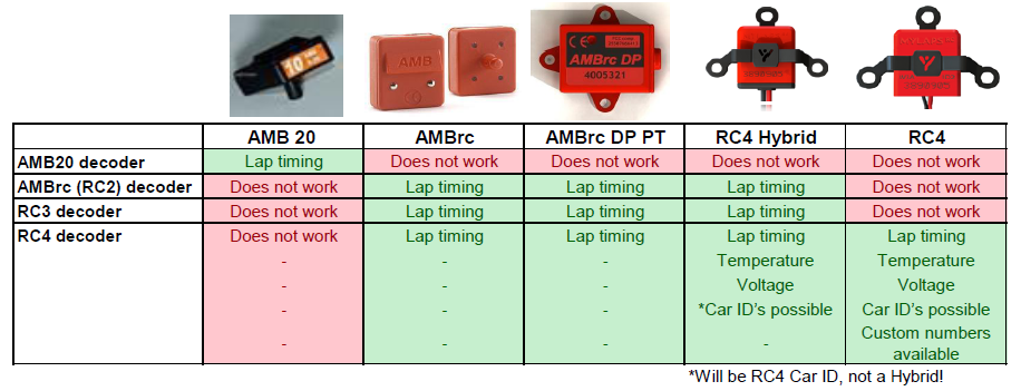

    Stormerhobbies has the mylaps rc4 transponder for $84. If that one will work with the system, that's about the lowest price I have seen. I run the mylaps hybrid and it works everywhere. $100 at amainhobbies
    This compatibility chart is from MyLaps:
  4. Nexus
    So reading Sincad's post "The AMBRC4 that we have is the hardware decoder..." and looking at GPS' chart it looks like everything except the AMB20 will work.

    You are correct, all AMB transpos other than the decade old 20 will work with our decoder.  If someone still has an old 20 I'd love to see it 8)
  14. Nexus
    We ran the old 20s at K-Falls, like, 10 years ago. Drill a hole in the body and hang it from the "hood" with a body clip.
