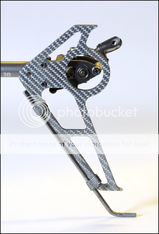

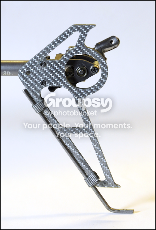

    I made the following Tail-FIN Extension because the KBDD Tail-Blade's I was using we're slightly (approx 2 - 3mm) longer than teh stock blades on my ep200, GAUI. As they we're recommended the KBDD Blades DID offer more 'Tail-Authority' but I was 'clipping' the NEW blades on my take-offs and sometimes my landings
    The extension itself is made out of simple Coat Hanger wire sanded smooth to remove the Varnishing. To fasten the extension onto the FIN I bound with Solder Wire and glued the binding with CA. The photo shows the extension is mounted similar the Eyelets on our Fishing Rod's
    Well there you have it, ONE simple EASY to make Tail-FIN Extension w/ NO more Tail -Blade HIT's
    ... And for my bonus reward I found after crashing the Carbon Fiber is stronger than my CA'd Wire binding. The extension simply brakes away when crashed thus saving me replacing a 'broked' Tail-FIN. The 'MOD' made for a handy 'Crumple Zone' saving my Tail-Fin in more cases than not ... Albeit that is more an anecdotal observation ... "your miles may vary" ...

        [size=0.8em]Yes, that is a damaged Tail-Blade Grip[/size]
    What the MOD looks like on the Helicopter

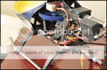

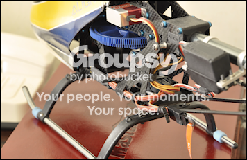

    ... I found some old photo's that shows how I've done the 'nose down look' on a previous TRex 450 build's ...
    For this DIY modification, ALL that was done was to add spacers. Two 'TRex450 Frame Spacers' which raised the rear
    'Landing Gear'. On my small GAUI's I've used small Bearing to get the 'look' in any case what someones else might use
    is only limited by the imagination
    Click for the larger PICs
            ... on this build I used two little  'Springs'
    Again needed/wanted or NOT, if only to keep out of the grass, or for the LOOK, or both that's a personal choice ...
    I remember those photos.  I wondered at the time if the springs worked as shock absorbers.
    LOL, everybody, everywhere I have posted that PIC has also wondered that same thing ... In practice NO as the BOLT is locked into the plastic at each end! Beside there are two parts to any Suspension System, the Shock Absorber itself and the Spring, missing either one and the system fails
