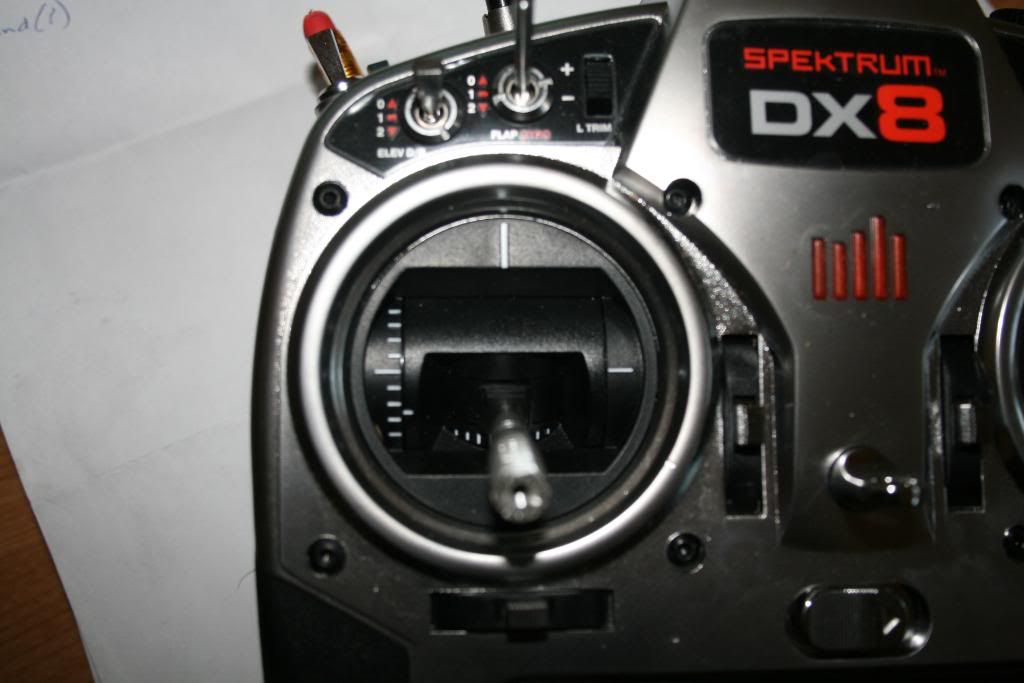

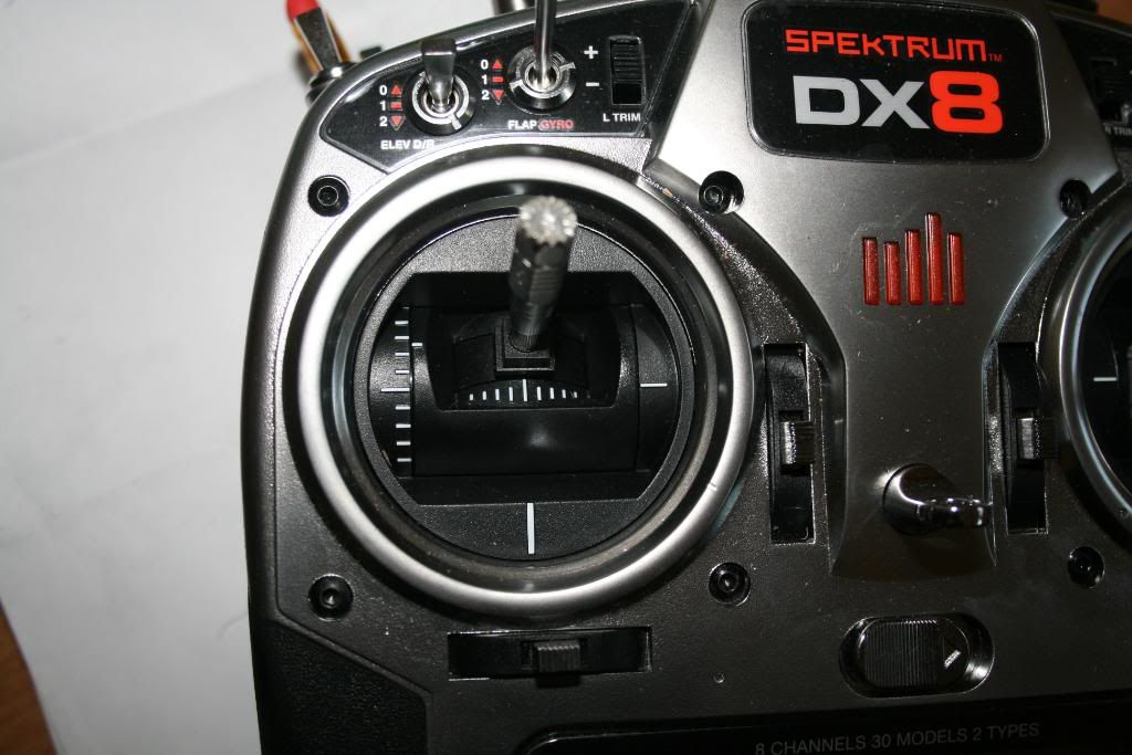

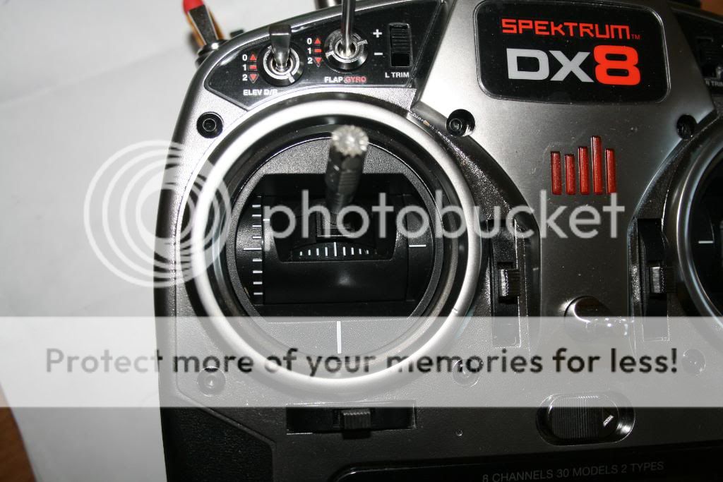

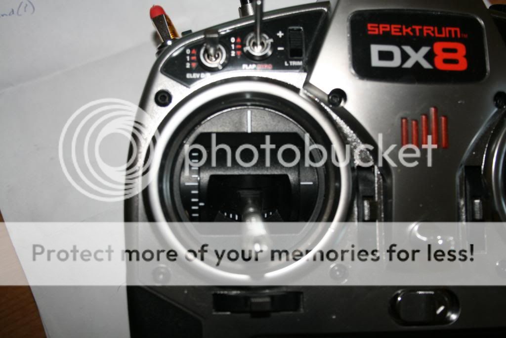

  14. Golden Child
    Gimbals are MUCH smoother and adjustable for length. Supported on all sides with bearings. The left stick somehow comes with limited throw (pics below). I'm scouring the manual to see if this is correctable or if it is designed this way for a reason. I know the throttle ratchet feature can be enabled by removing the back and tightening the spring tension. The programming features are very straight forward and selecting wing-type could not be easier! Even the manual is easy to understand. The LCD is of course backlit making it infinitely easier to read. The biggest feature I was interested in when I decided to upgrade was the ability to use multiple mixes on a single aircraft (i.e. - elevons and flaperons). I fly my F-18 on elevon mixing with four servos (one for each main wing , and one for each elevator surface), meaning I have the elevator surfaces doing the same thing as the ailerons for both elevator and aileron stick movement. This worked well even on the DX6i, but with the DX8, I can also add flaperons with a little up-elevator mixed in and cut the take-off/lading area needed by almost half! I wanted to put this setup to the test most yesterday and it worked flawlessly. I've never landed my F-18 so gently!!!

    Hey GC in POST #53 you said ---> The left stick somehow comes with limited throw (pics below)
    ... Sorry Bud but I see no pictures ... Also curious about the limited throw ?
  19. Golden Child
    Woops! I did forget to post the pics - sorry! Here they are. Note the throttle position indicator (hash lines for those that are not familiar), these are at max throw ??? Been busy with family and geting the house ready for the Rose Bowl party so I haven't found the section in the manual that describes throttle throw adjustments. Stay tuned - I'll get to it!!
