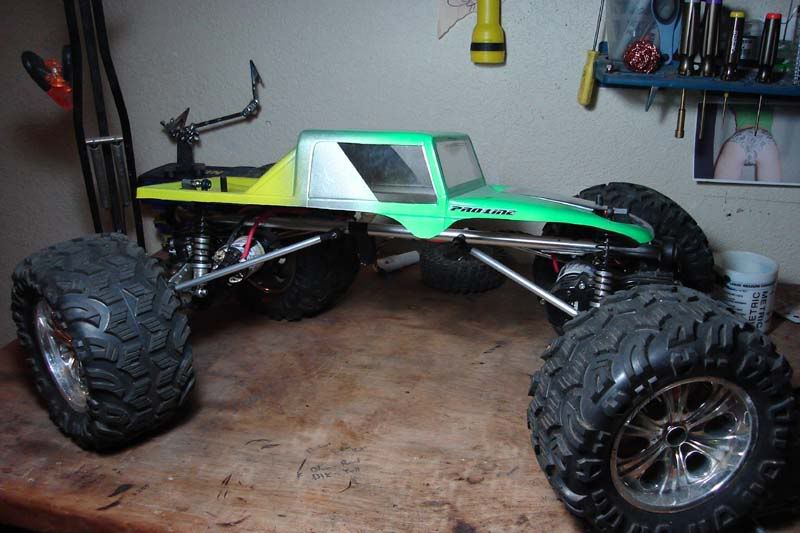

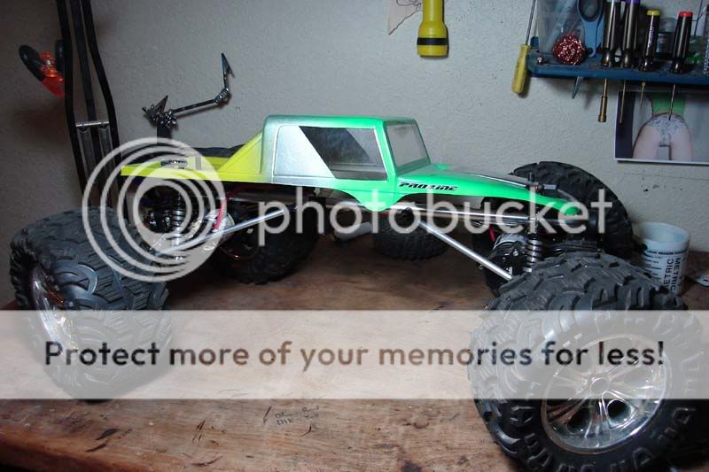

    Have you guys built any 1/5 scale crawlers?
  9. highlandcrawler
    Cant really say what scale it was exactly but this one I made was bigger than 1/8 for sure. It had somewhere around a 20" wb and those were moab xl tires. It lacked a good radio system to control all the cool stuff but was pretty fun none the less. All I had was a 4ch futaba 75mhz ;D stick radio. I wish I still had it now but there was just no one to run it with at the time. I have been slowly squirreling away parts to build a berg based super for a while now also. Maybe some day I will get the time to kick that project in the butt and get it moving.

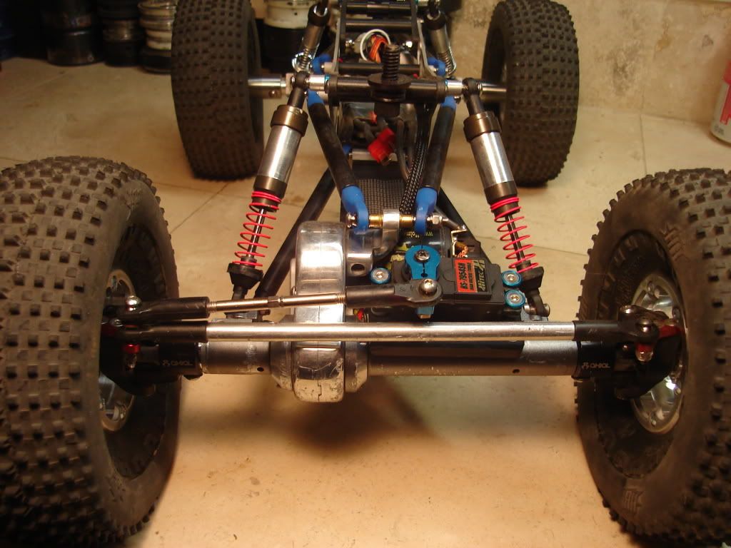

    And this set has been seriously worked over
