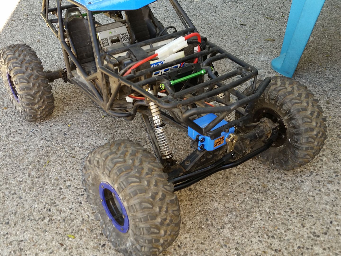

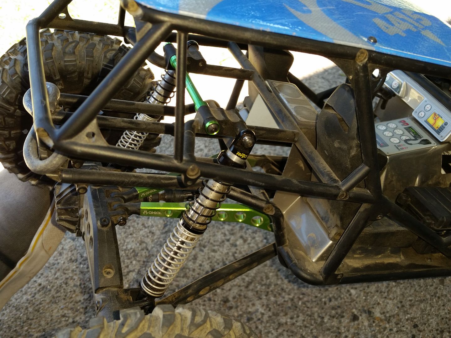

    So thought I would start a build thread on the Wraith. It's about a week or so old now and I am throwing ideas around on which direction to go.
    So to get things started I did some basic upgrades to improve it abilities and get it crawling better.
    Upgrades so far are...
    -New spur and pinion 87/16
    -35t brushed Axial motor
    -battery relocate to the front
    -relocated esc / receiver
    -RRD 110mm crawler shocks
    -strut tower braces
    -longer spacing on upper shock mounting points
    -white dot ripsaw tires
    -weighted axial 8 hole beadlocks
    -aluminum rear upper links
    -savox sw-0231 servo
    -STRC aluminum steering links
    -Aluminum servo horn
    -weighted chassis for balance
    -waterproofed vehicle
    I have more cosmetic goodies on order but for now I am working on dialing in the suspension and making a small drop (droop) kit to lower the cg a little more. I'm really happy with the articulation and with the heavier weight it seems to crawl well. The gearing is still just a hair off but I think a 85 or 84 spur will put it about where it needs to be.
    Anyways, here are a few pix...
    And the rear with the brace...
