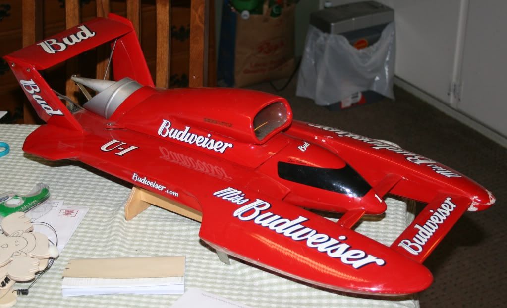

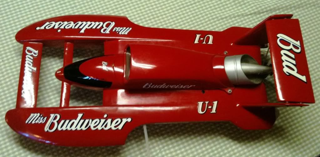

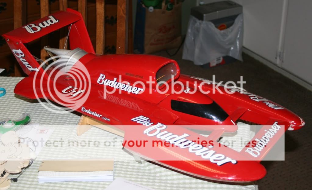

    So I gots me a new toy...
    Congratulations, that's a great looking boat!  That is what I would get if I got into boats.  I saw one called "Miss Elam" from Pro Boat that I always liked.
    I hope you post a build/repair thread when you tackle that model.

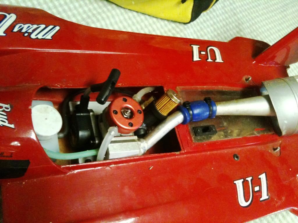

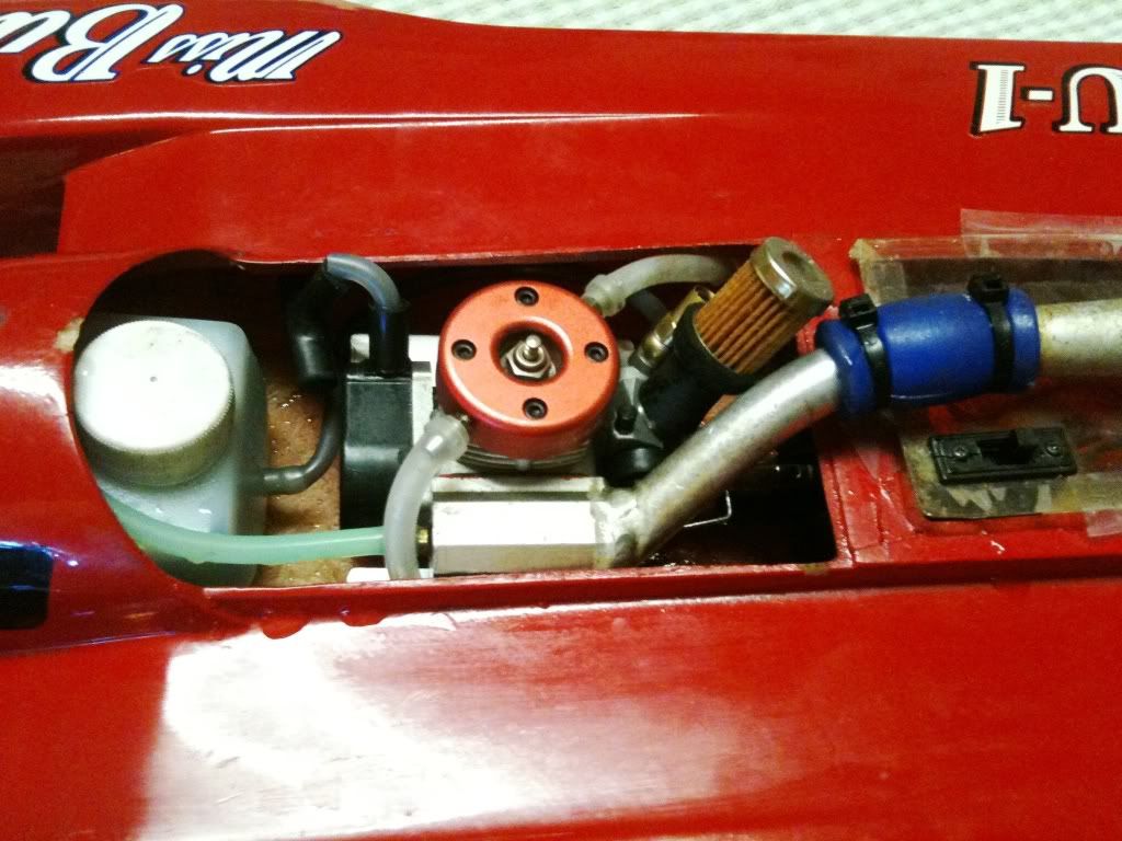

    What powers this new toy. It looks pretty similar to the one GPS linked to that has a water cooled gas engine.
    It is also made by Pro Boat, but is the 1/12 scale. It is currently powered by a water-cooled .15 nitro engine that will be replaced by a brushless motor/ESC combo over the winter  :D It also needs some fiberglass work, but that won't be a problem (done LOTS of that on my full-scale drag boats!). Traded my Duratrax EXT for it.
    Is that silver opening in the back metal?  It looks like a large exhaust duct but I see a silver cone sticking out the back also.  What is that?
  6. Golden Child
    The silver opening out the back is a fiberglass scale exhaust for the real jeat turbine engine. The smaller silver cone coming out of it is the actual exhaut for the .15 nitro engine.

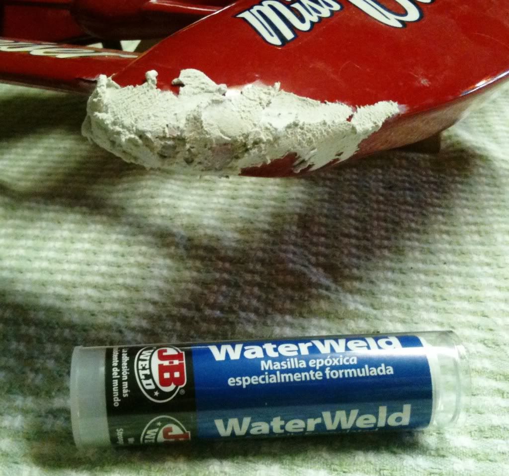

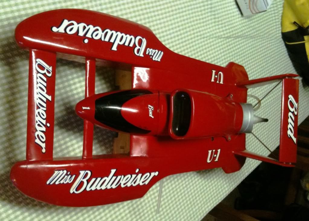

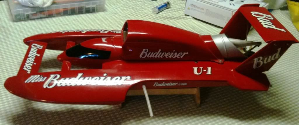

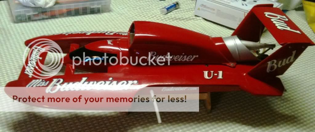

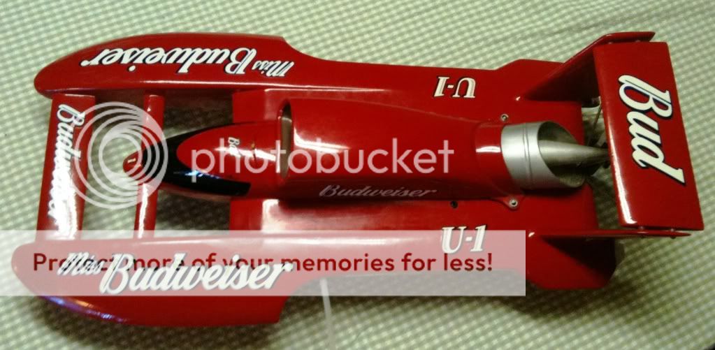

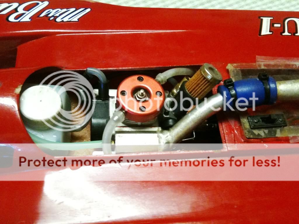

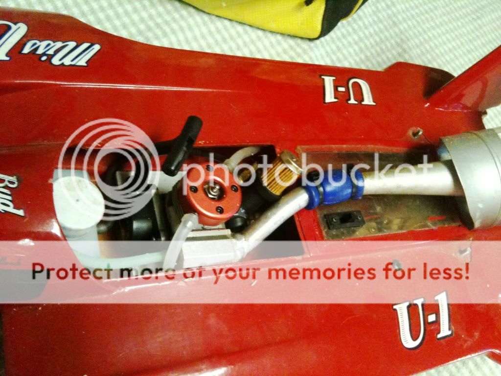

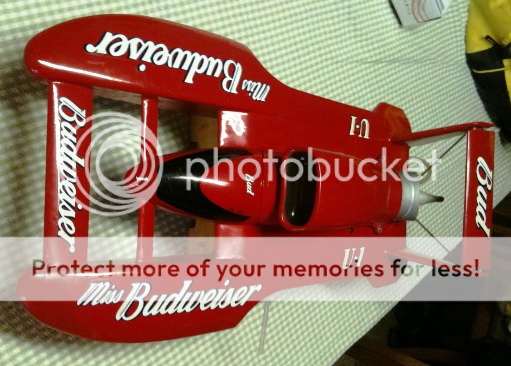

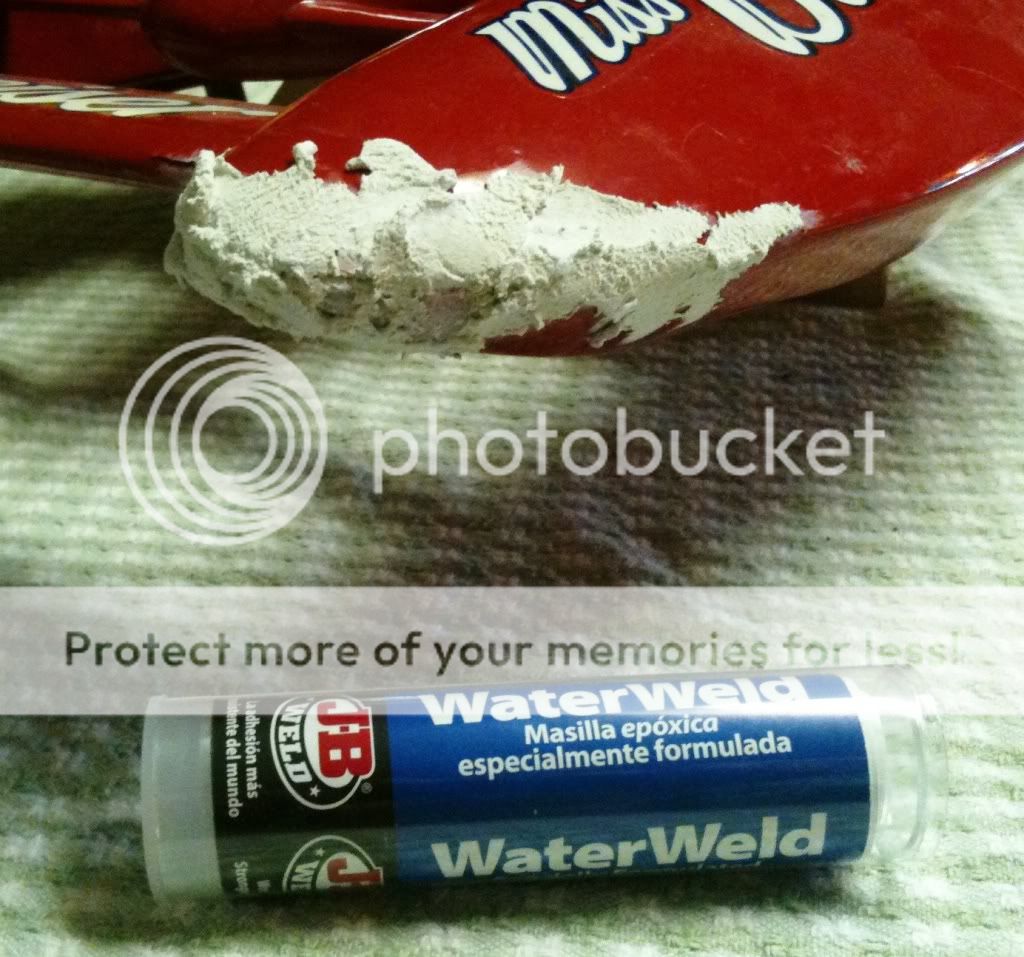

    OK, so I finally got off my butt and got the Miss Budweiser all repaired and water-ready! I found this really cool two part /epoxy/putty made specifically for marine repair applications on fiberglass and plastic (perfect!). It's JB Weld's Water Weld. It was only a few bucks at Walmart, and I have to say, it works GREAT!! You knead it together and apply to the areas to be filled/repaired and it sets up in 15-25 minutes and becomes sand-able in about an hour. Much easier to sand than fiberglass cloth/resin by the way ;) Anyway, here are a few pics...
    [​IMG][​IMG][​IMG][​IMG][​IMG][​IMG]
  19. Golden Child
    So after doing the repairs and getting all the radio gear setup, you know I just had to go down to the river and try her out! I had picked up some nitro fuel and a nitro starter kit a while back in anticipation of this day so I was all set.
    THIS LITTLE GEM IS A REAL SCREAMER!!!! Super fast and handles like it's on rails! I did have a few moments of hesitation as the prop is so aggressive that is cavitates almost immediately. It took a lot of finesse to get it up to speed without the prop loosing it's bite in the water. Once I got that down though, it was pure adrenaline-fueled fun!
