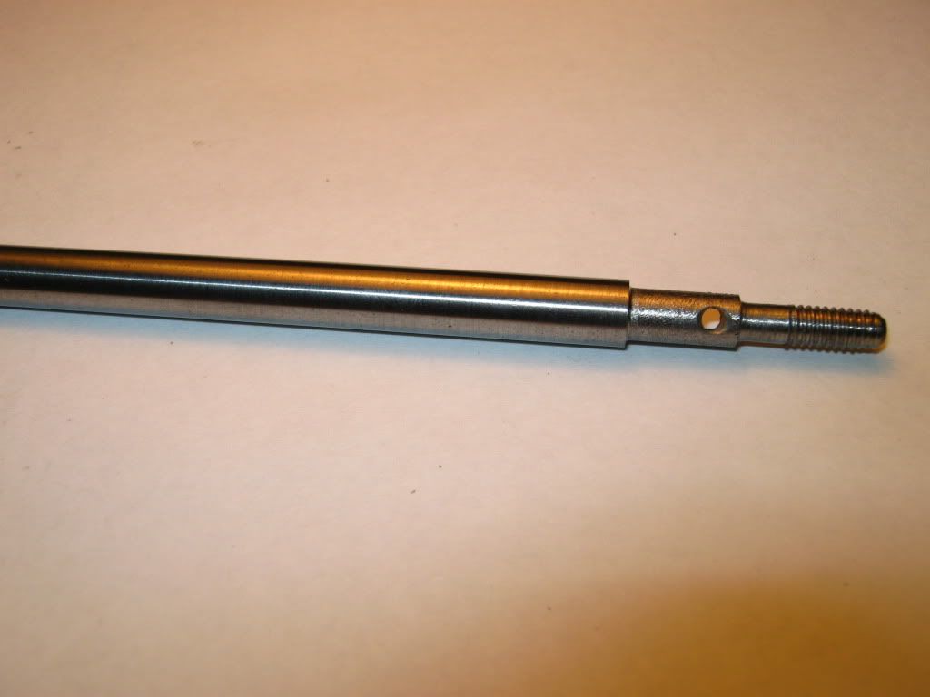

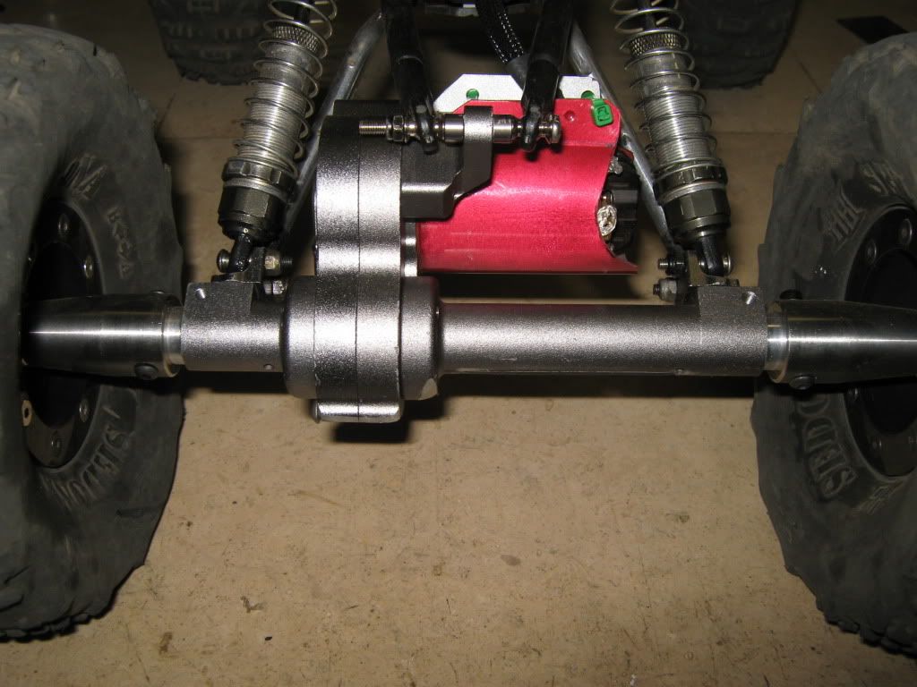

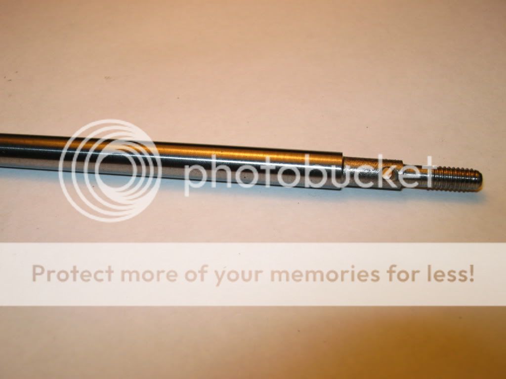

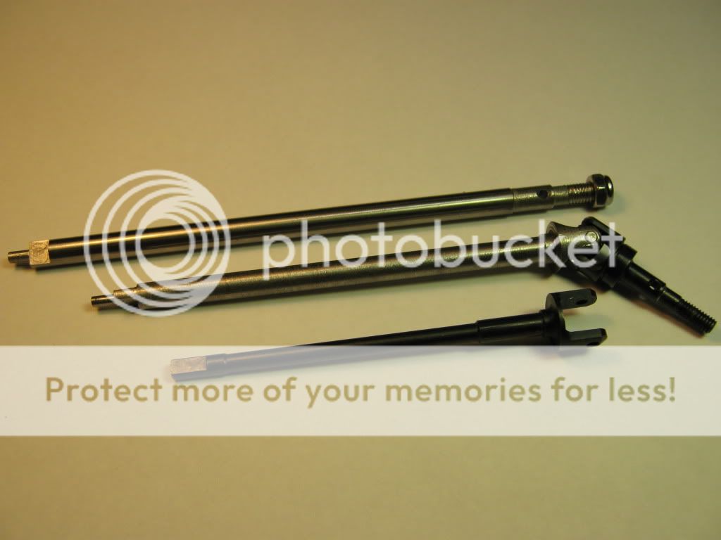

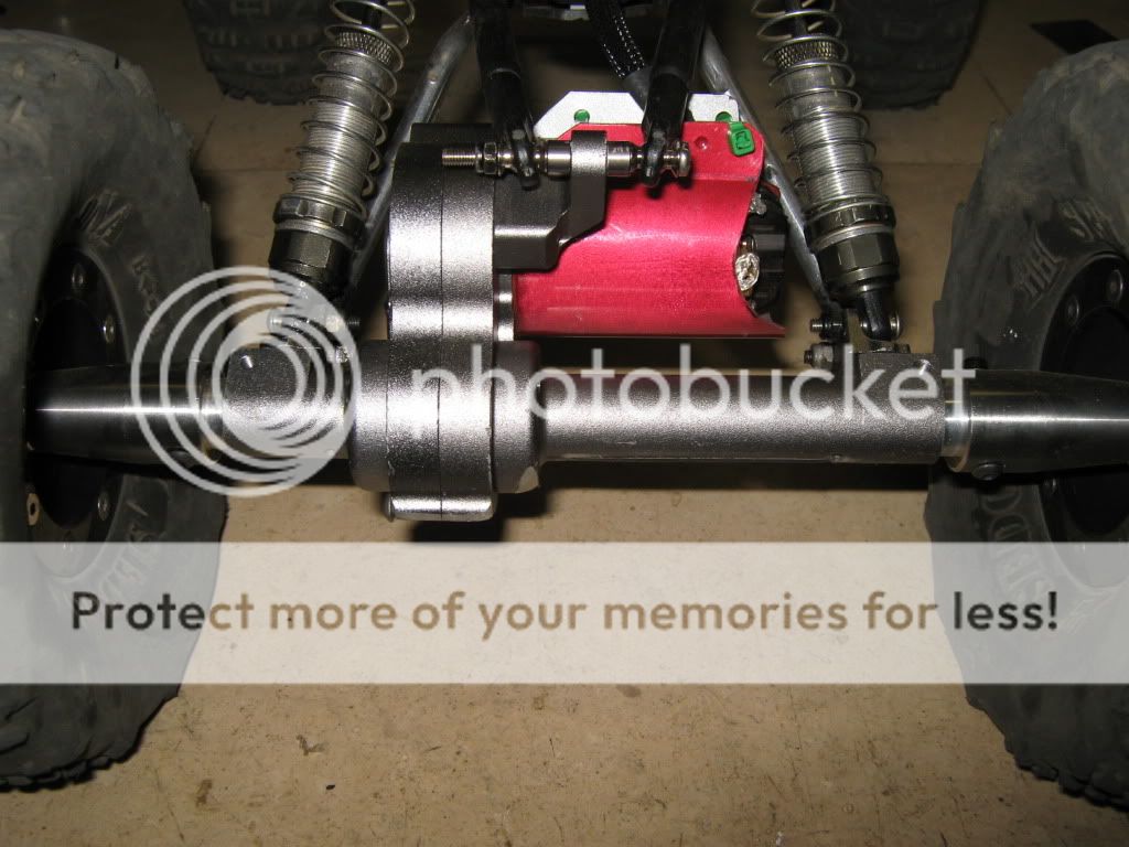

    Got my new rear axles made today. They are 4130 chromoly with a 6mm bearing. These should hold up against bending or snapping.
  4. GPS
    Chromoly!  Wow, very cool.  Did you fabricate them yourself?

    Thanks. I did make them myself. I am going to be offering them for a lot of different applications very soon. I'm working on getting some axial lockers out to customers then on to the axles.

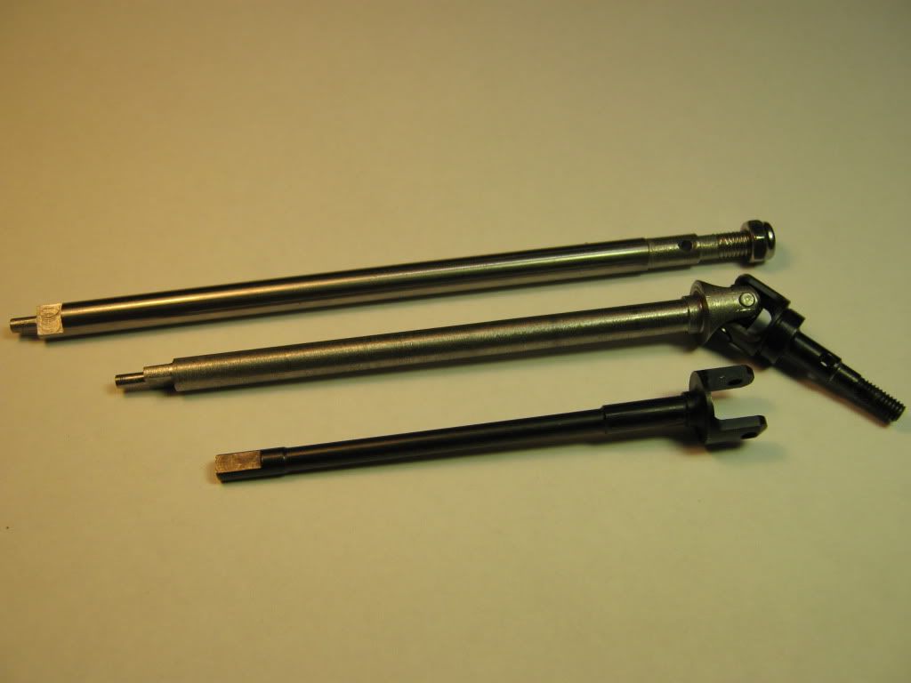

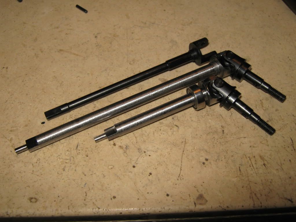

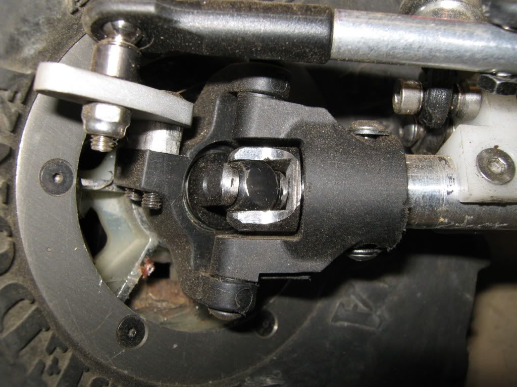

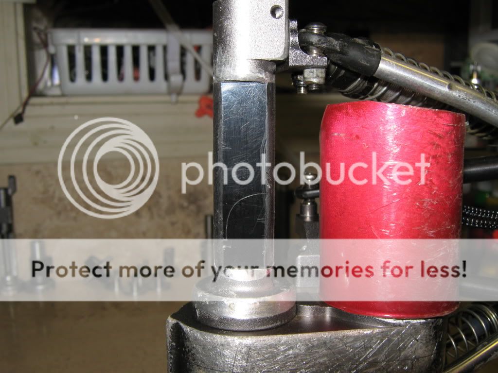

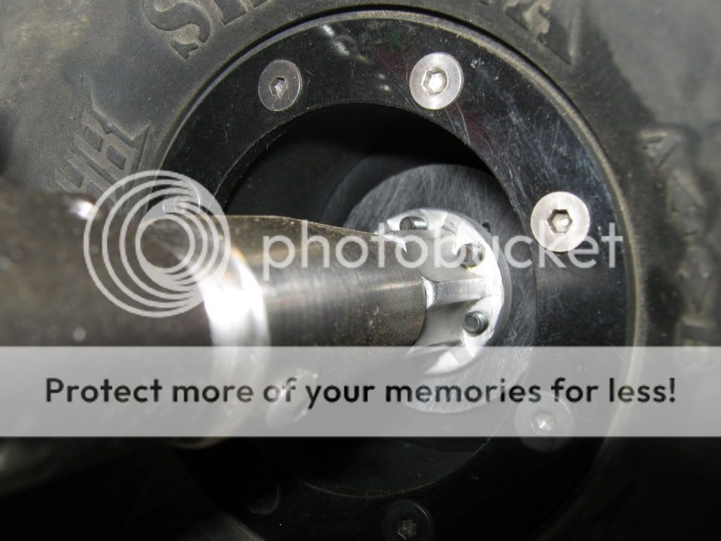

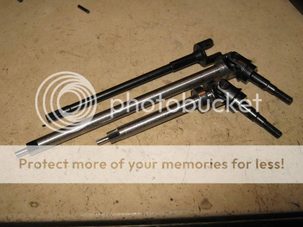

    Finally got my front axles done today ;D. These should be the last piece of the truck I need to finish it off now. I have new frame plates cut and gonna try to cram it all together tonight
    These are a front universal stub from an xr10 axle pressed back onto my custom inner axles. Now I have xr10 axles  with the berg tang on the end and 6mm. I will also be selling the 6mm inner for xr10 owners also
  7. GPS
    Those are seriously beefy.  Were the original axles 3 or 4 mm?  What was the reason to make them 6 mm?  Have you broken them before?
  8. highlandcrawler
    highlandcrawler Registered
    394
    The stock XR inner is 5mm at the bearing and 4mm along the shaft. These are 6mm all the way down. These particular ones are special because they have the berg end on the inside and xr10 outters so I can run the XR knuckles and c's on my berg. I have seen a few failures of the stock axles on the xr10 so I figured since I did the hard part here already it would be easy to make some bulletproof axles for the Xr also. My main goal there will be to eliminate all that slop the stockers have and beef up the shaft to fight twisting.

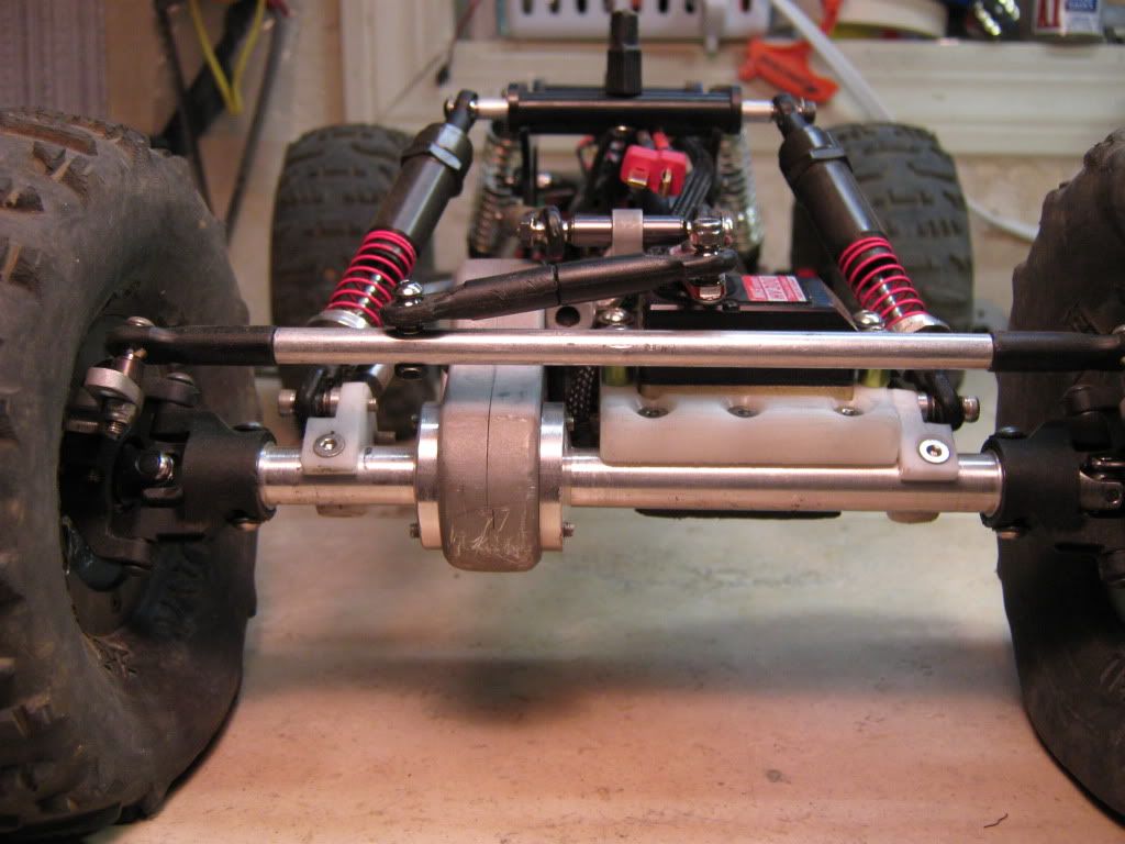

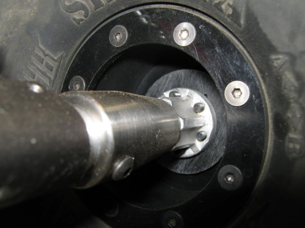

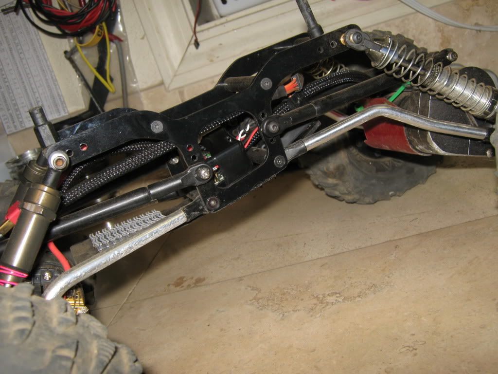

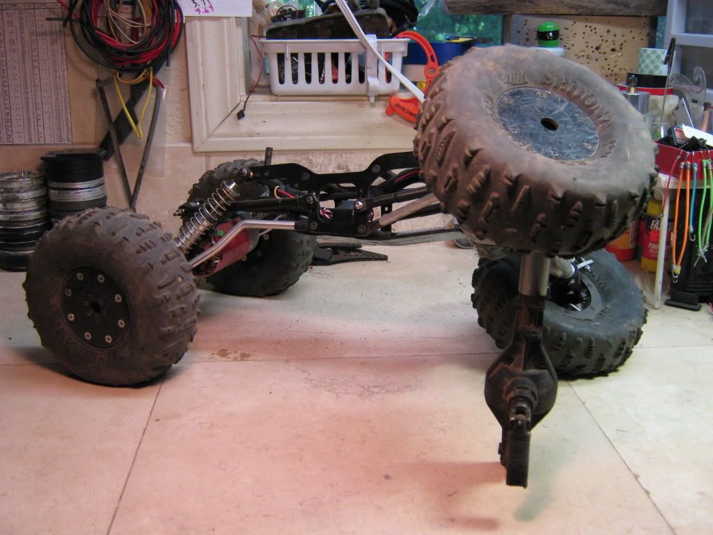

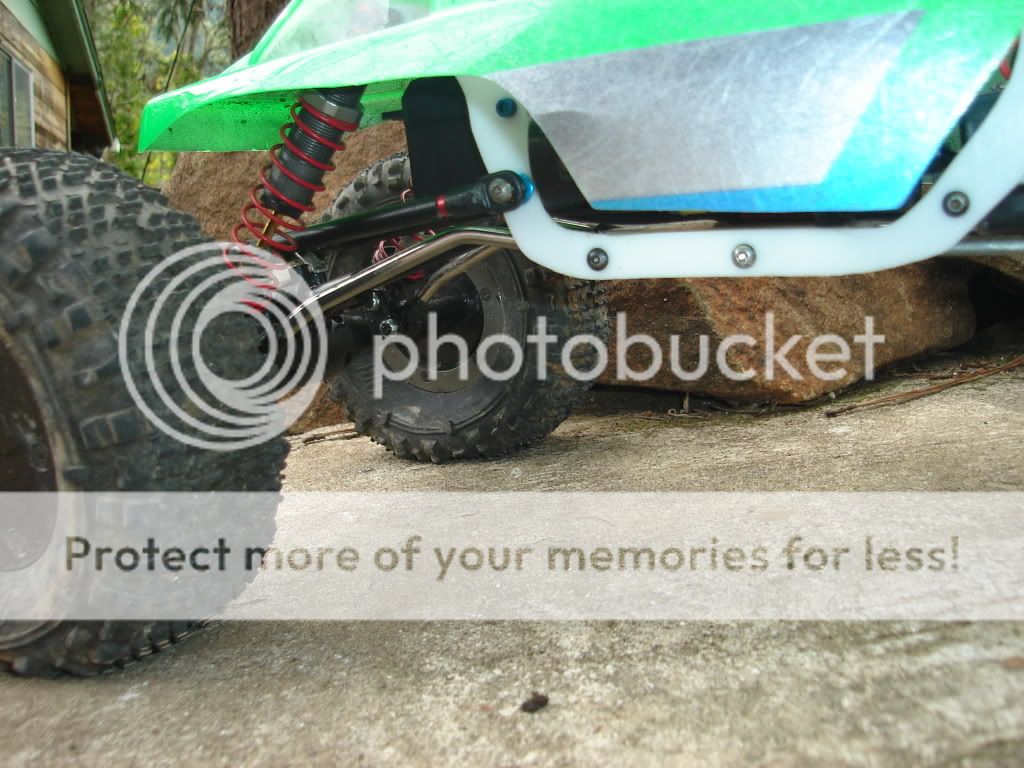

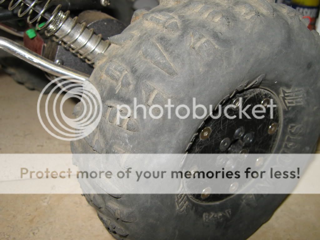

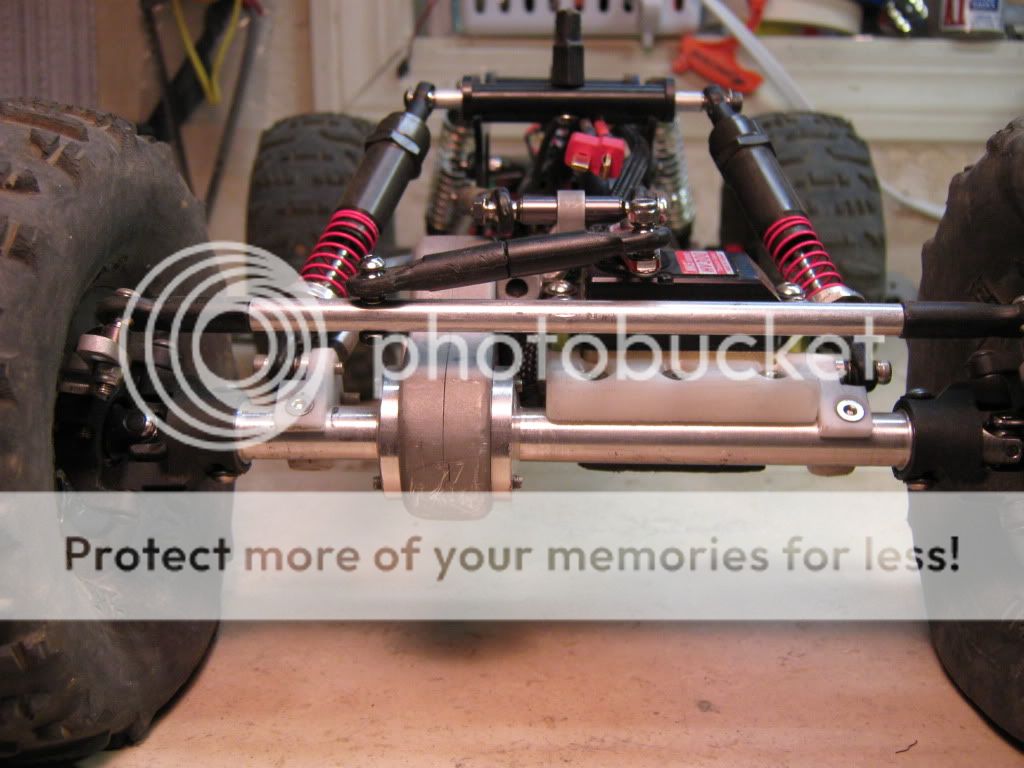

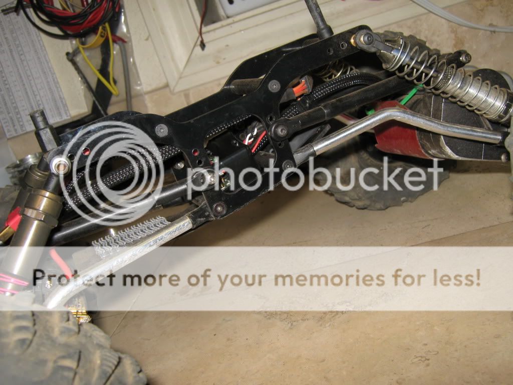

    Well I finally got it all done and together. I still have a little minor tuning to do and make a few small things for it but she is a runner now. Even needing some link tweeking still it far outperforms what I had hoped for it. I think it will be ready for the upcoming season and allow me to have a good shot at getting the my championship title back.
  12. GPS

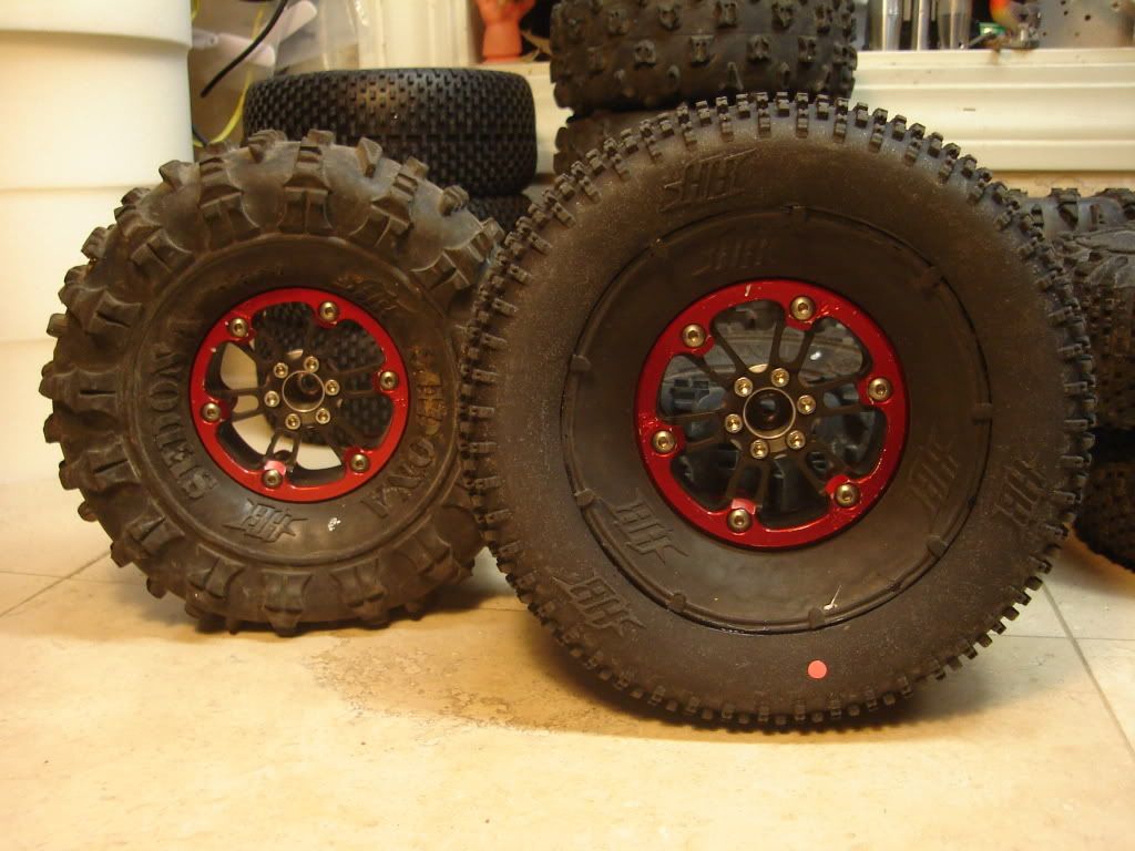

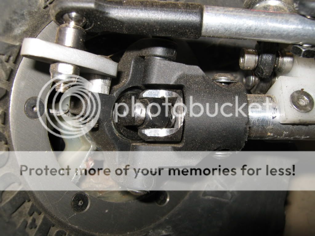

    Am I seeing that right?  It looks like you have some serious turning angle.  It almost looks like the universal joints couldn't turn at that angle.  You've also got some crazy articulation going on there.
    What wheels are those?  It looks like Vanquish Products center hubs but I don't recognize the wheels.

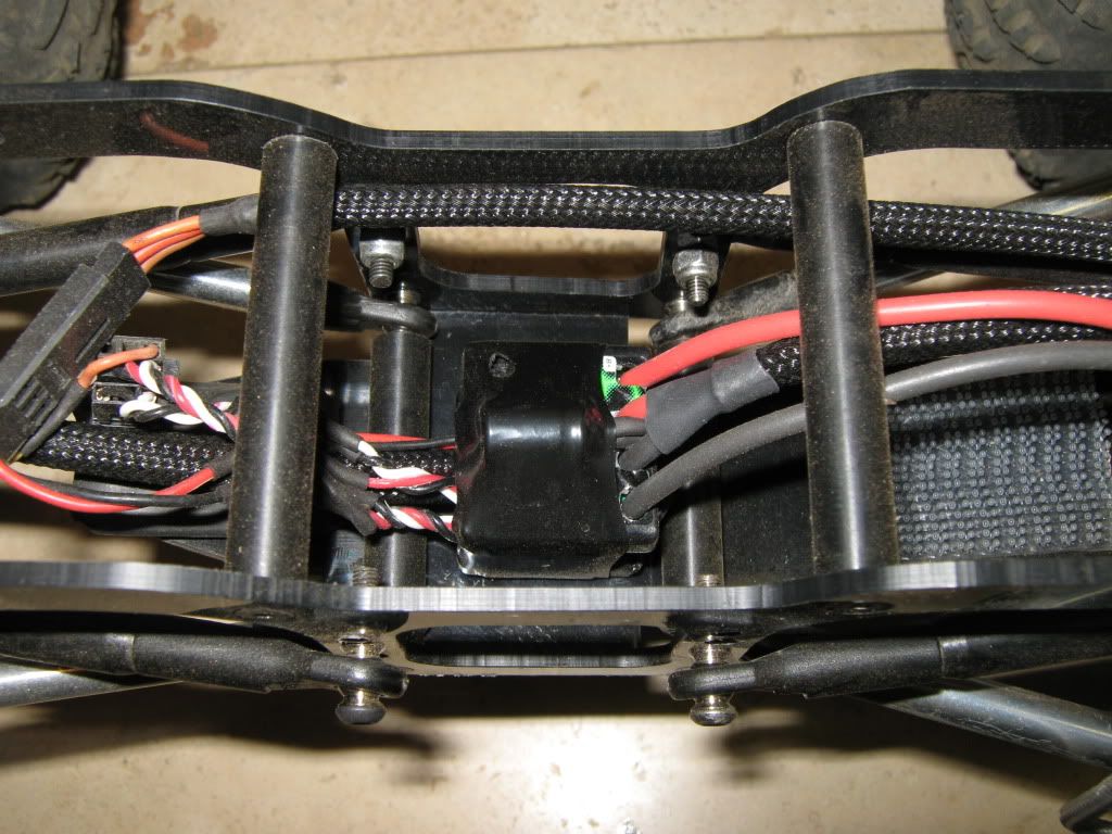

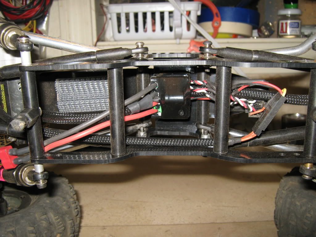

    Where does the battery go?  Do you have a body for it?

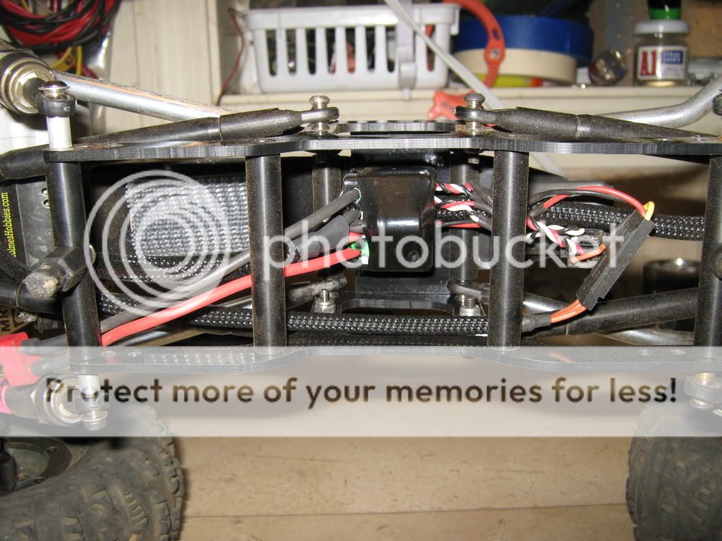

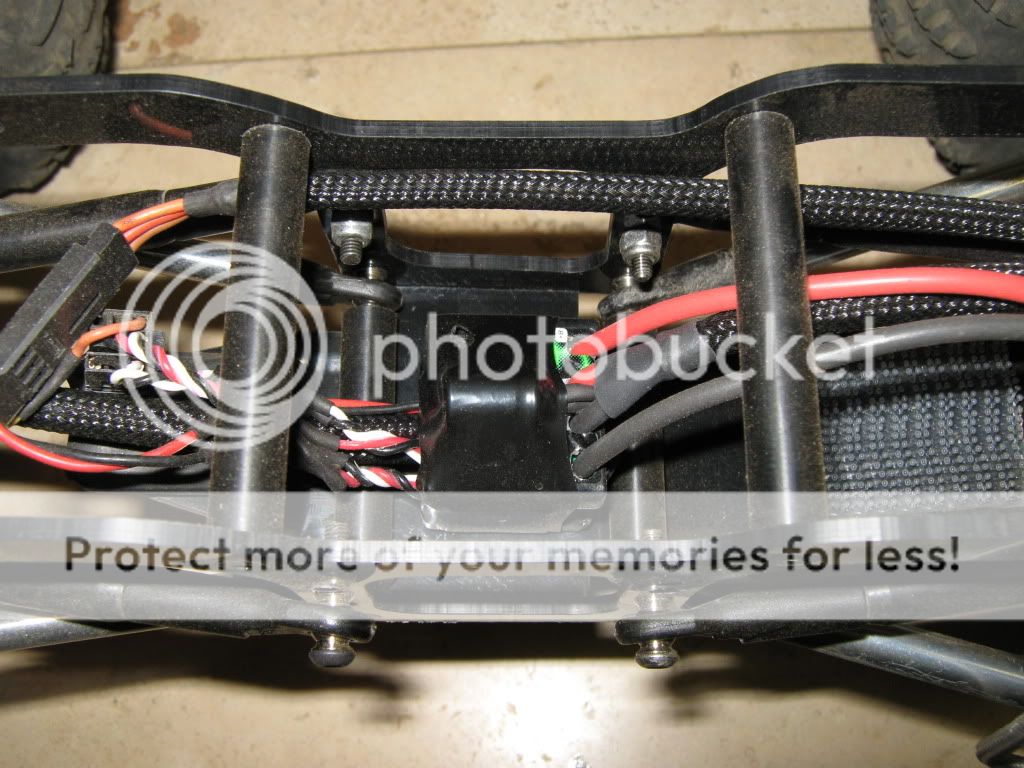

    I also wanted to ask where you got your wire shrouding and heat shrink.  I have been getting mine from Perfect Regulators (http://perfectregulators.com/), but I find it a little expensive for the lengths they sell and the amount I have needed.

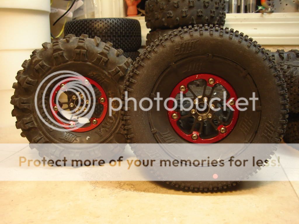

    Nope you are seeing right it turns like mad lol. In one of the pics above you can see where the black universal piece was clearanced for a little more turning angle with the new inner. It has a pretty good amount more possible but I just cant use it all. I would be into the links and shocks to hard with the tires. The flex looks deceiving in that pic above it just clears a tire and not a lot more. Still more than I usually run though. The fronts wheels are losi and the rears are some I make.  I made  a solid comp face for both of  them and the rears work with vanquish hubs. The odd disk you see is just a spacer . I was trying a 1/4 wider track width in the back. I get all my shrink from a buddy that runs a battery store.
    http://www.cheapbatterypacks.com/Products-Listing/65-Shrink-wrap.aspx
    Chris is a great guy to deal with and shipping is in the 1-2 day area .

    You didn't mention where you get your expanding nylon braid servo wire protection.

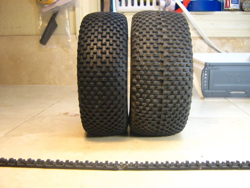

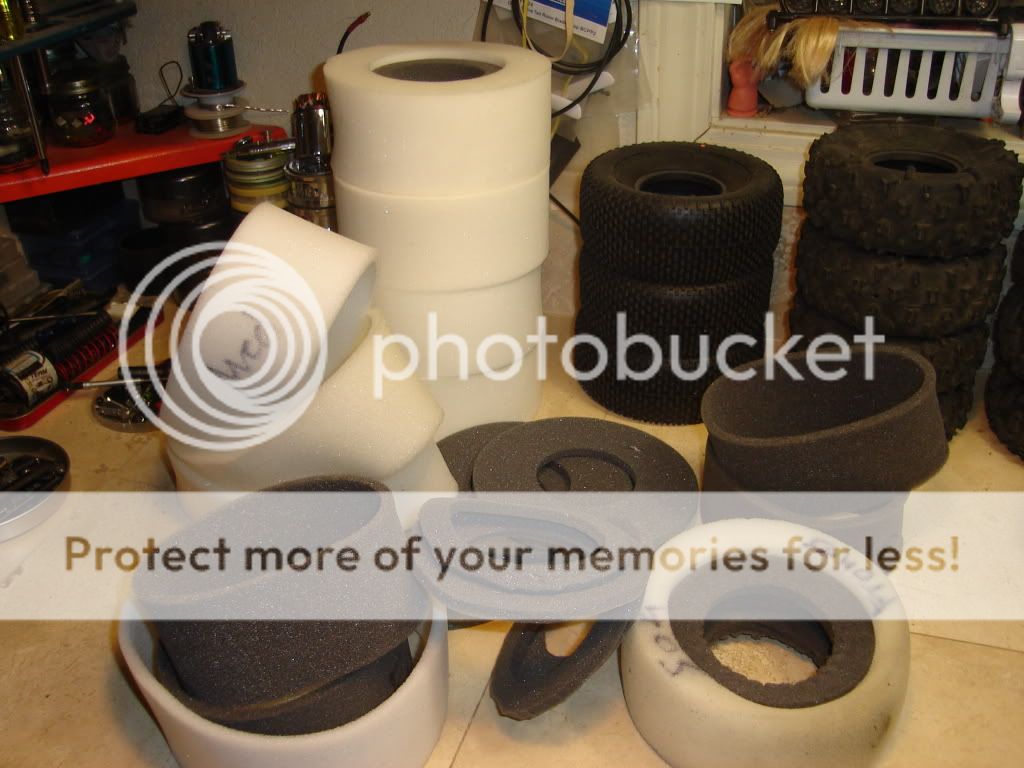

    Thats odd there is a whole paragraph missing from my previous post? Anyway the loom comes from mcmaster. I usually order about 100 ft in a couple different sizes once a year or so. I love that stuff and use it on most all my stuff and some customers cars also. And ya Chris has shrink you could put over your head :eek: huge stuff. Some of the best batterys you can get for a crawler also. They are good people and are very active in the crawling world. Ive been putting in about an hour or so a day for practice since I got it done. We run and comp them rain or shine. I do need to get some different tires on for the wet slick rock before the season opener in Gold Hill. I will have my pins done soon and run those for our first couple comp spots.

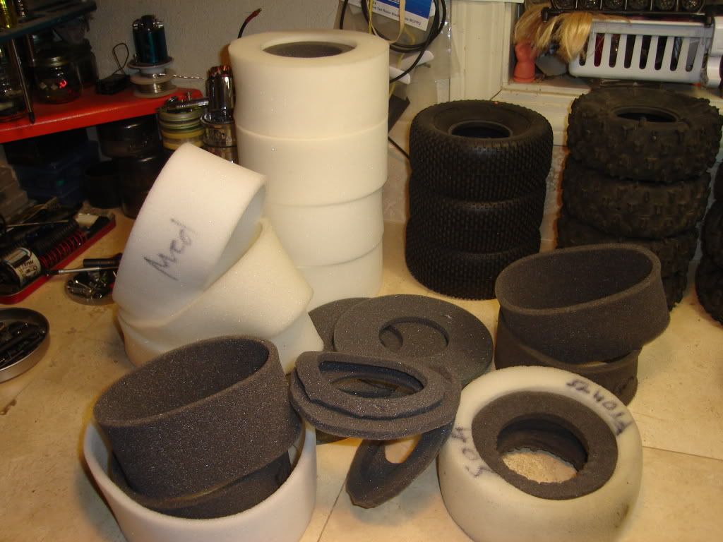

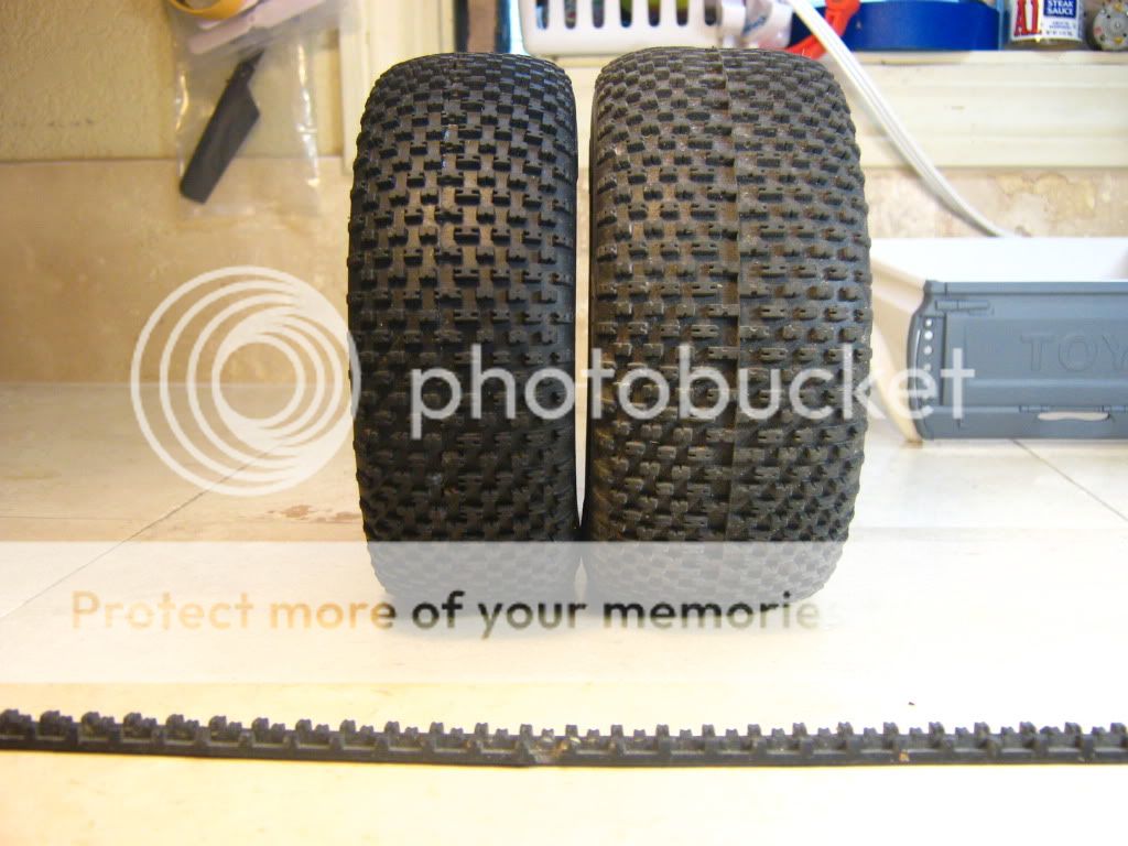

    I will be taking a pair of these that I already made and doing a lil narrowing on them. They are a Hotbodies khaoos truggy tire with a white dot rover sidewall. I am taking about a 1/4" out of the width now.
    And some foam tuning lol
  17. GPS
    You can cut tires and make them narrower and change the sidewall?  I assume that you have to use glue to do that, but does it really hold up?  I mean, you built 6 mm axles that can put out some serious torque so I would imagine that you would just shred glued together tires.
  18. highlandcrawler
    394
    ;D The tires always trip people out lol. It takes years of doing it and experimenting with different things to make it work. The ones I do now don't come apart anymore but I cant say they were all successful. When I did my first set probably 10 years ago for a pulling truck they flew apart like a retread on the highway. Now they hold solid and I have ripped the tire itself before the bond breaks. In all the sets Ive done for people they have had no failures to date. The narrowing of the carcas is way more tricky to pull off than modding a sidewall also. You have to cut perfect to make it work out right. That tire i pictured above takes about 2 hours to make per tire and costs about $100 a set so they are not for everyone but for those seeking the most performance possible they are worth it. The ones pictured below have the center of one tire and sidewalls of a different tire seamed at the edge of the pins. Uber hard to make

  20. highlandcrawler
    394
    If I make them for you or me no. But to make a customer pay over $100 for a set they gotta be spot on. I hate the glue for the most part. After a few hours with your face over the fumes you get a haze over your eyes and they start wanting to glue closed ;D
