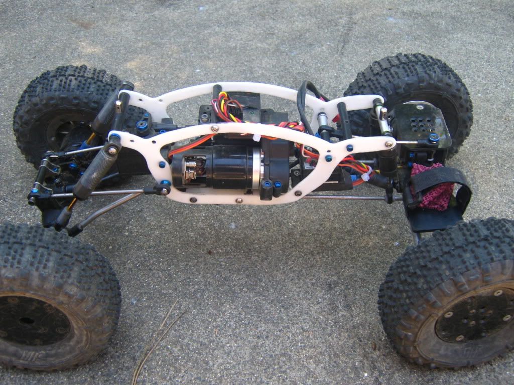

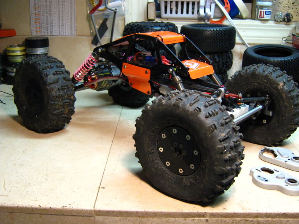

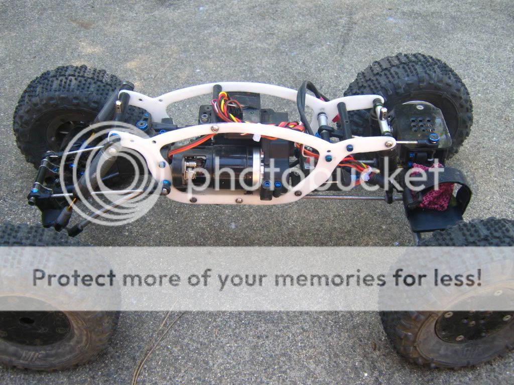

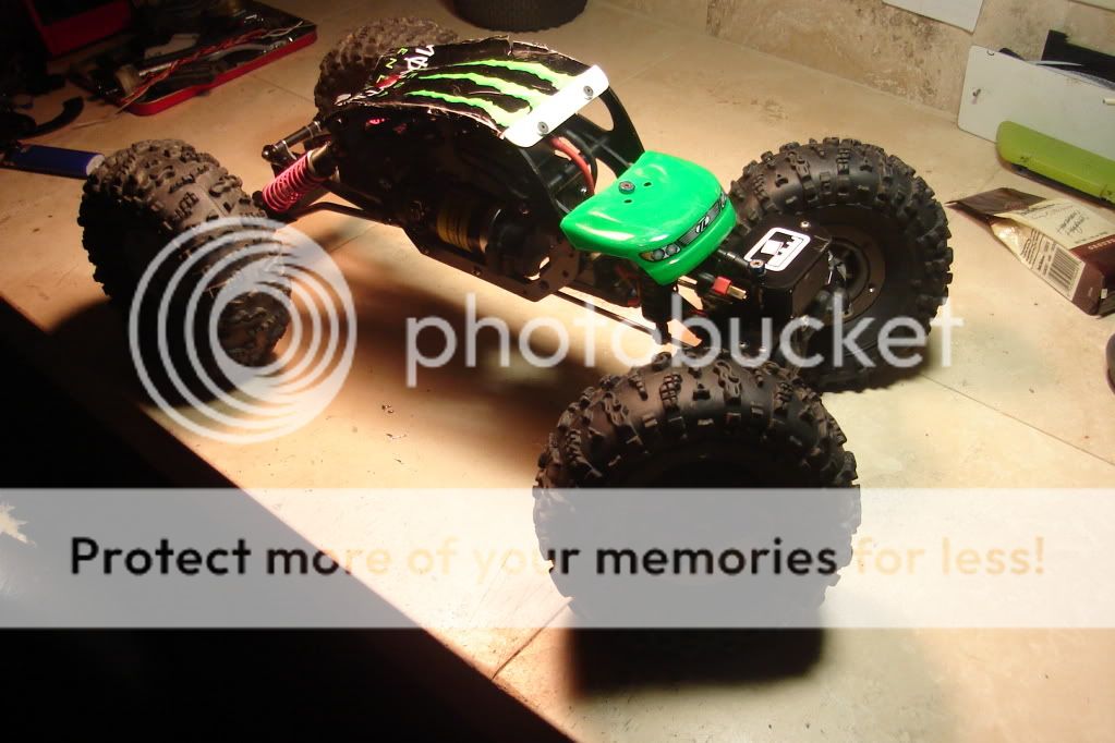

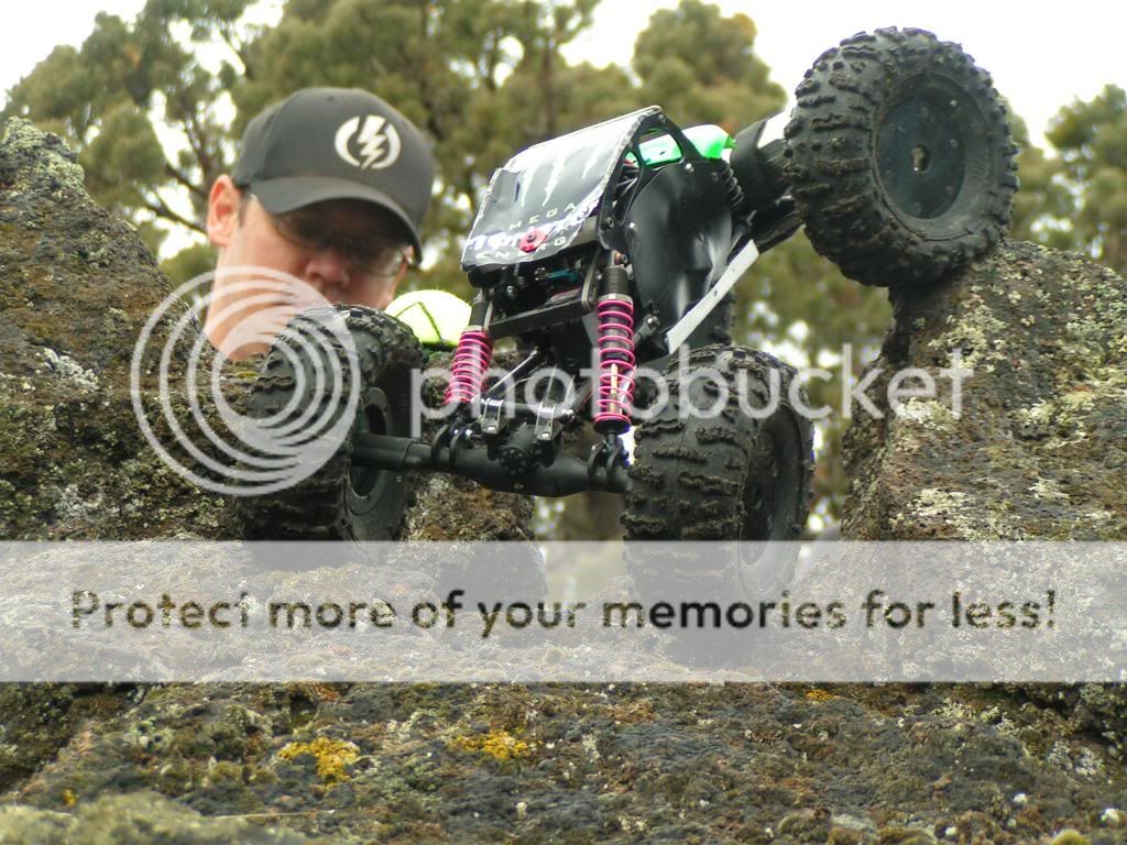

    Here are some pics of my new truck for the 2011-2012 comp season. Its still being modded and things changed around but she is getting close to being done. In her shakedown run right off the bench I was able to pull a second place finish for the day only 1 point off of a tie for first. I will post up specs also if anyone is interested.
    Is that a axial xr10?
  3. highlandcrawler

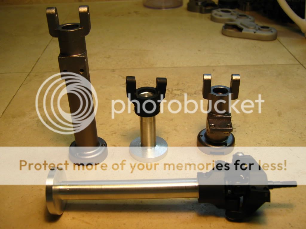

    Oh no, no xr10 for me. I am running shaved and modded berg housings. We do have another club member running a set of xr axles on close to the same platform though and he does pretty good with it. I made some custom axles and tubes for the front though so I can run the xr outters and universals on it. I just havent got around to putting them on ::).
    Mine are the silver ones
    Do you have a machine shop, or a lathe?

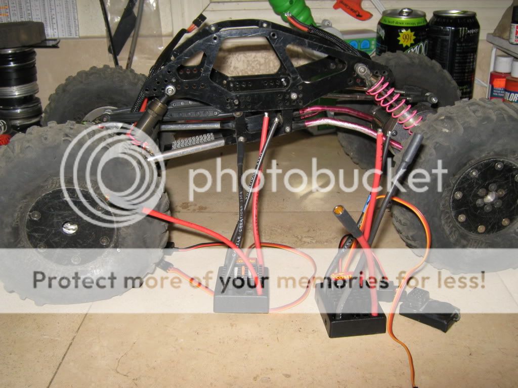

    The ups guy brought me some more goodies for it today. My 2 speedos finally got here and I cant wait to get them in.
  6. highlandcrawler
    I do have a lathe here at home . One of my good buddies owns a nice machine shop and he lets me play when I need to. I do have him run all my production parts for me on his automated machines though to ensure top quality

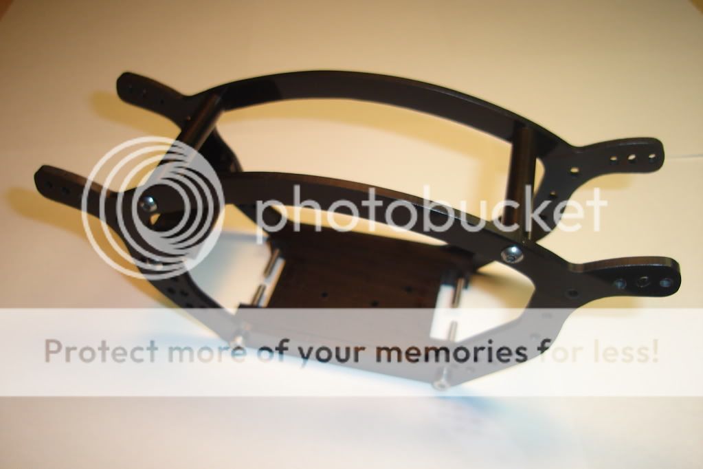

    Are those frames made by you or your friend?  Those axles look custom also.

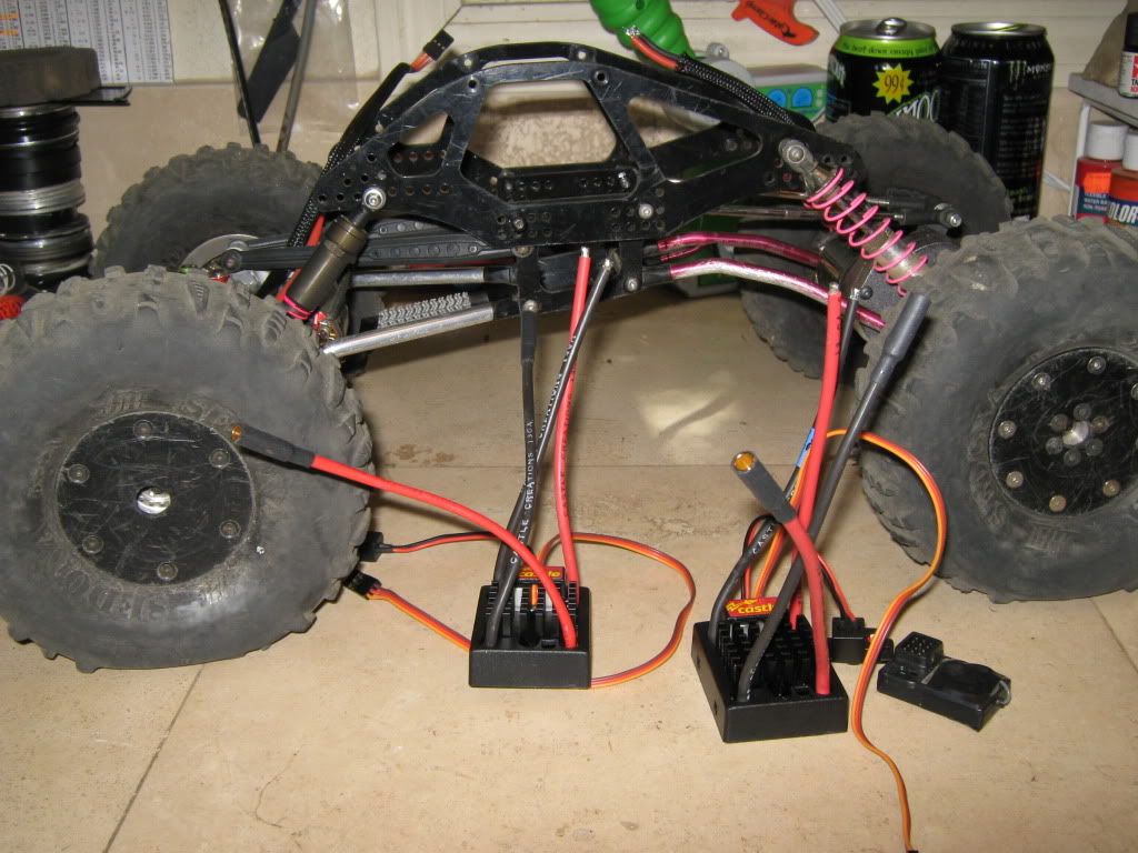

    Those look like Castle Creations parts, but which?
  8. highlandcrawler

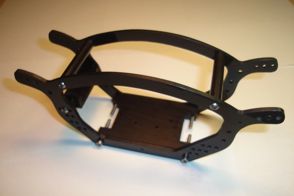

    The chassis design is a T1e forward bias with some tweeks. They make a very nice chassis but I wanted a little more out of them. I custom made these ones for me and a buddy here at home. Mine are thinner, lighter, stronger, and have a little bit better link geometry 8). Im gonna cut some out of carbon fiber here soon for my team drivers, and those should be amazingly light weigh. I'm shooting for less than 2oz for the complete frame and skid. The axles have a ton of work into them. I have ran them through the mill to remove some unwanted material and given the whole case a smoothing out. Then i tossed them into the blast cabinet for a nice finish. The escs are actually the castle sc controllers. They are basically the same as a sidewinder and should work good for me. I plan to decase them and solder the 2 of them together in 1 tiny package.

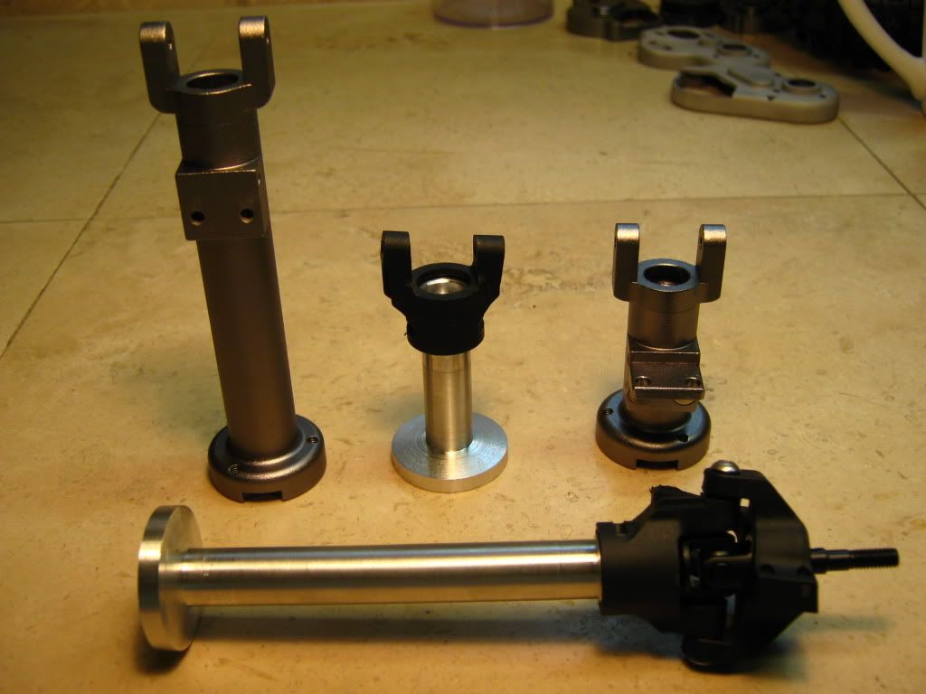

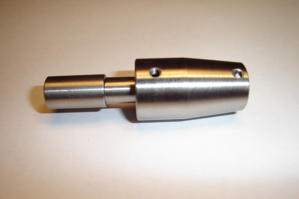

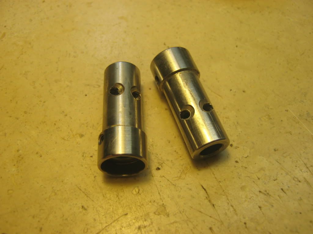

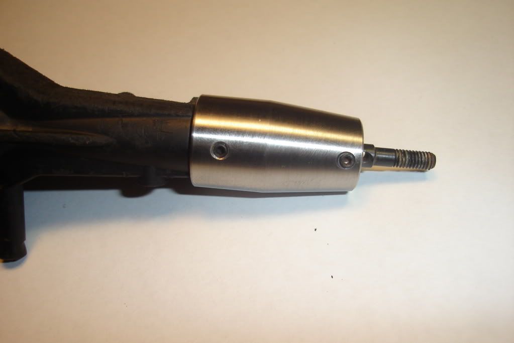

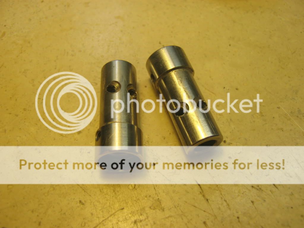

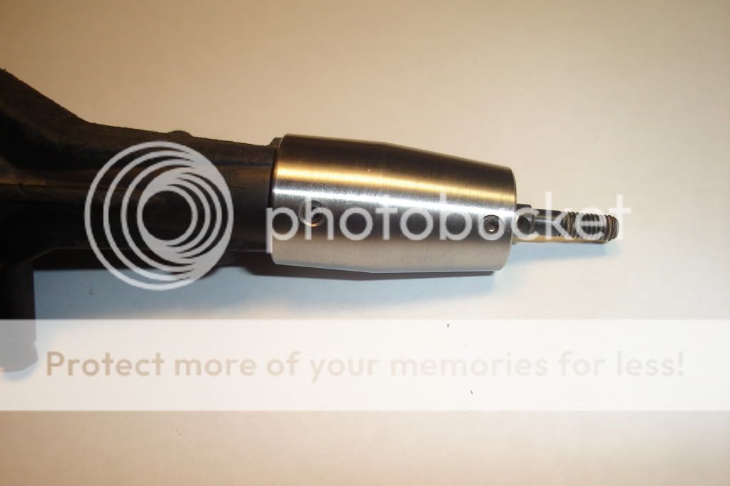

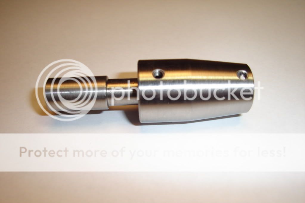

    Are the third and forth pictures for Axial axles?
    Where do you sell your parts?
  12. highlandcrawler
    I am a vendor on ORCRC and do most of my selling by word of mouth. i am going to start selling on RCC here shortly also. The pieces you asked about are the long barrel lock out for the Axial axles. They serve a lot of purposes but most notably they keep the ends of the housing from snapping off on heavy trucks or during hard driving. I make a insert tube for the front axle that has adjustable caster. Here is a little video when we were still testing them

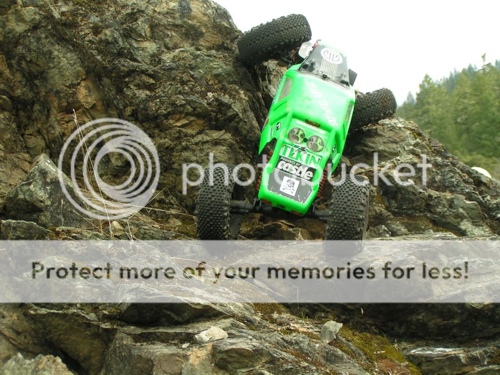

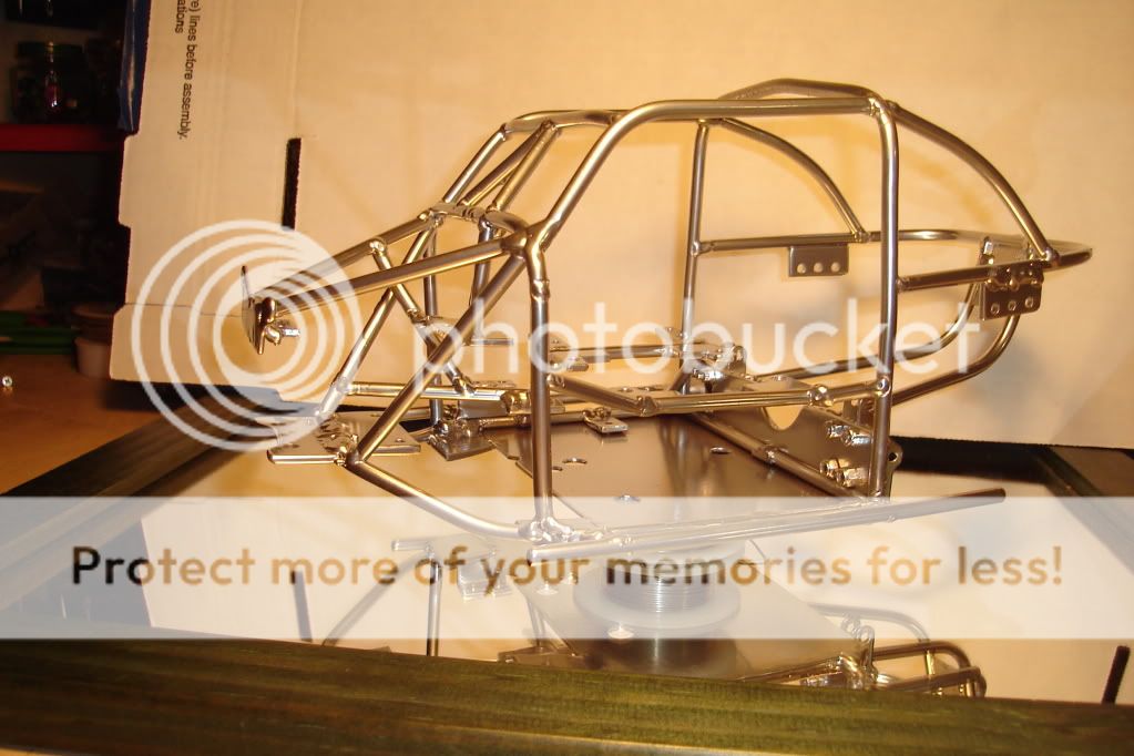

    Ya know for pillow crawling and terrorizing the house that is a great combo. It sounds like you have some decent parts there but may have skipped the most important mod ... a frame. From your leg hiking torque twisting description it sounds like the stock frame or similar link geometry is being used. If you don't plan on competing with it there are a lot of little things you can do with the stock frame to make it drive really good and cost very little. The losi axles are pretty sweet. I ran a pair for the last couple seasons in the pr class against moa trucks and managed quite a few wins with them. All in all that was the nicest handling neutral truck I've ever built or driven. I miss that one a little bit.

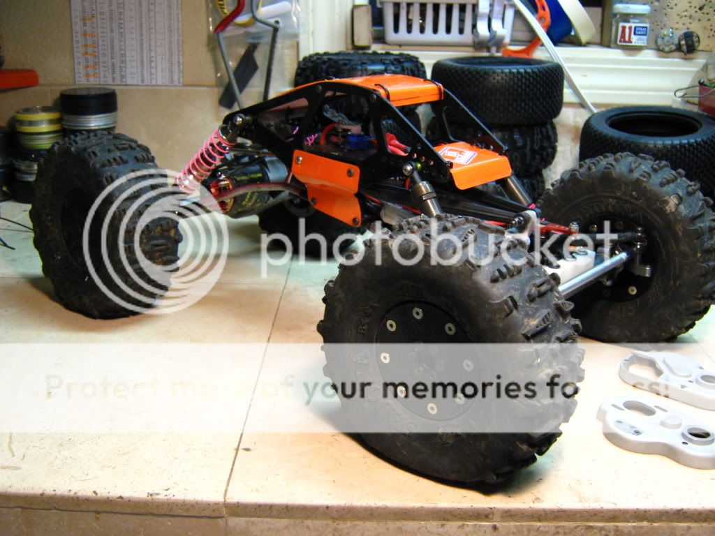

    Here are a couple pics of that one.
  20. highlandcrawler

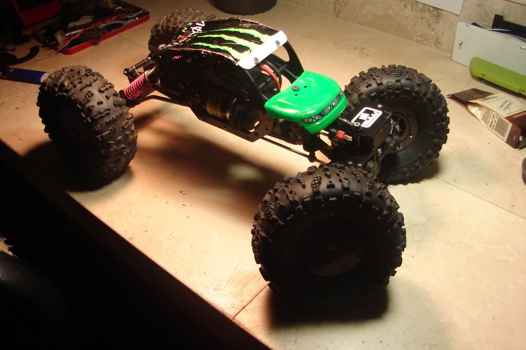

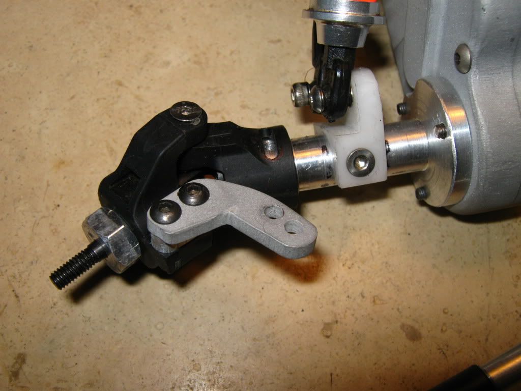

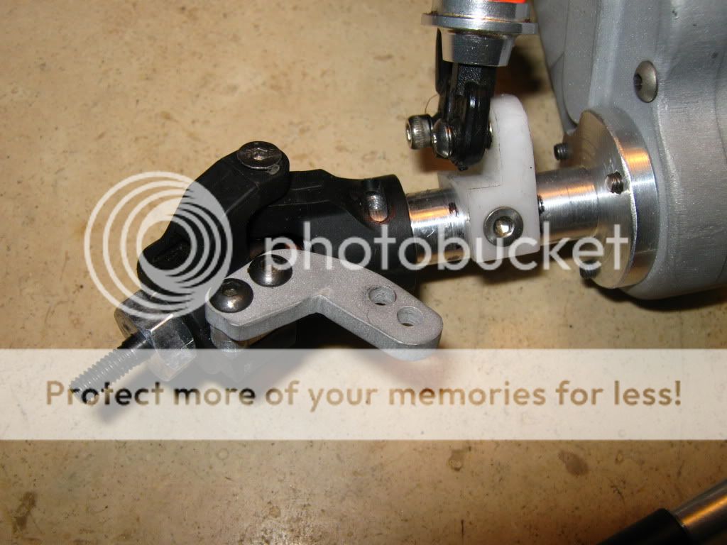

    On another note I finally got my new front end into a rolling working form. I still have a few things to figure out and clean up but its general layout will be unchanged. It uses a berg center gearbox with custom axle tubes. On the end is axial XR10 knuckles and c's. The inners are going to be the last piece of the puzzle. I just got some 1/2" 4340 in today and will use that to make some new inners. I'm gonna try to press the axial universal apart and make a new inner axle portion the proper length with the berg tang on one end and the other end mate back to the Axial piece. The modded uni should be able to run smooth out past 60deg also :eek:
    Here is the arms I made to make it all work. They are still being ground on and tuned in but the final will be very similar also.
