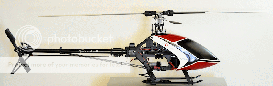

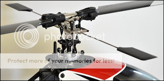

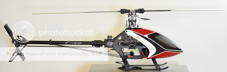

    Hey everyone, today I was in the mood to do some photography so I decided to do some
    new photo's for my MSH PRÔTOS and the "Photo" Gallery... First up are the photo's then
    tomorrow I will include a list of ALL the giblets, what's all inside this turkey
    Thanks fur looking
        [shadow=orange,left]w00d[/shadow]
    [size=1.25em]MSHeli PRÔTOS 500[/size]

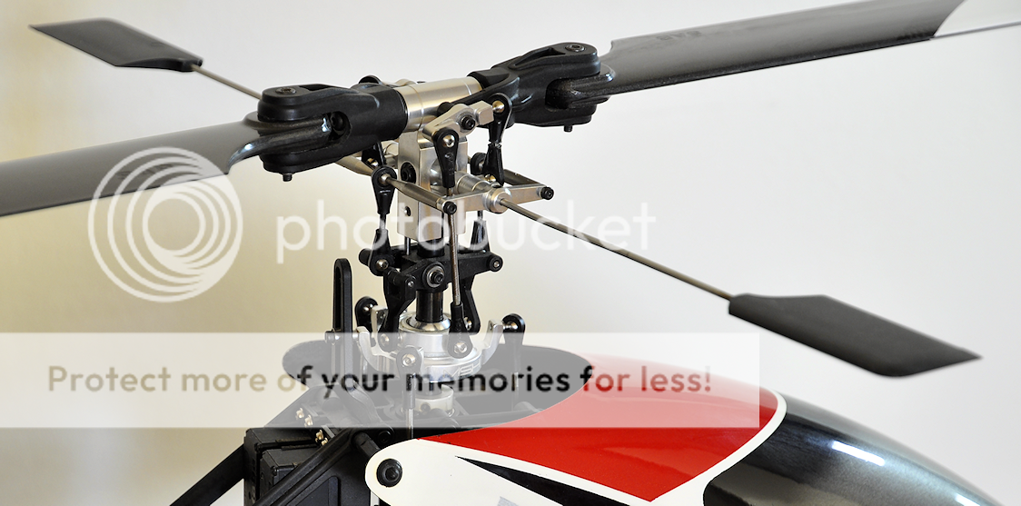

          [size=8pt]Click Click Larger - LOW Resolution - HIGH Resolution[/size], (CRAP, canopy came out crap need to redo this photo!)
          [size=0.7em]LOW Resolution - HIGH Resolution[/size], ( and Double CRAP, canopy came out crap need to redo this photo!)
          [size=0.7em]Click Click Larger[/size]

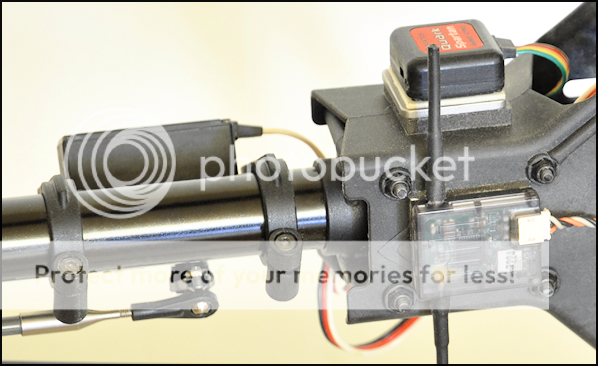

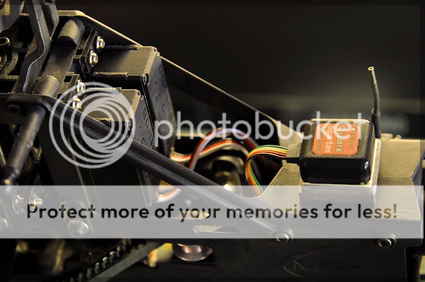

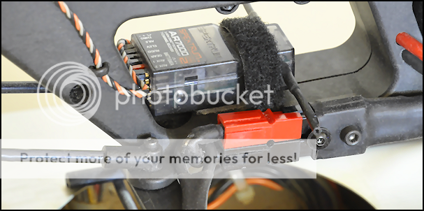

          Spartan QUARK Gyro w/ Futaba S9257 Servo
          Spektrum AR7000 Reciever

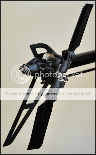

          Tail Rotor
    Following PICS are old photo's taken w/ my old camera, SONY DSC-H9 above photo's taken with the NIKON

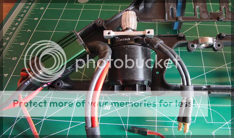

    Innards, Parts:

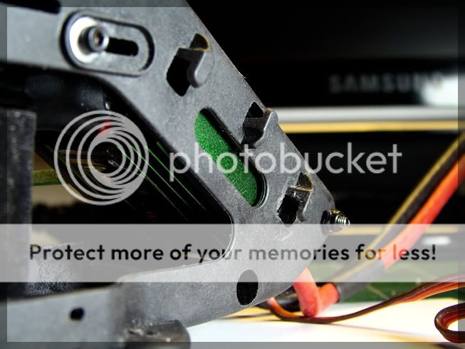

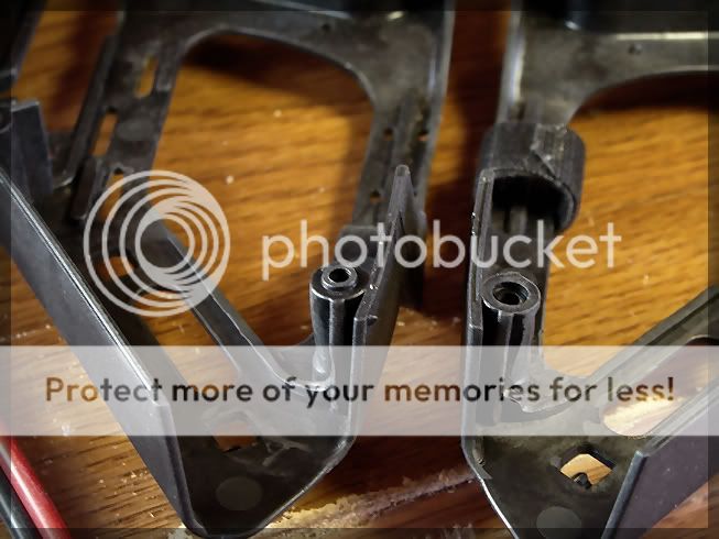

    Installing and hiding the Castle Creations ICE100. In order to install and FIT the 100amp ICE I
    needed to shave a little plastic off the inside of the two frame sides otherwise the frame will not close.
    This MOD is not needed if installing the ICE75 as this ESC fits inside the frame perfectly
    Servo's - 3 x Futaba s9250 and my dearly luved Spartan QUARK, probably ONE of the BEST Gyro's at the time and maybe still ... I own three!

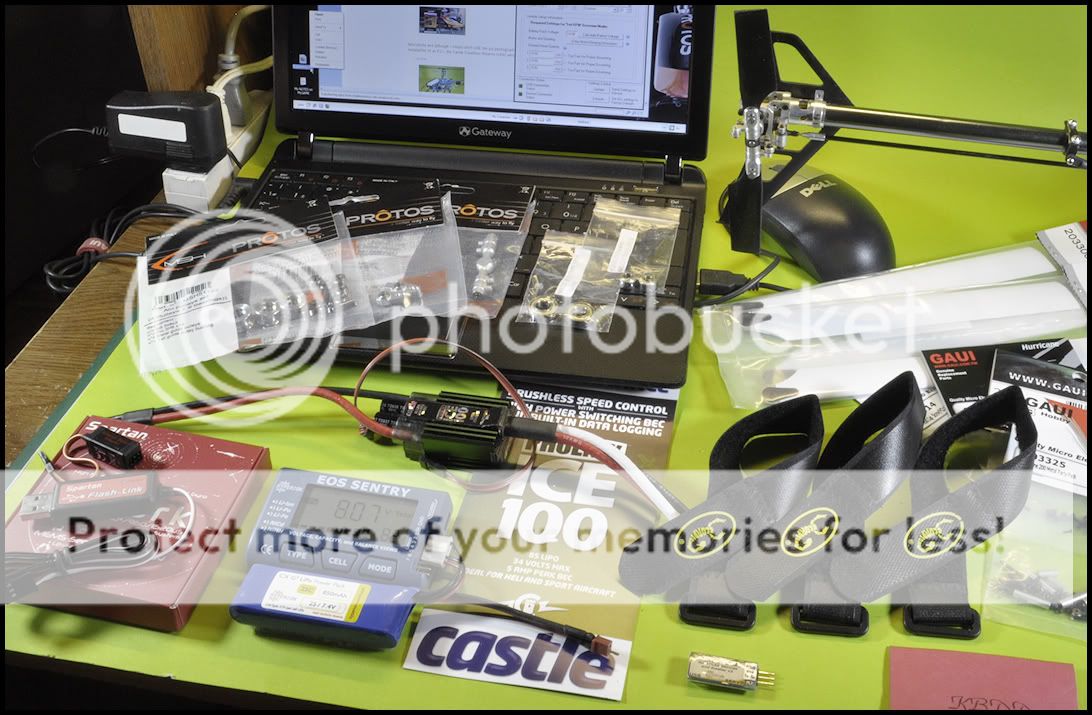

    Shopping for the PRÔTOS 500: CNC bling, the Castle Creations ICE100, Spartan FLASH Link, Hyperon EOS Battery Checker
    and the Digital Servo Programmer
