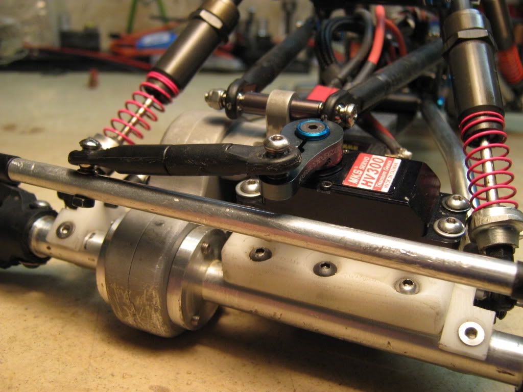

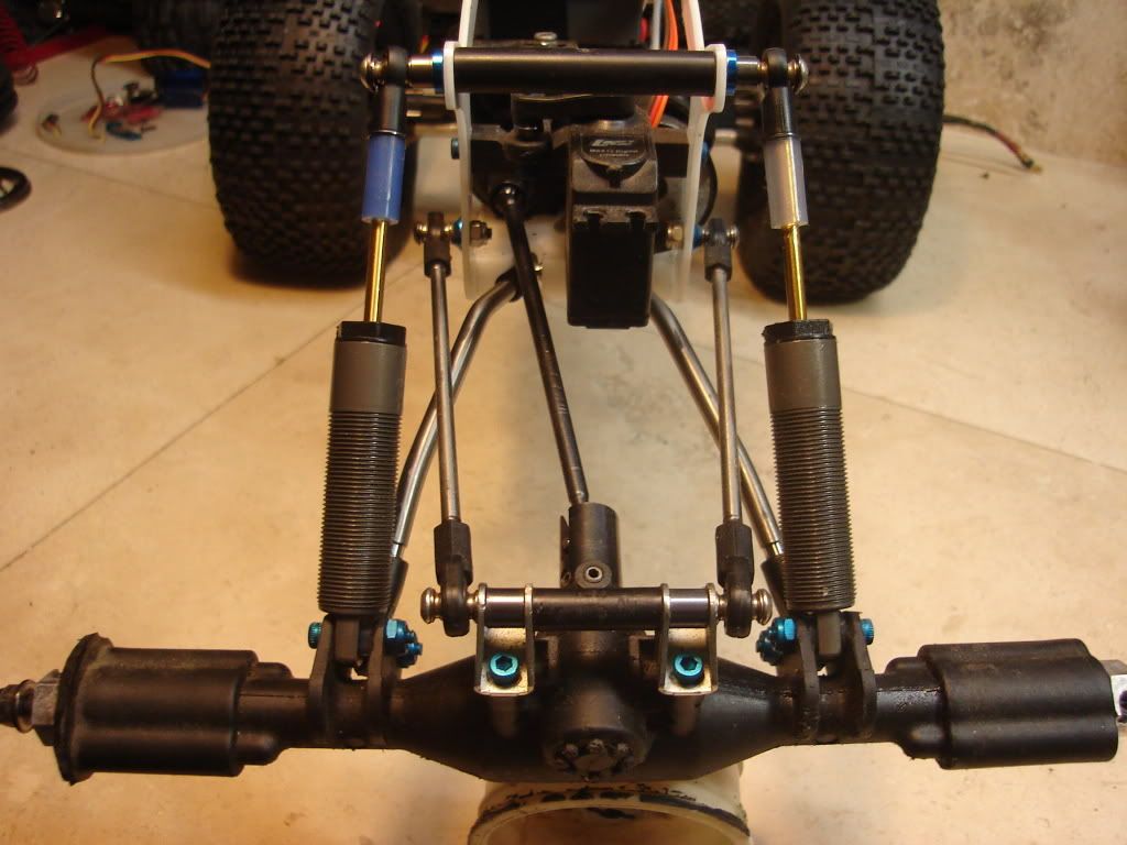

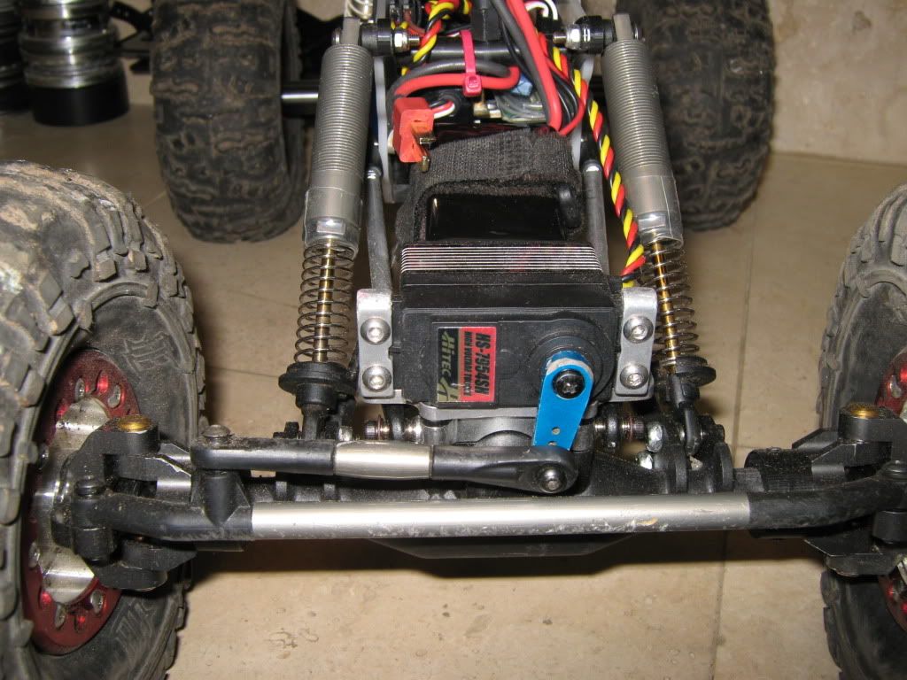

    I haven't used them personally but have seen and heard nothing but good things about them. I'm not a threaded body guy on a crawler personally. I usually chuck them in the lathe and turn the threads off. I do a little tuning and find the perfect spring and call it a day. A lot of times we are using so much steering that the tire will actually hit the adjuster and thread it up or down. I go for a smooth body and mini springs. On my fast stuff and sc trucks I do run threaded bodies though and enjoy the extra tuning ease. Hopefully some others will chime in on their preferences also.

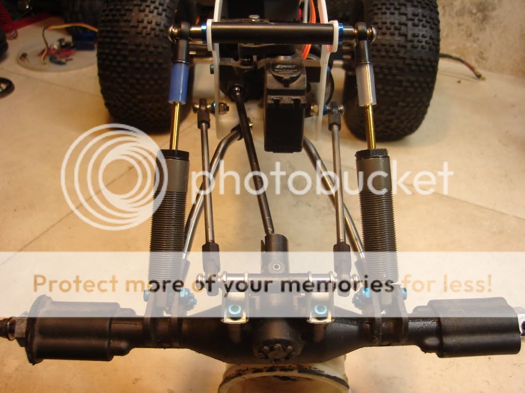

    What shock bodies are those in the first and fourth photos?  They do not have shock caps and seem to be solid metal up to the mounting hole.
    What springs are you using that have the smaller diameters for utilization on the shock end instead of around the body?
  18. highlandcrawler
    Photos 1, 2, and 4 are losi ccr shocks. They are very nice but into the $60+ range for a set. You have to do a little work to keep them from leaking or invert them. When you invert them you must emulsify them before you run by pumping your truck a few times up and down. That comes from them being a bottom filled shock and not having a bladder. I like a bladder shock for the reason you can invert them with no ill effects or silly tactics lol. The ones in the second pic have custom cartridges on them that clip the spring on that I made a while back. They held the spring tight and cured all leaking problems. I need to write a program for them and make some more as they were pretty sweet. I use mini t and mrc springs for all my crawler shocks. They are available in a bunch of rates that are perfect for most applications. They fit the bigbores perfect with no mods and require some heat shrink or custom cartridges to work right with the Losi ones. The shocks off the Losi sct trucks are the same ones with no thread and black anodized. They can be found for cheaper than the lcc ones. I have some here waiting to be swapped onto the truck in pic#1

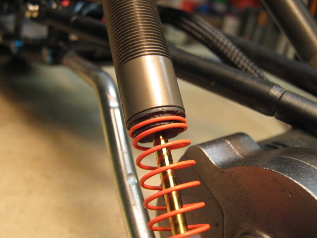

    Have you ever assembled shocks with the springs inside like the GMade R1 stock shocks?  It looks like the shock springs you are using might fit inside the shock bodies.
  20. highlandcrawler
    In the last pic of the Losi they are internally sprung. It works out okay but takes a ton of tuning and tweaking to get it just right usually. Mt biggest issue is the loss of oil volume causing different than normal handling. But with some piston changes and fluid you can make them work pretty good. On thing to remember about internal springs is they will limit your stroke in most cases. Not that that is bad, just something to think about and make it more confusing lol.
