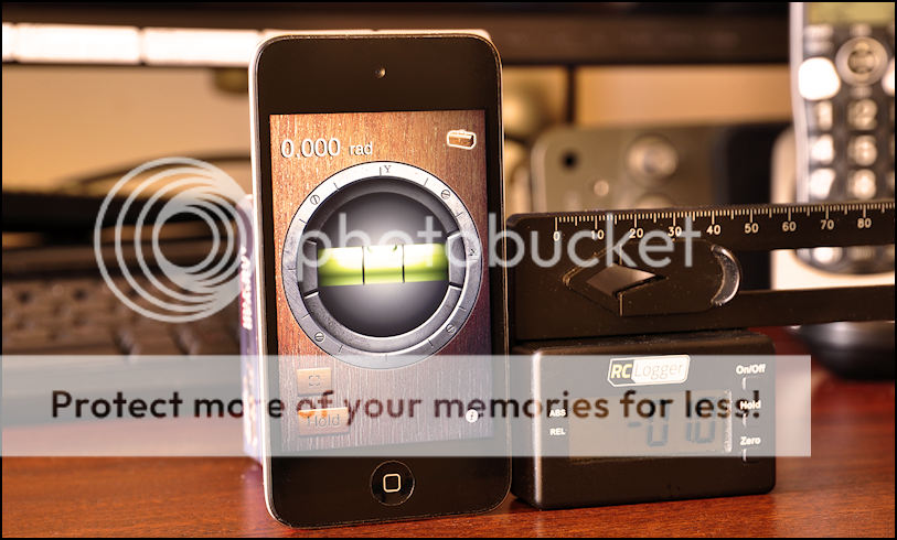

    This is the one I personally use ...
    RC Logger Home - Digital Pitch Gauge

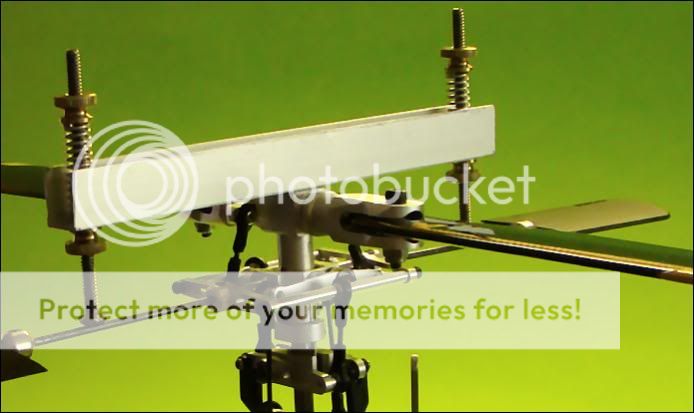

    But of course I do have my DIY Fly-bar Leveler
    And just for you iPod/iPhone (and Android) users out in the world ... {LOL} Note: one of them needs a calibration
    Forgot the prices
    • Rc Logger =  $37.93 US
    • iPod/iPhone App = FREE

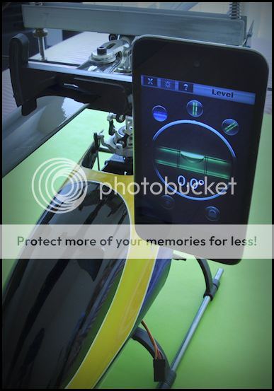

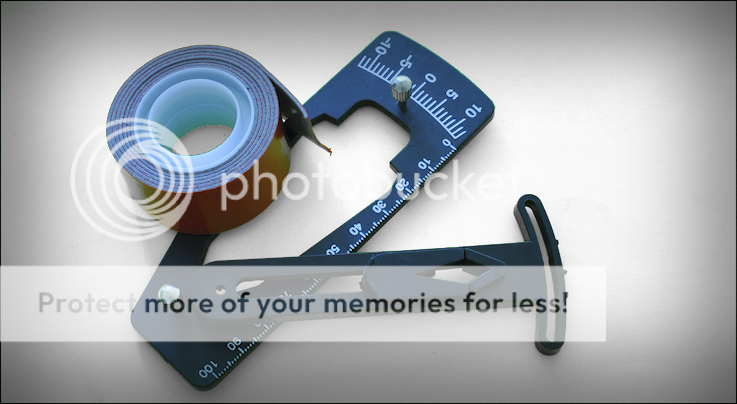

    [size=1.25em]SmartPhone Digital Pitch Gauge: [/size]Inspired by Tiger's post! I'm sitting here reviewing
    the thread w/ obviously too much time on hand. So I'm thinking my iPod Digital Pitch Gauge was always a
    a PIA to use for a simple Pitch Gauge. Then I get the grey cooking and in a true MacGyver fashion I think up the
    victims. Which are Two-Sided Tape and a very cheap $5 Pitch Gauge that's so incredibly cheap it ain't
    worth beans. In an effort at keeping it short let the pictures do teh thousand words ...
          [size=1.25em]Victims:[/size] Two-Sided Tape and the Incredibly Cheap $5 Pitch Gauge that ain't worth beans
          [size=1.25em]PROS:[/size] A usable SmartPhone Digital Pitch Gauge. [size=1.25em]Cost:[/size] It's a DIY J.0.B that ain't supposed to cost you
          anything, assume all the needed parts were on-hand
          [size=1.25em]CONS:[/size] One issue that might be a problem as my iPod was [size=1.25em]near [/size] too heavy. If I were to use
          the iPhone this probably would be too much weight to hang off the blades and especially so
          for any heli less than a 450 in size. Thinking about using the iPad!?! Well I ain't going to assume
          some "Lurker" might NOT wanna try {Bada-BIG-Bada-Boom}
