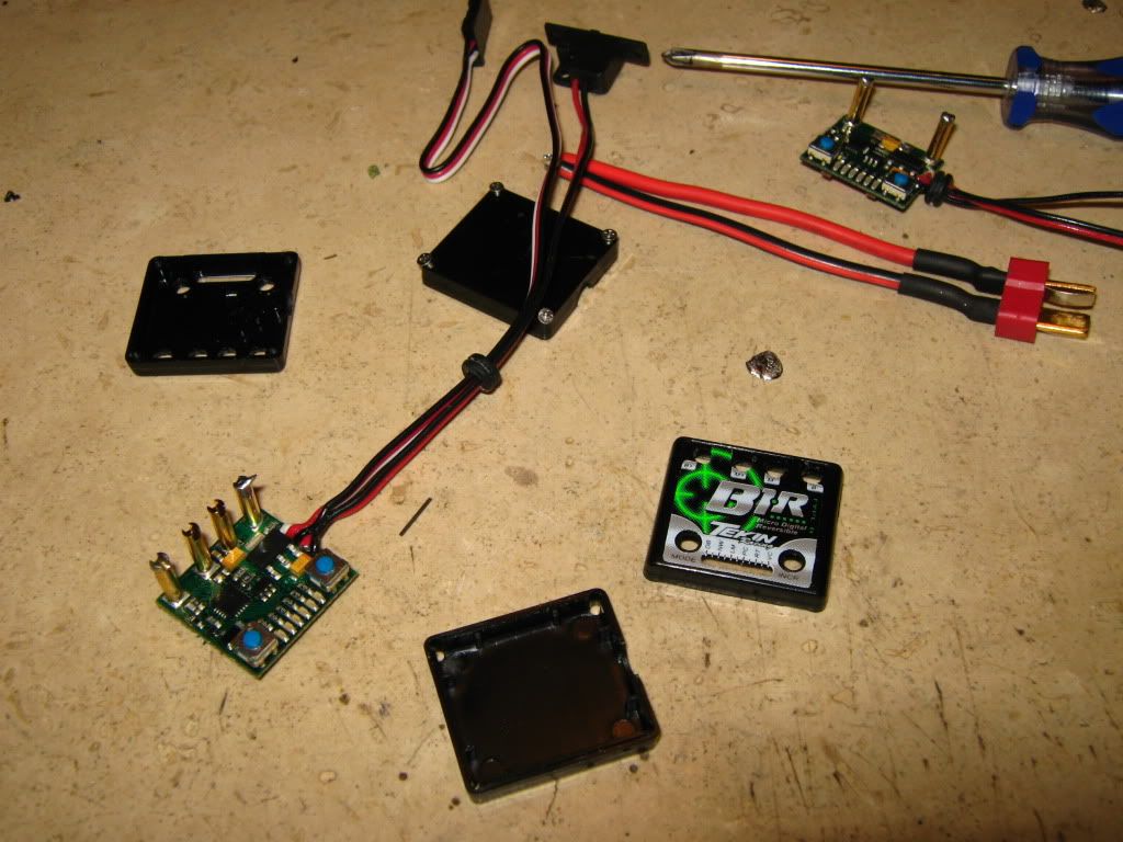

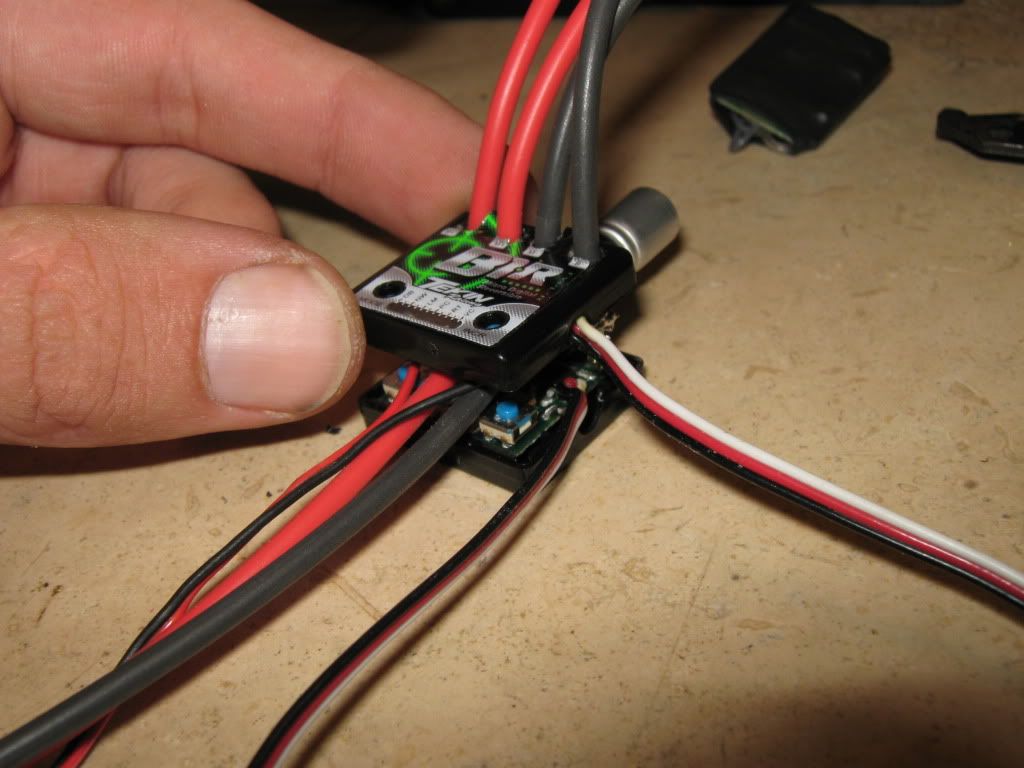

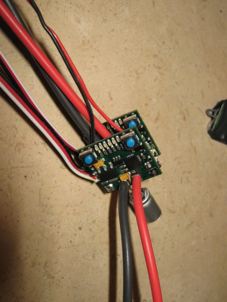

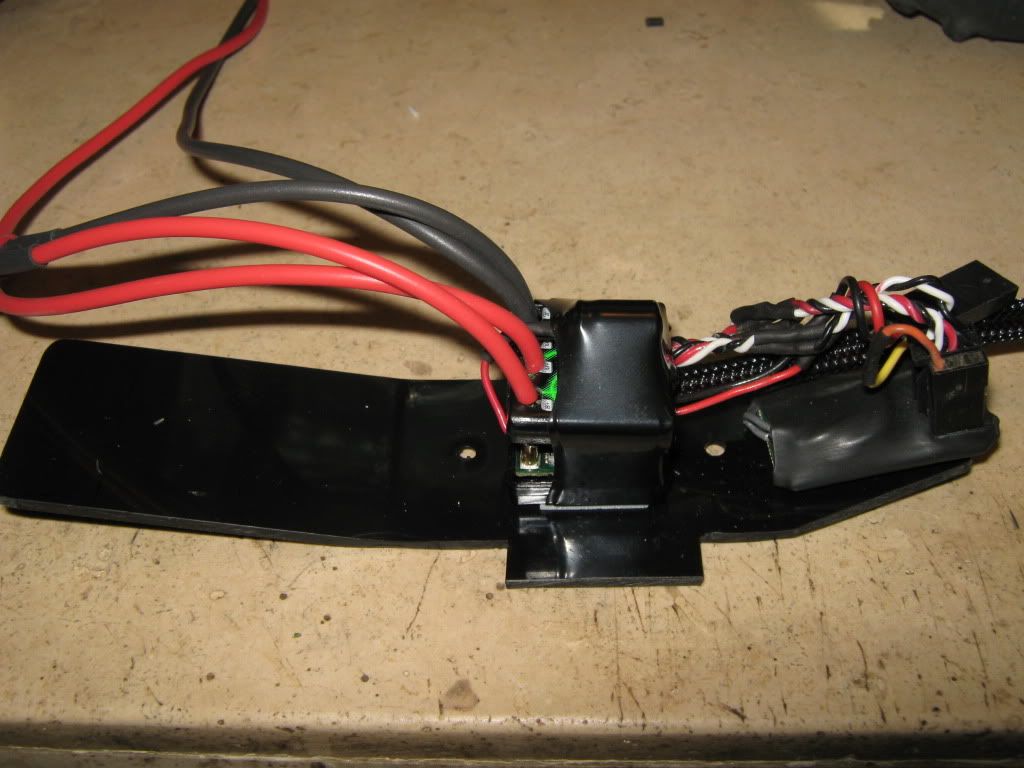

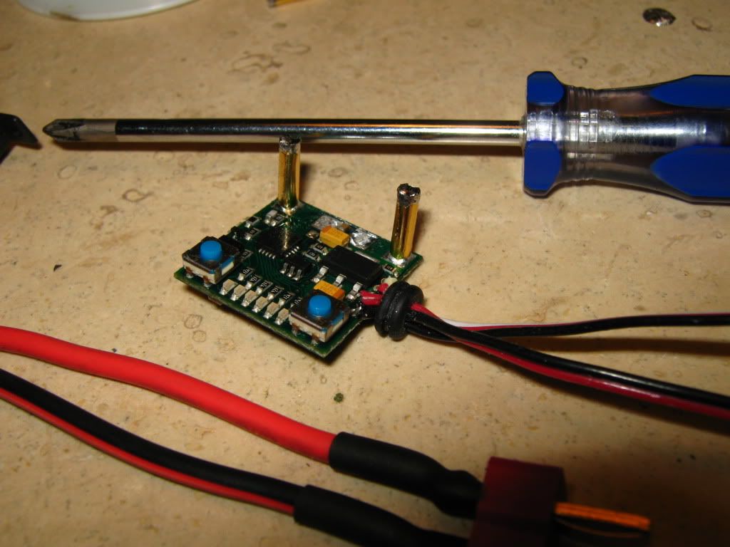

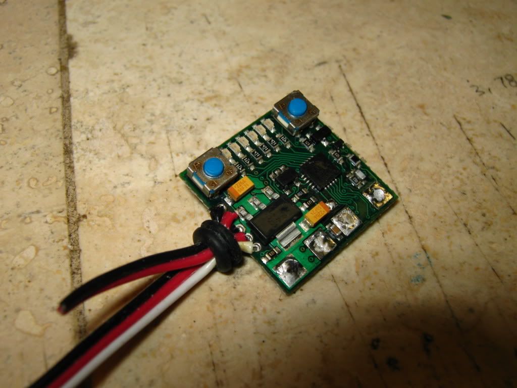

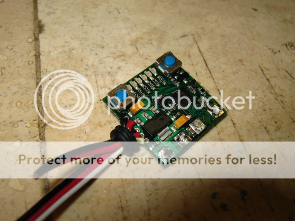

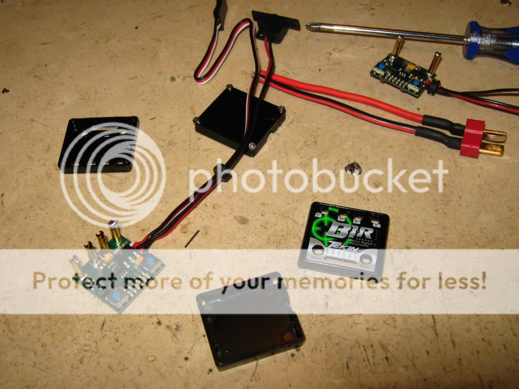

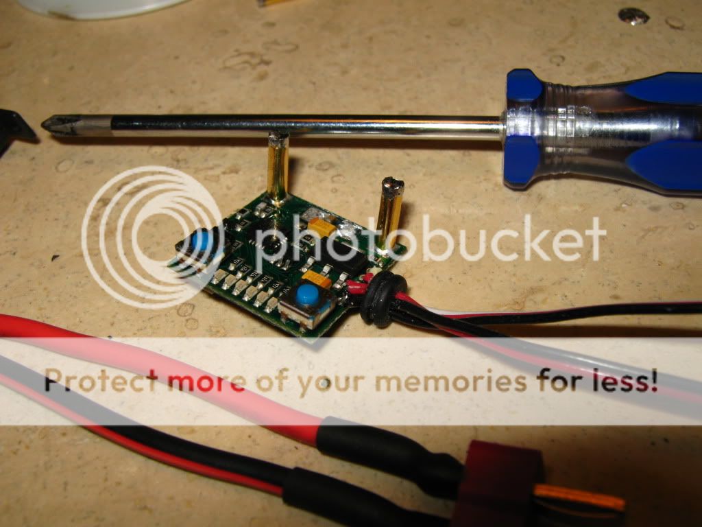

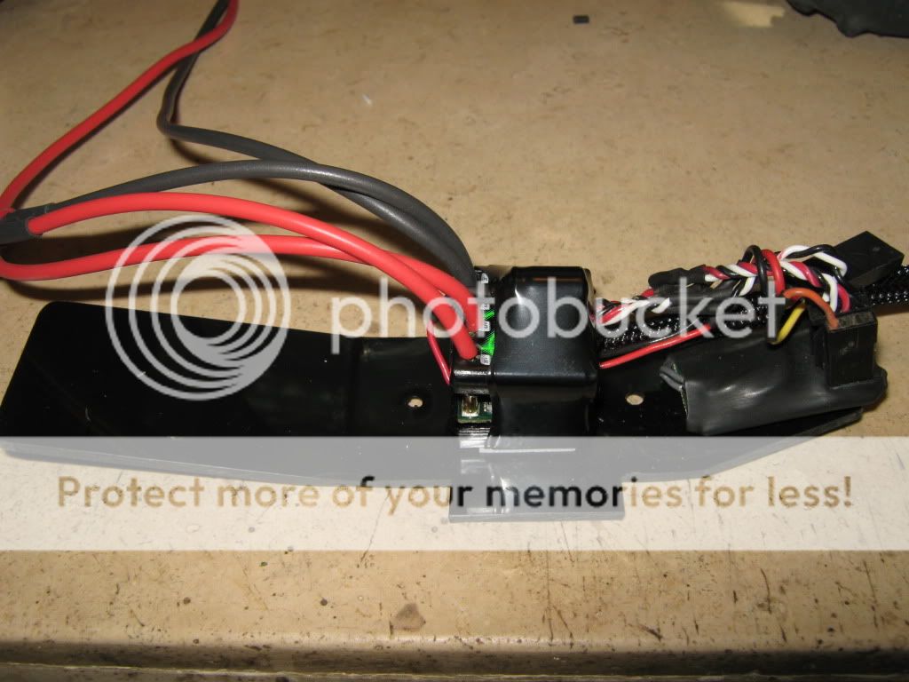

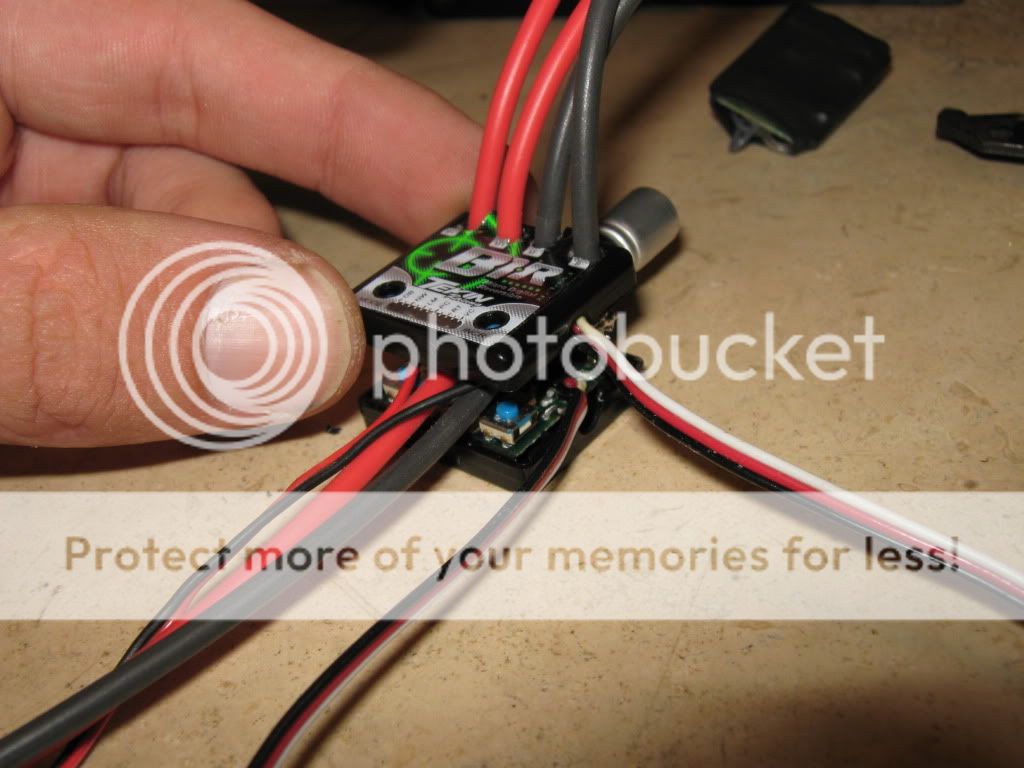

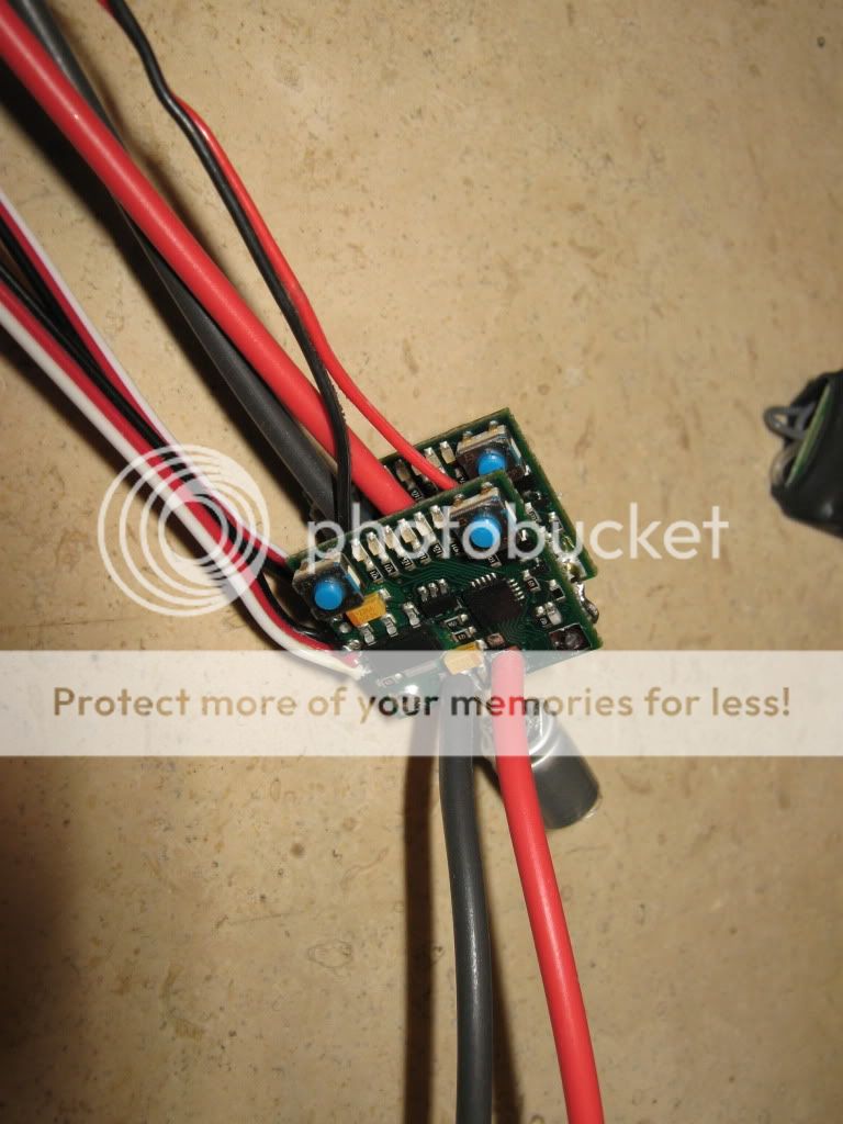

    Thought I would share the "squish" job I just did on my berg. I started with 2 new Tekin B1r speed controls and squished them together in one tiny little package. I took the solder posts completely off 1 of them and removed just the motor pins on the second. I ran 18ga wire out of each for my motors. I deleted both power switches and shortened the receiver leads down. I then soldered them together through the battery poles. I don't run a bec on this setup as the servo feeds 12v direct from the battery that is the other set of small wires coming off the battery posts. I took the case from 1 of them and routed my front wires through the post holes and slid the case down and shrunk it together with the cap on the top. I can just drop my whole electronic package in and out through the bottom of the truck attached to the skid
