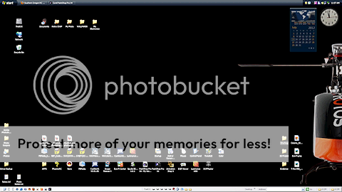

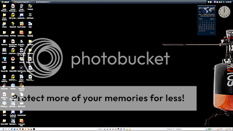

    The utility saves the ICON positions w/ the 'Right-Click' {LMAO} now the PUN is intentional
                  [​IMG]      [​IMG]
    Utility restores the 'desktop' after the UI does this silliness ...
    The program is especially or best used during or after the days work, after ALLOT of ICON moving and for putting the 'desk' back into the preferred layout.
    This can be and often is where and when I use the utility the most often

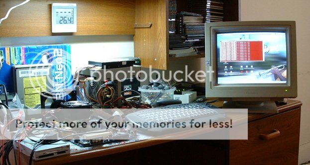

    I went rummaging through my old photo's and found teh photo of my HTML (Linux/Apache/PHP) Server which was teh one shown on my desk in bits ...
    ... Photo was edited, click 'here' to see a small version of the original

    That's a nice looking little server w00d.  What is being displayed on the front panel LCD?  Are those temperatures?  How were the internal temperatures?  It's a pretty small case so I was wondering if it got hot in there.
  20. w00d
    Yup that display is displaying temps, most important is the first number (left) which is displaying the Core Temp! It gets it readings from the sensor incorporated into most AMD CPU's. When that number reaches 50ºC I start to get nervous, over 60ºC and I shut her down ... If I remember right I set her to shut down automatically at 55ºC Core Temp
    The second from left gets it's reading from a sensor inside the case, it's measuring the temperature inside the case.
    I also have the option to measure Mother Board temps which is basically measuring the North Bridge (NB) temperature as it's sensor is in and around there somewhere. But this reading wasn't so important so I'm not using that option. Anyhowz, odds were if you had an HIGH CPU temp then you also HAD a HIGH NB temp.
    The above should answer this question "It's a pretty small case so I was wondering if it got hot in there" The second sensor or second reading says my Case Temp is 26º +/- a few degrees.
    Thus it's NOT so much the SIZE of the CASE that determine how HOT the Case Temp will be as it's the actual 'Air-Flow through the Case' that does the cooling! Size has no relevance, it's about how much Cubic Feet per Minute (CFM) of AIR we can get through the box ... This said small cases have limited room for FANS or the mounting of FANS thus it could limit the CFM through the system. This is the reason why small cases CAN be problematic with respects to their ability to cool!
    As the photo shows and the temp readings show, there's more than enough FAN power inside that box! Discounting the High Speed and high CFM 80mm CPU FAN even the PSU has two 80mm LED Fans along side that high speed 120mm sucking the ALL the BAD air OUT ...
    ... Yes it is a small BOX but it was sold as a 'Gaming BOX' and was designed to COOL great and CARRY easily ... Still it was up to me to make sure there was enough CFM to cool this system and I thinks the temps prove I did my homework ...
