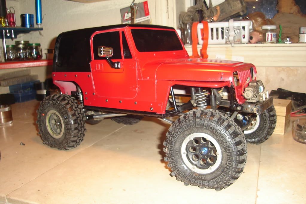

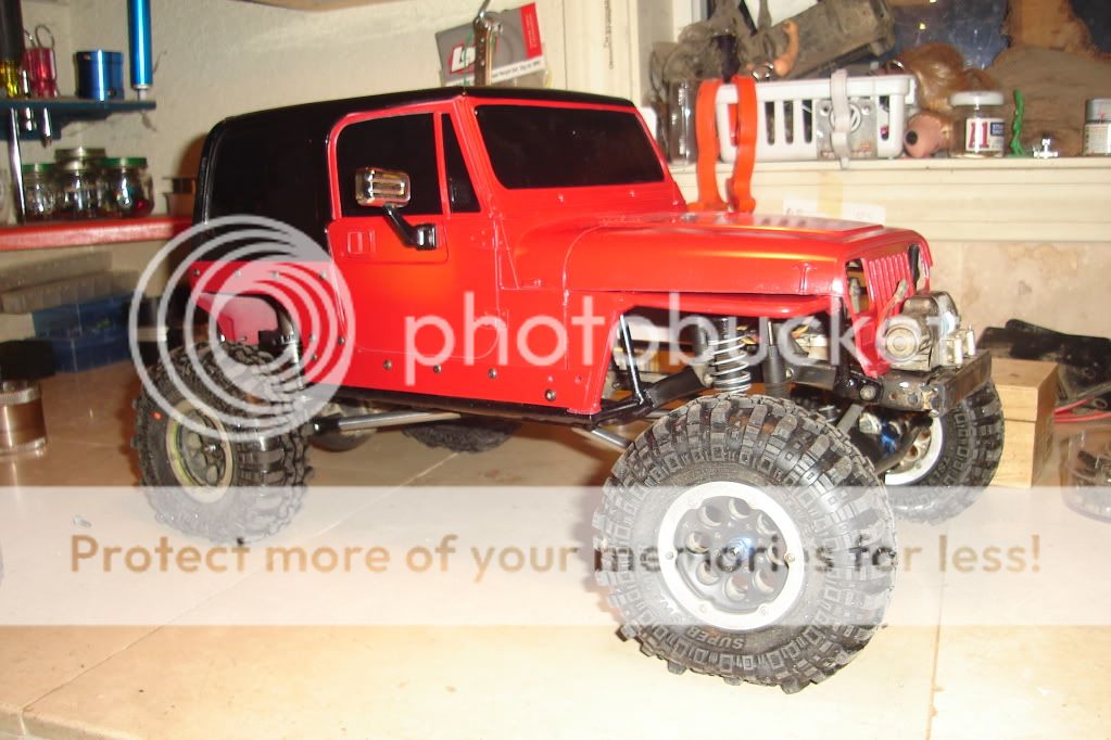

    How about dual shocks at the rear? You could run a single standard shock with a heavy spring and a second spring less with heavy fluid. I have used this a few times where weight was an issue but the customer still wanted to jump it super high. If you look close in this pic you can see what im talking about. This beast weighted in close to 9lbs with a brushless and a 2spd summit tranny. He flings this thing so high in the air it makes me cringe but the suspension has always soaked it up and taken the abuse
  5. Golden Child
    Very nice! I'm kind of limited on mounting options as the frames are already powder-coated with only single-shock mounts front and rear. I'll definitely keep that in mind for the 1/5 scale build.
