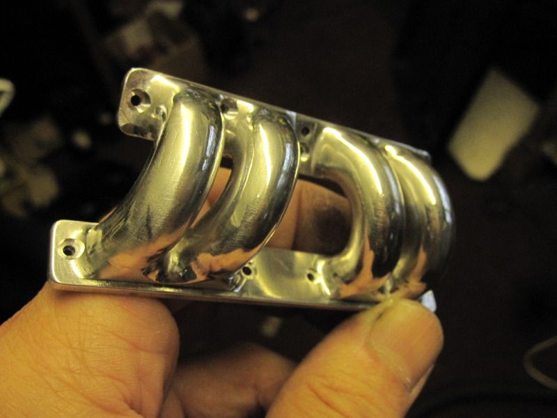

    Tyson - I think you got it. He's been working on it for 22 yrs! How'd ya like to make this part on a manual mill (or CNC for that matter). You can see the work in progress on page 13. He says: "I used a ball nosed cutter, and worked out the x,y and z measurements on the cad. The other variable was the dividing head angle. It started off veryslow but I soon got into the swing of it. I reckon30 hours to make one set of pipes."

    So lets say you could cut that thing. How would you hollow out the tubes? I can't even imagine! I don't know how he did a lot of things on that engine.
    Truly amazing!
    He's not only a gifted machinist, he is a gifted artist under the truest definition.
    A sculpture of metal, a 3-dimensional guru.

    My thought on that, at least how I would do it, is lost wax process, then mill the outside. I can't think of a reliable way to mill the inside to keep all the runners of the equal volume needed to make the engine run properly. Just my 36,000 pesos ;)
  12. Pelagic Pilot
    Looking at the diagram in the blog it looked like two straight bores that intersect as a V.
  13. Tiger
    PP - You're right. I didn't notice that. If you look further up the page you can actually see it in the mill with those holes drilled. Not what I imagined, but it obviously works. So the beauty on the outside is just for looks (which is fine). It's all such an awesome piece of work.
