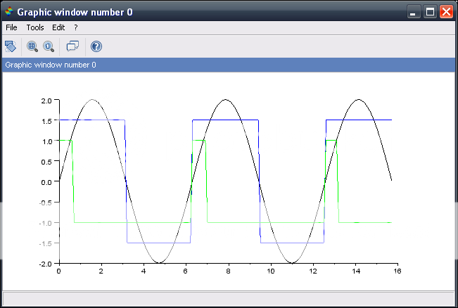

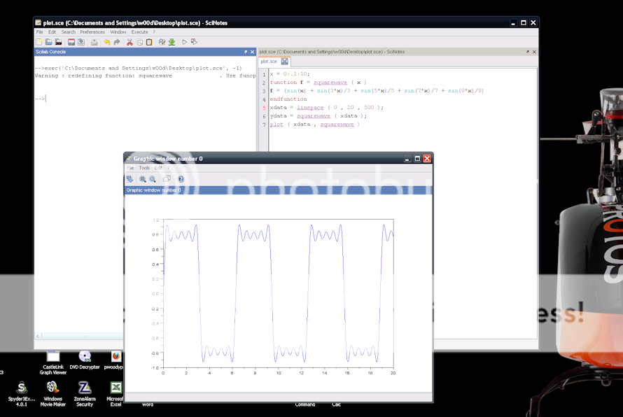

  2. w00d
    Well I had said "SciLab is not for everyone" but I did get SciLab to dance by doing what I wanted which was to create a Square-Wave PLOT
    True this is the first MATH Application I've ever used but w/ only ½hr of reading the documentation "Introduction to SciLab" the go-to DOC for getting started I was surprised I was able to create the following plot in such little time. Yes I thought getting there was relatively easy which was the surprising part. If it helps you could think as the software as the Programmable Calculator on Steroids ... I say "on steroids" because there's so many functions and tools built in it would make the head spin trying to memorize them ALL
    As for a User-Review I would say for a GUY that is totally NEWb to these type of programs the learning curve to get where I did wasn't too difficult. Although I suppose it would be helpful to have a good understanding of Math w/ a little programing knowledge backing one up
    Would I recommend, well I can't say as I haven't tried others such as MATLAB so it would be difficult for me to judge accurately. I do think MATLAB is a little more polished or better looking than SciLab but the former is not free and it's function-over-form, right. The Student version of MATLAB will cost one $99usd
    The best I can say is try SciLab as I did and you also maybe surprised ... But of course having the need for a program like this would be a darn good prerequisite but HEY I thought that would be assumed, hehe  :eek:

  4. w00d
    LOL, it's MATH it can be as simple as "2+2" or as complex as "E=MC²" (LOL, well allot MORE complex but ya gets z idea!)
    Even Google does MATH! HaHa, "YEAH so what I know that" but DID YOU know Google can also do complex MATH
    For example look again at my Square Wave equation. Copy & Paste the following equation into Google's search BAR ---> (sin(x) + sin(3*x)/3 + sin(5*x)/5 + sin(7*x)/7 + sin(9*x)/9) <--- Then press ENTER. And it WILL more or less do what I had programmed SciLab to do without ALL the fuss
    Try it ---> Click HERE and it will even DRAW the PLOT and it's even an "interactive" PLOT ... How COOL is that
        [shadow=Orange,left]w00d[/shadow]
    EDIT: LMAO, but of course it don't hurt when one finds the actual "Function" in the software you are using that will get the J.o.B done, beats writing the "function" from scratch. For example I just found an even easier way to create them. Well it's 2 lines of Code verses 7 ... As always w/ math "there's many ways to skin the mathematician"... Can't wait, who knows what I will know tomorrow. I started my day as any other which started with a question, "How Do I" {hehe} Seems LIKE cheating, eh!

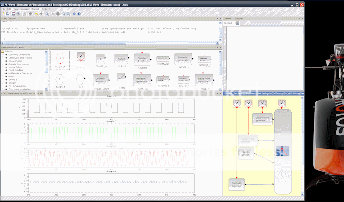

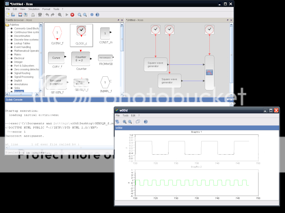

  7. w00d
    WOW, It just keeps getting better, I found the Simulators. Well NOT so much found but created as I had to make this myself with the tools provided. This "simulation" is, well as you can guess it's a Square Wave Simulator in this case but not limited to. Now I just have to figure out how to output the data to my oscilloscope or even a Motor because I will have created a Function Generator which can be used to power Motors directly but this is another lesson for another day. The inspiration came from ---> HERE <--- PS: The output window is acually animated, meaning it's constantly creating the output, the Square Wave as it would w/ a "real" Scope ;) and I almost dropped the cash ($1000+) For a stand-alone Function Generator, w00t
    haha, we're "programing" now

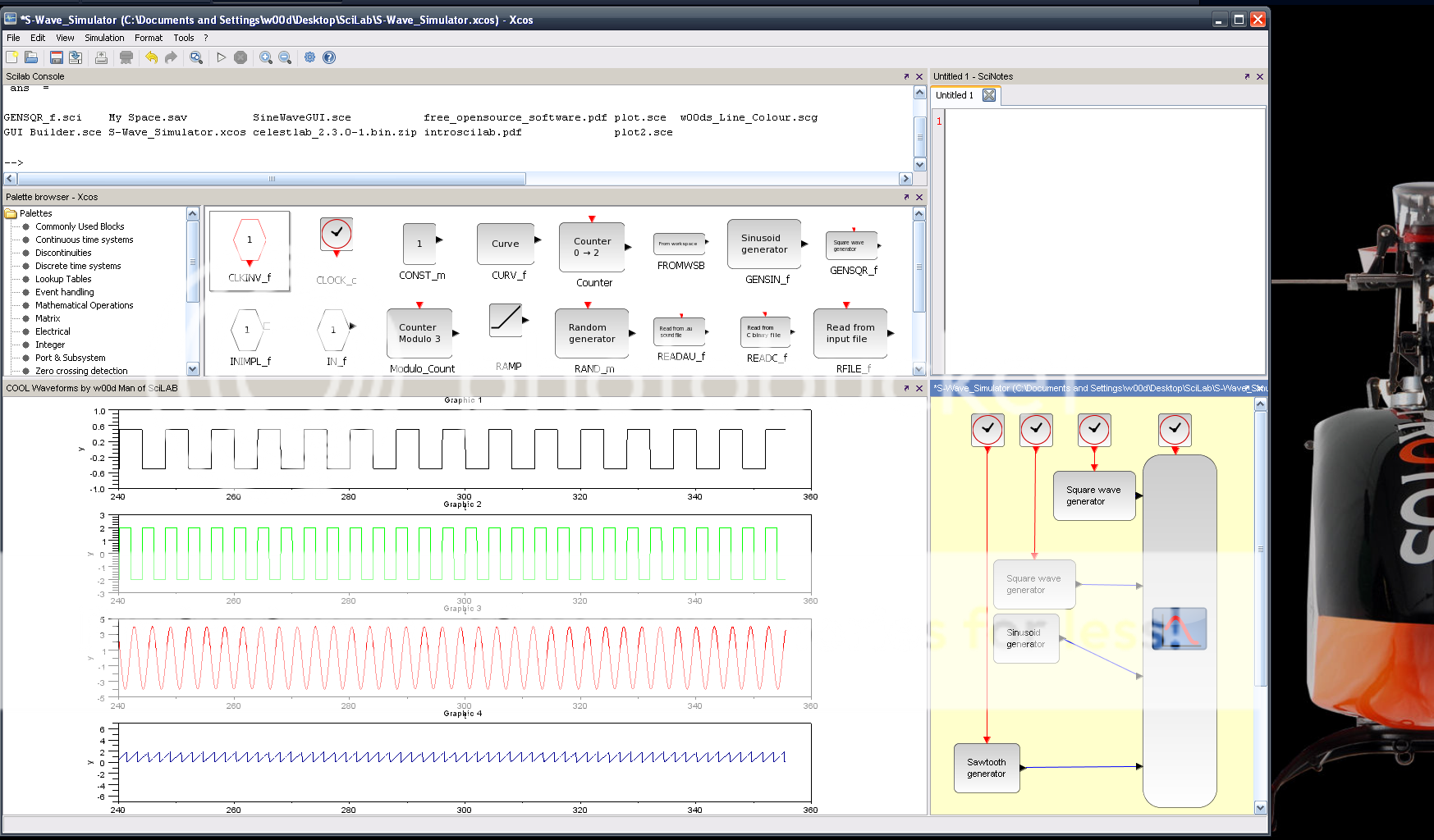

  8. w00d
    MORE: More waveforms
              [size=0.6em]Click for Larger[/size]
    FUN'n Learning, yeah MATH is FUN  [​IMG]  DID someone SAY it wasn't, wasn't Smea  [​IMG]
          ... Wish BB-Code was this powerful ...
    Going off to find some more tutorials for this Simulator thing, later! Oh and thanks for looking
