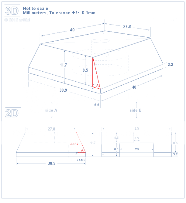

    Not sure where the images went, but I was going to say that the angled sides would make that a difficult part to make. If it could be a cube then there would be no issue, just CNC a block and then turn it over to finish. With angled sides you would either need custom ground tooling or done as a 3D process with a ball mill.

    Unfortunately the angle is needed as it is used to lock into the tripod's quick-release mechanism. However the wall thickness is not important. Whats important here is the inside dimension offer enough clearance for the Bolt which attaches the camera. Which can be as simple has a smaller counter sunk hole into a larger. Important is the out side angles remain accurate but the 'tolerances' would be somewhat loose by +/- 1mm. In fact all the  'tolerances' are rather loose, except the base dimension which must be allot more accurate and I'd guesstimate around +/- 0.1mm

    w00d, the 3D nature, hollow, thin wall elements of this part make it extremely difficult to machine/setup. because of the angled sides I could see this part 10 - 12 hours to setup for and finish. If the sides were straight up and down (a simple cube) then it would be a 1 hour job. Your part would need to be done with either custom ground tooling (Lot's of $ and weeks of time to have it made), a 5 axis milling machine ($400,000.00 machine).
    Or with what I have which is MeshCam and using a two sided method with holding tabs that get cut off later. But I have never done this before so I have no idea what it takes to get it right:
    http://www.grzsoftware.com/users/larryw.html
    Thanks for answering PP
    Would it make any difference if I said the inside didn't need to be cut out ? The part don't need to be hollow ...
    ... The original part is only hollow to accommodate a fastening bolt but this I could do myself with a little 'redesigning' ... I could drill the holes this needs
    Only the outside dimensions are important, the two angle-cuts are what makes it work so those it must have

    wOOd - Do you know the exact angle of the sides?
    Don't know the angles at the moment Tiger, I will have to find my protractor, or calculate.
    I will get back to ya when I have the numbers.
    Thanks
    According to my calculations the angle should be 57.1º, rounded to 57º
    ... using this calculator ---> http://www.1728.org/angsize.htm
    Given the 'angle' was not actually measured w/ a protractor the angle as calculated should be close enough
    ... tolerances are not that tight anyway
    The measurements used to 'calculate' which are also pretty close but I would have to double check before actually machining ...

    Do you have this drawn up in a 3D format? If you do and can produce a .STL file I can load into Meshcam and see what it looks like for doing a "water line" process with a ball mill. How big would the finished center hole be?
    No I don't have it in 3D format, I drew the above w/ photo editor by hand.
    I can't say I know how to make a .STL file? Can't say I know how to draw it up in CAD either?
    PS: Don't need the hole, to save time I can do that myself ;) Although I can/will add the hole detail to the above drawing
    Update: Center holes (camera attachment) added to drawing
  14. Pelagic Pilot
    I have a 3D CAD program, but don't know how to use it very well. I think there is enough data on the drawing to work with, so I can try to see if I can produce a 3D surface model, which is needed to work with. A water line operation is what would work the easiest I think. And the hole would actually be required to machine it. Otherwise you could not hold it down when it is time to turn it over. Can't promise anything as this is un-explored territory.

    So I gave it a try tonight, somehow figured out how to draw something in 3D, then exported to a .STL and opened in Meshcam. For some reason I can not get the tool profile to daylight out on the angles. I know Meshcam does not like straight sides, but it should be able to do the whole part when it is a solid model. I will have to ask the guy who wrote it.

    When I got up this morning I just needed to watch the right YouTube video and find out that I did not have a setting correctly set in the software, so now it looks like it would work. I will probably still run it to see how things turn out.

    So here is what the toolpath looks like since I figured out the settings, this should produce the full part, the little lines are where the cutting tool will travel around the block, it will step down each time at a distance of .005" while allowing for a round profile:
