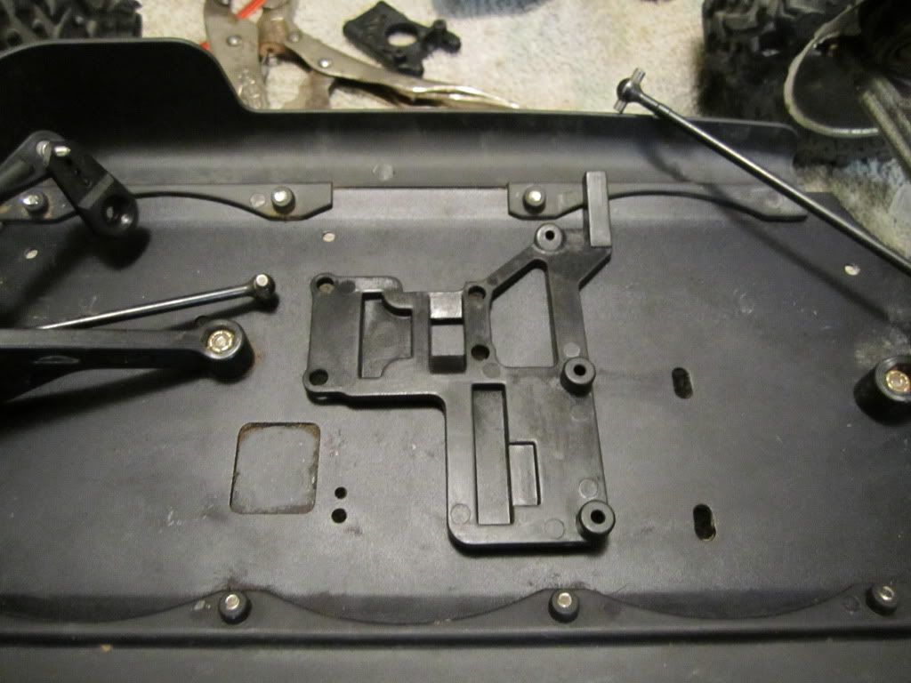

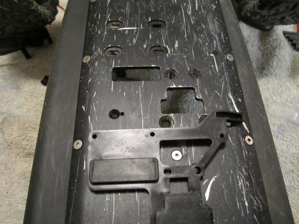

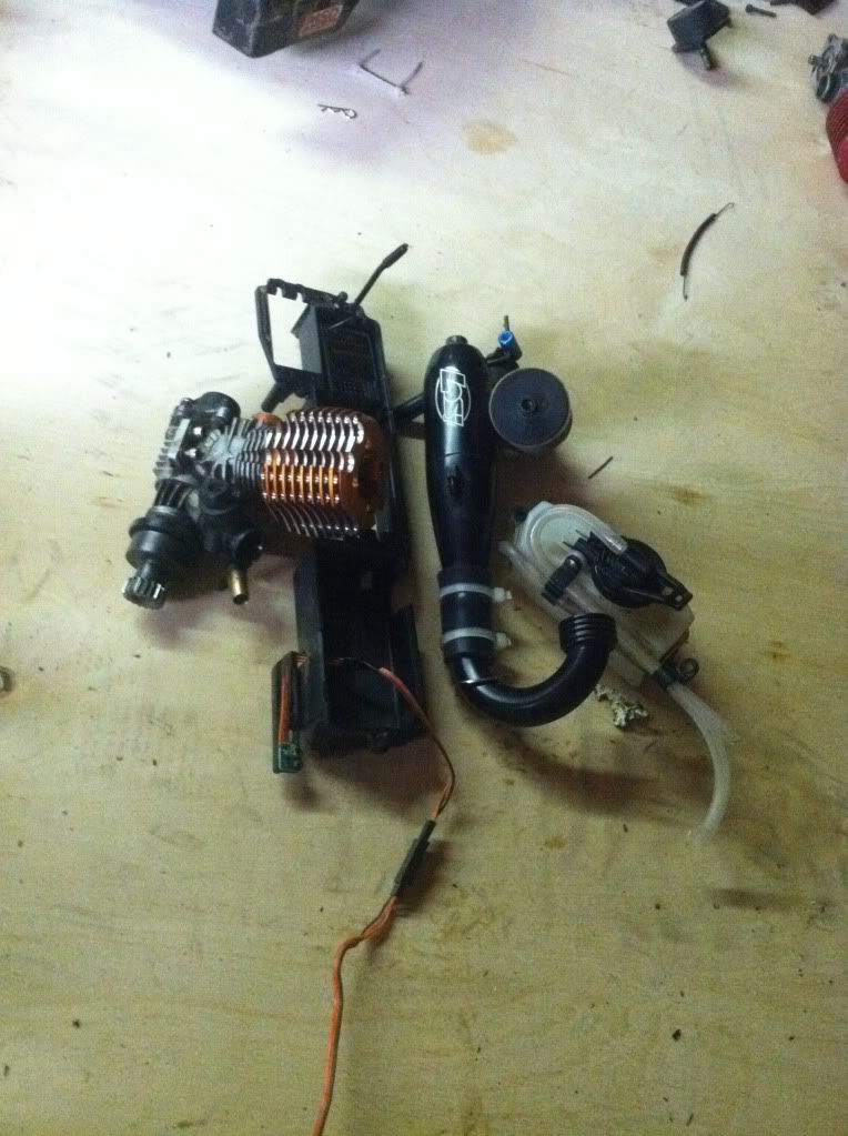

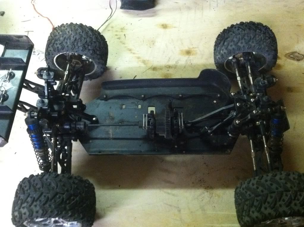

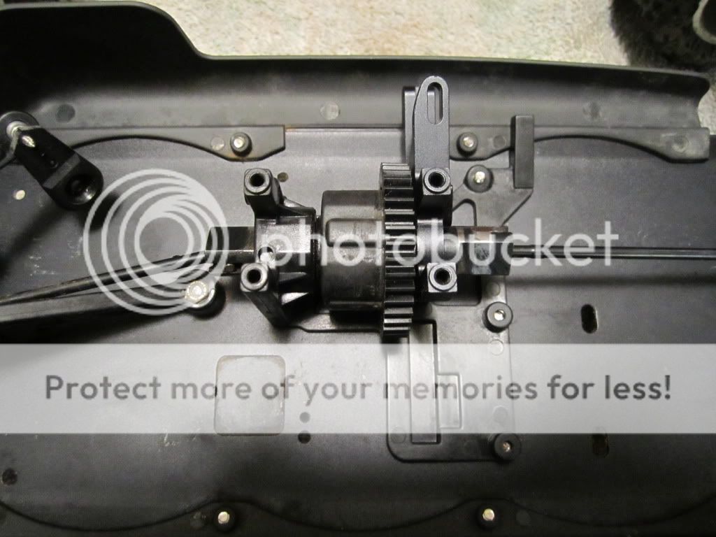

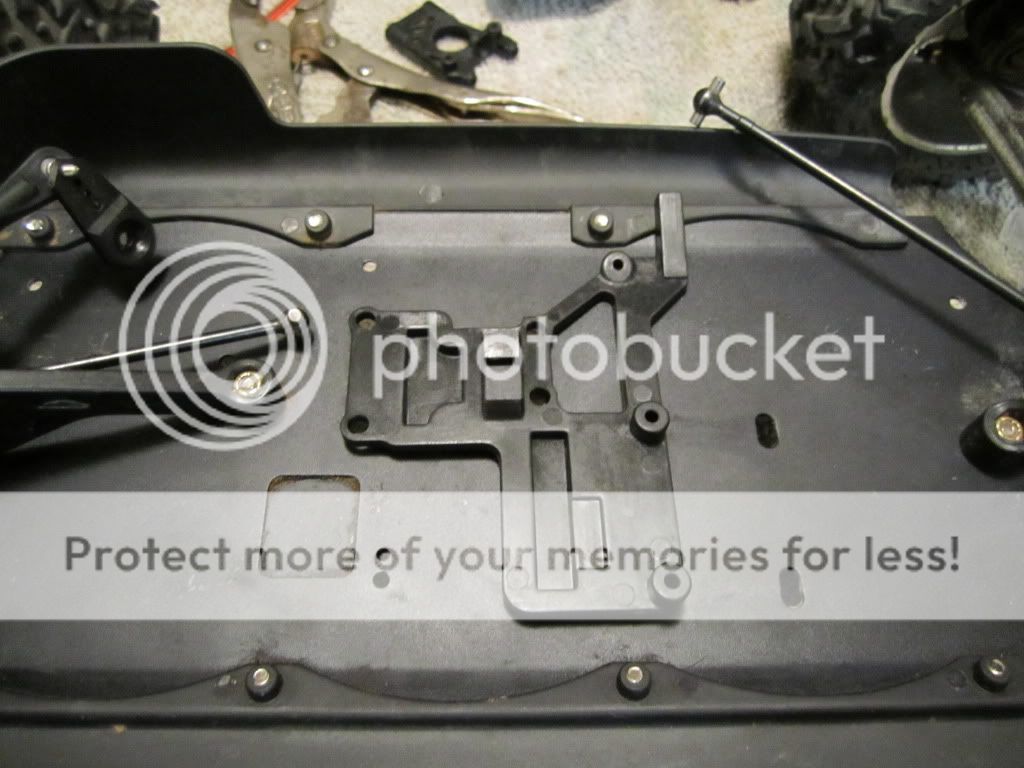

    Pile of old parts....
    Ready for Brushless :)

  7. GPNate
    GPNate Registered
    67
    I am looking to part with the engine.  It runs perfect and even has roto-start on it.

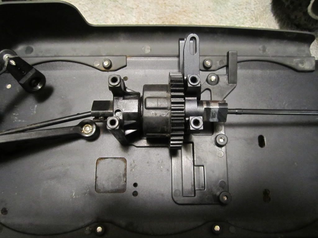

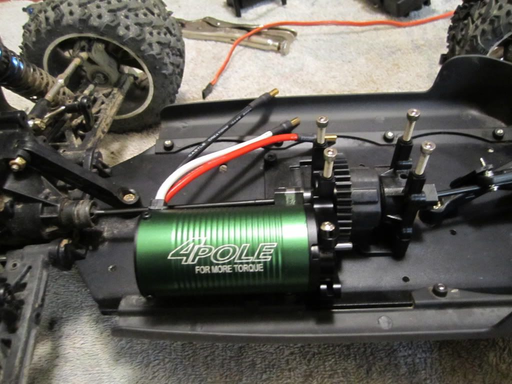

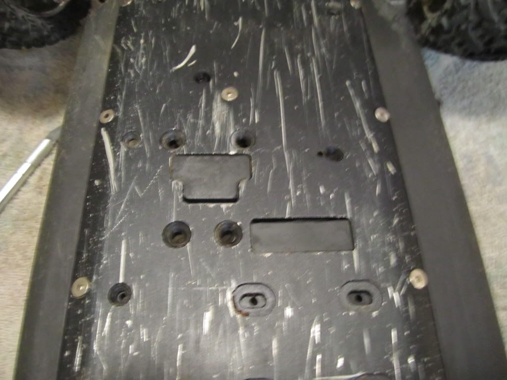

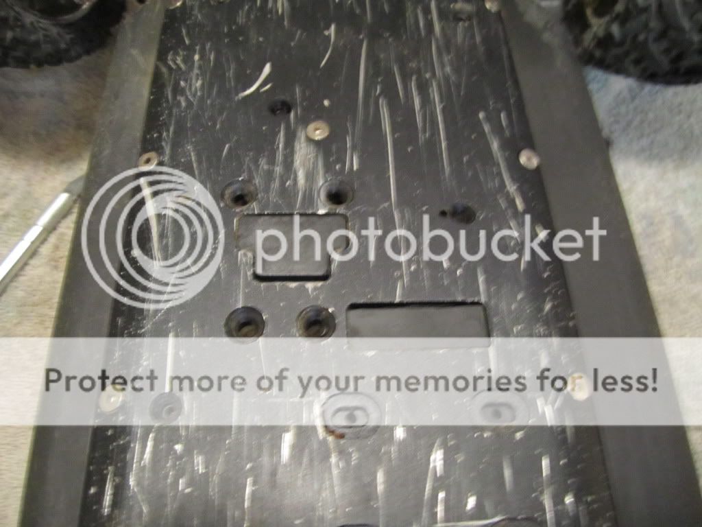

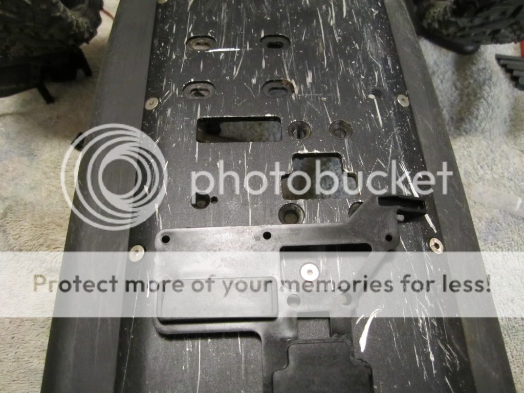

    Hi All - Got parts in last Friday and made some progress Sunday night.

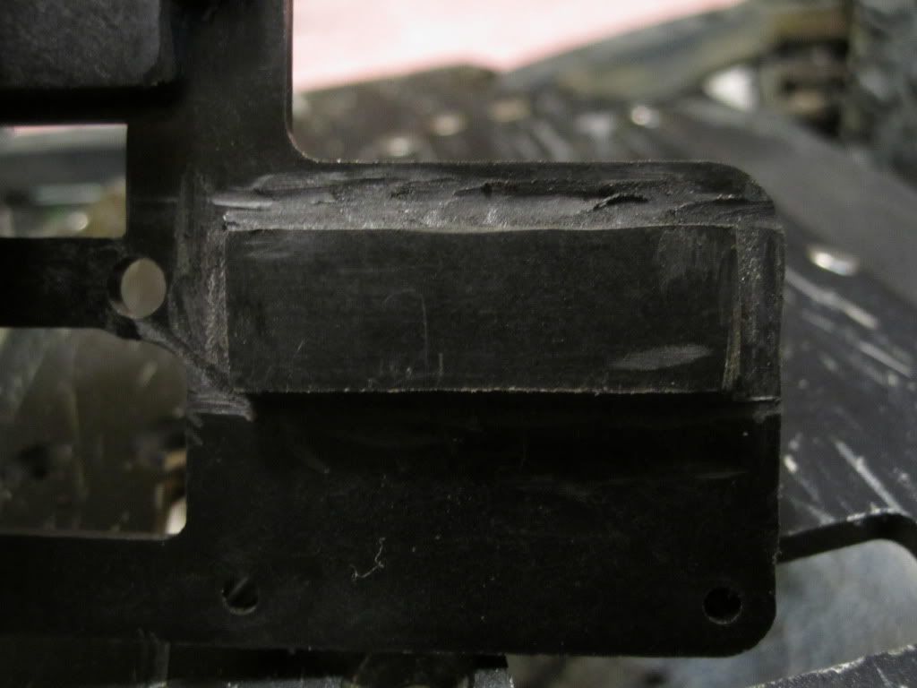

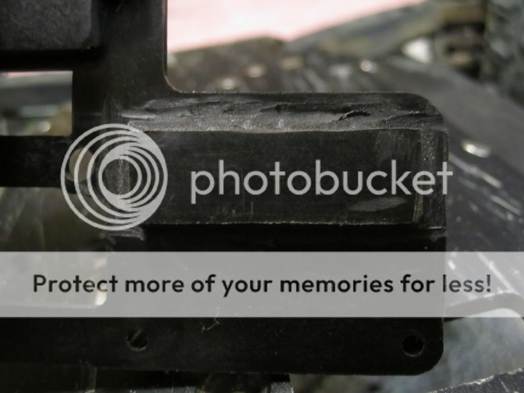

    I had to modify the part of the top brace to get it to line up.
    Pic of the brace after I modified it.  I used a die grinder with cut off wheel to shave it down.  I had to keep the RPM's down to prevent melting but it worked well otherwise.

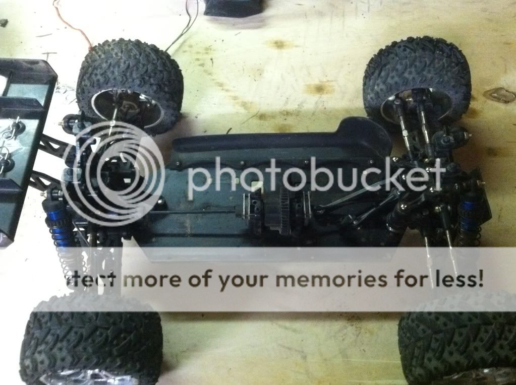

    Top Brace in!  :)
    Transmission in..

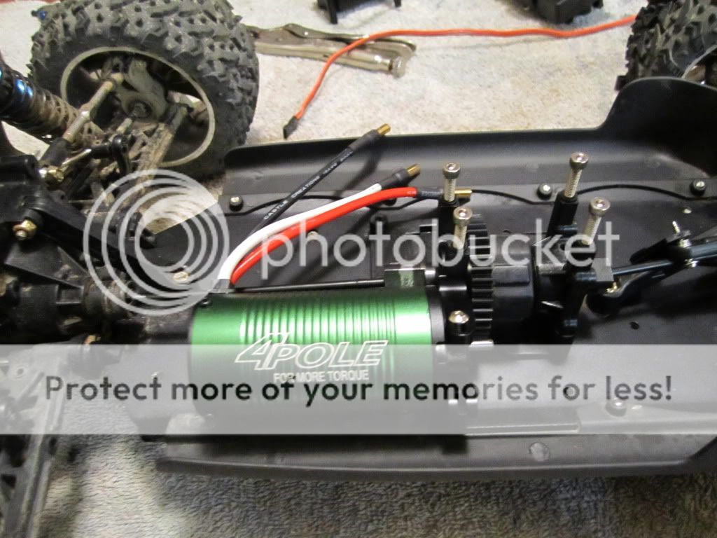

    Motor in..

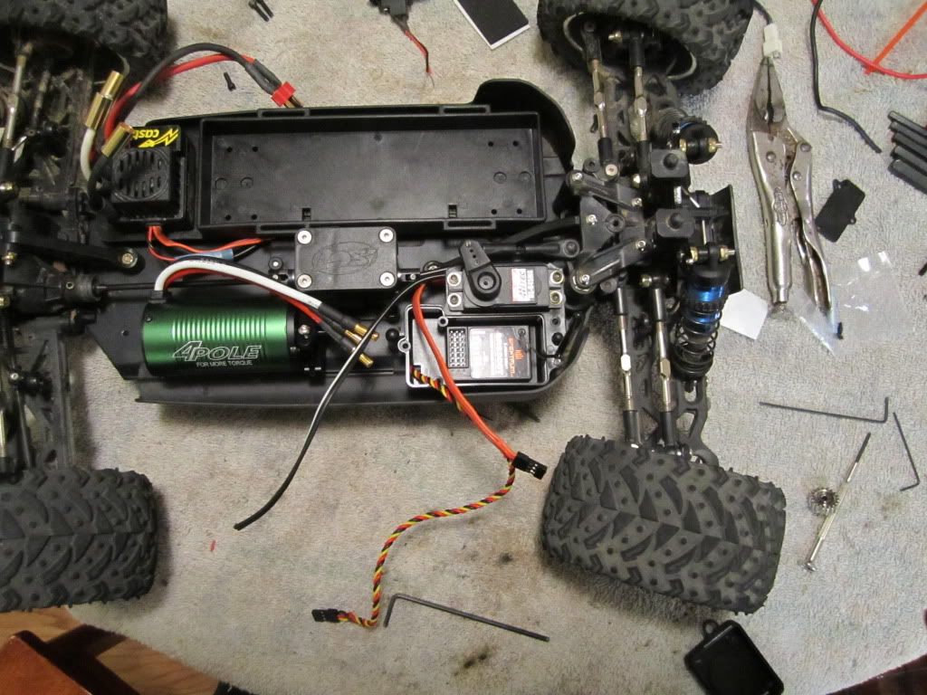

  10. GPNate
    GPNate Registered
    67

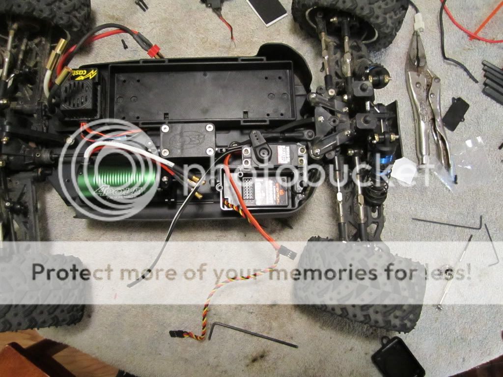

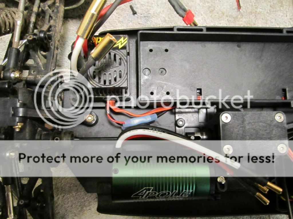

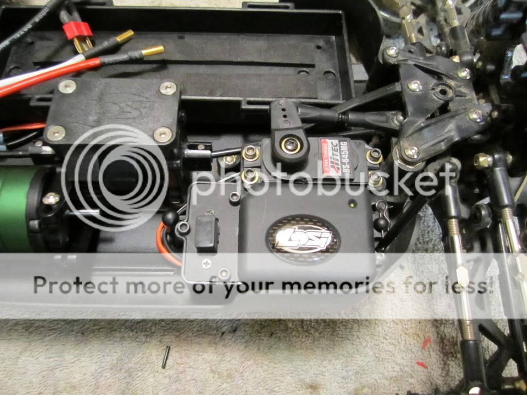

    Here are some more shots of it mostly complete.
  11. GPNate
    GPNate Registered
    67

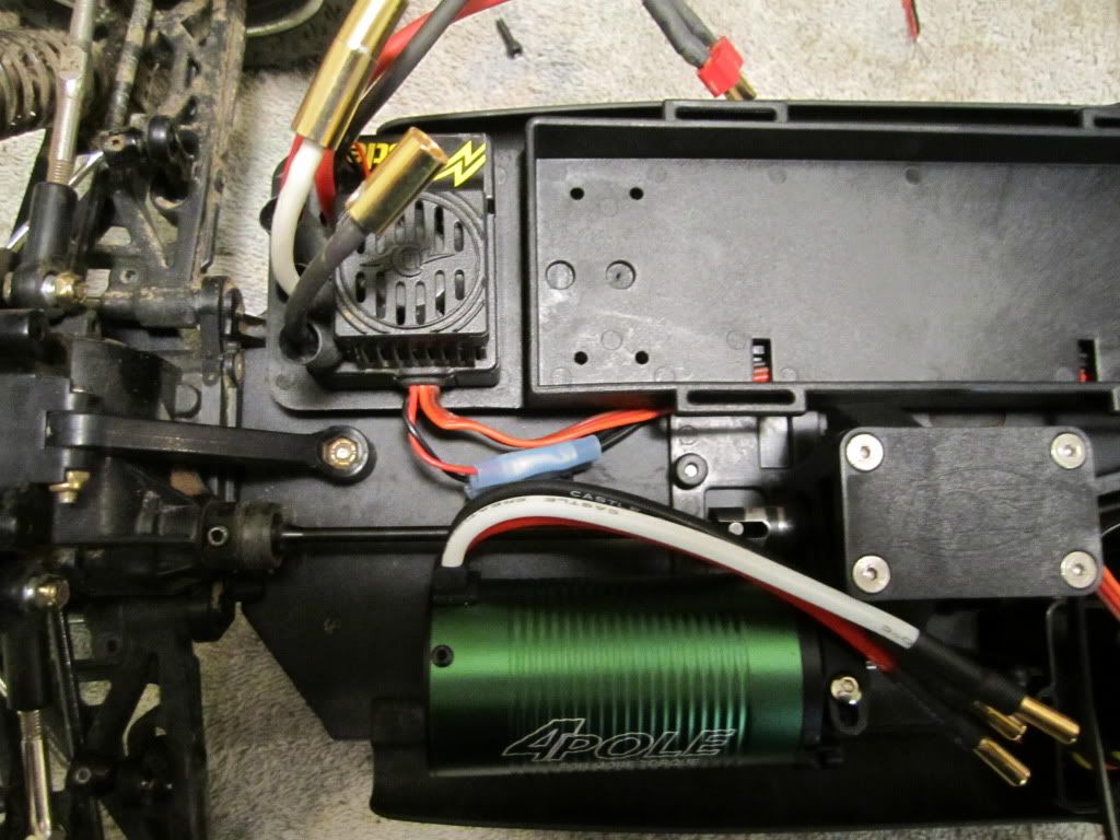

    I had a few snags just like any conversion.
    - Motor has 4mm Bullet connectors, ESC had 6.5.  No worky!  (The ESC was previously in an SC8E, which now has a mamba monster  ;D).  The SC8E comes with the 1/8th scale 2200kv motor and thus needed the 6.5.  Adam @ Sleadds has the ESC and will be soldering on the correct bullets.  Thanks Adam!
    - Castle 1415 has an 1/8th pinion (3.2 mm).  Oversight on my part.  Try finding mod 1 pinions with 1/8th shaft.  After some research, I found that ofna makes some pinions that should fit so I ordered one up.
    Should be up and running soon!

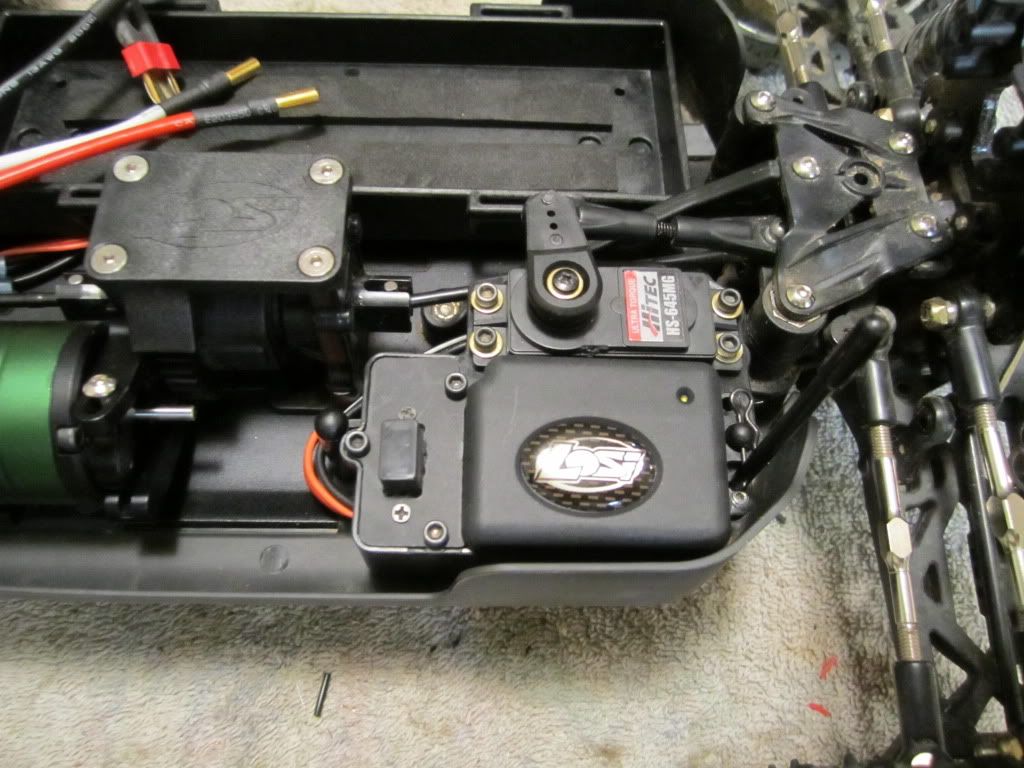

  12. GPNate
    GPNate Registered
    67
    The pic above shows how I ran the ESC wires and switch under the battery tray and decided to keep the nice little off/on switch that was used when it was nitro.  Besides, I didn't really find a great place to mount the switch anyway.  To do this, I had to cut a hole in the new plate that came with the receiver box.  I like how it turned out.
