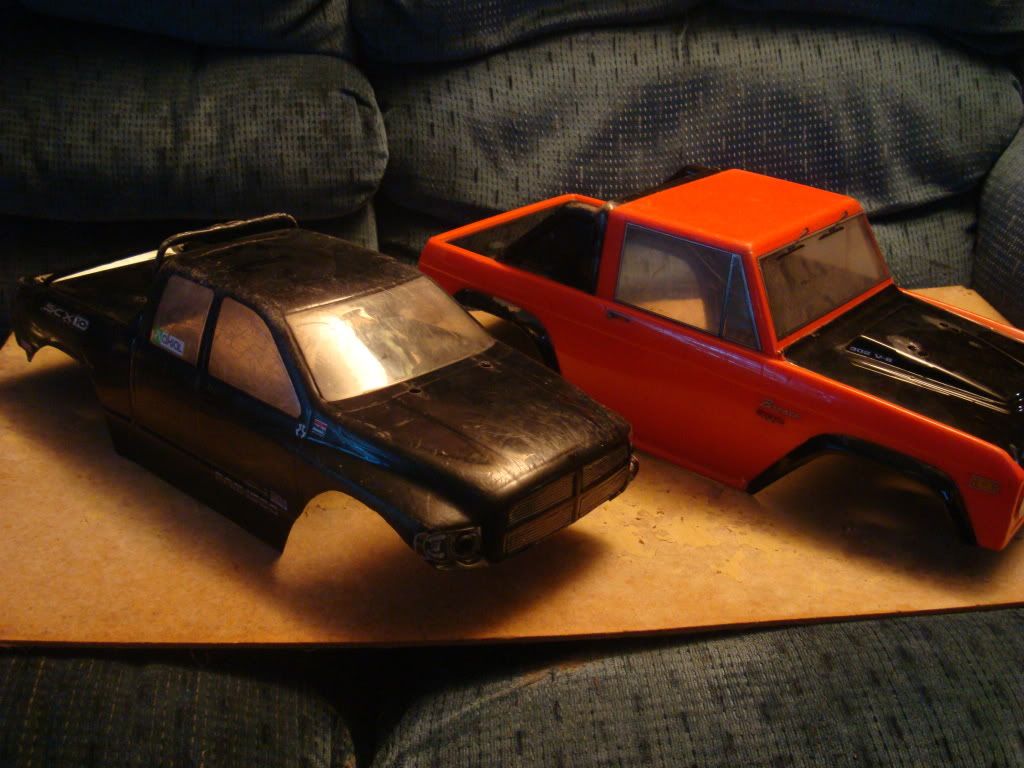

    It is hard to tell exactly what was done to it and changed without seeing it. If he just adjusted the wheelbase it would be an easy fix with just some new links. Are you looking to keep the Dingo body or swapping it out for a Bronco body? If you are changing the body I would get the new body and get it mounted first. Then adjust the wheelbase to fit perfect into the wheel wells of it. It is a tiny bit more work than just putting then stock links back on but you will end up with a truck that looks like it was meant to go together and not like you just tossed a body on a frame and went with it. If you would like some advice or a hand with it I would be more than glad to help you out. I am currently trapped in the hospital over in medford but I will look back in and be checking my messages regularly. Feel free to pm me also ;D

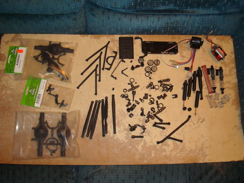

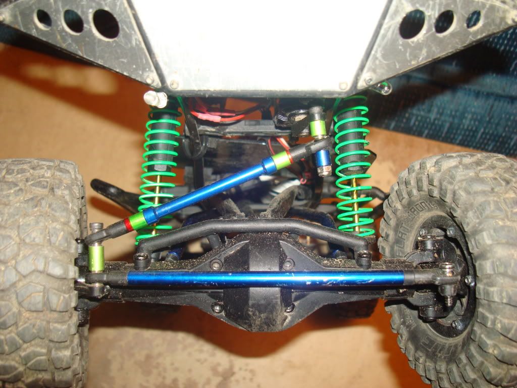

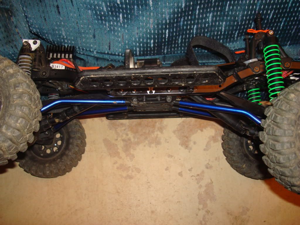

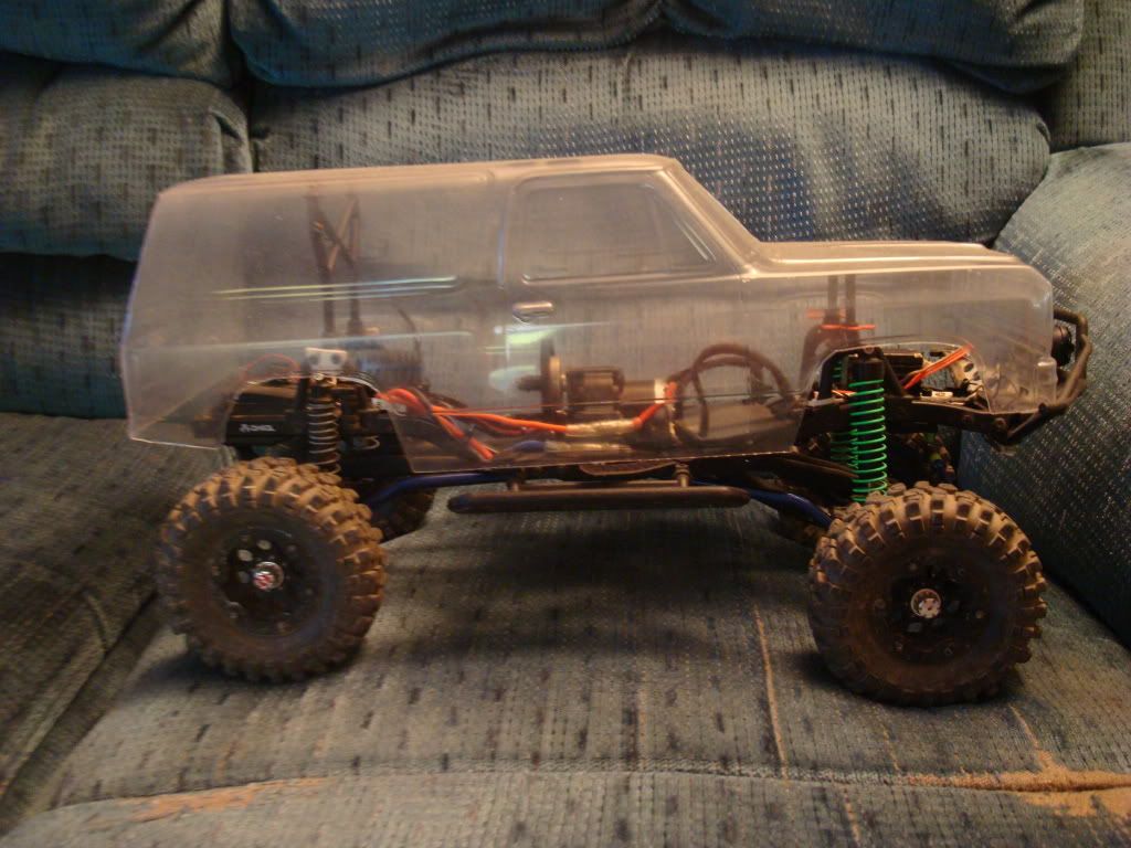

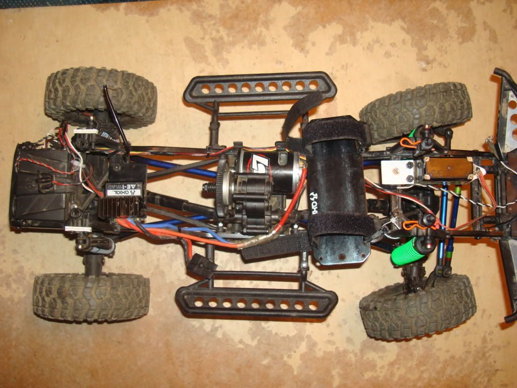

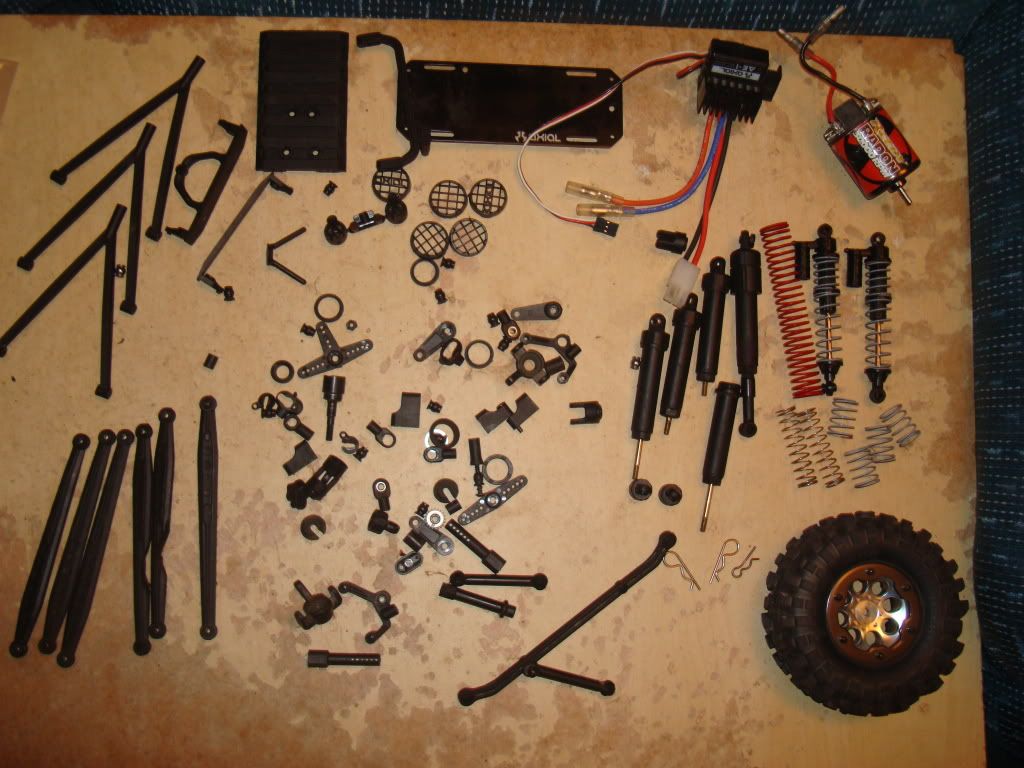

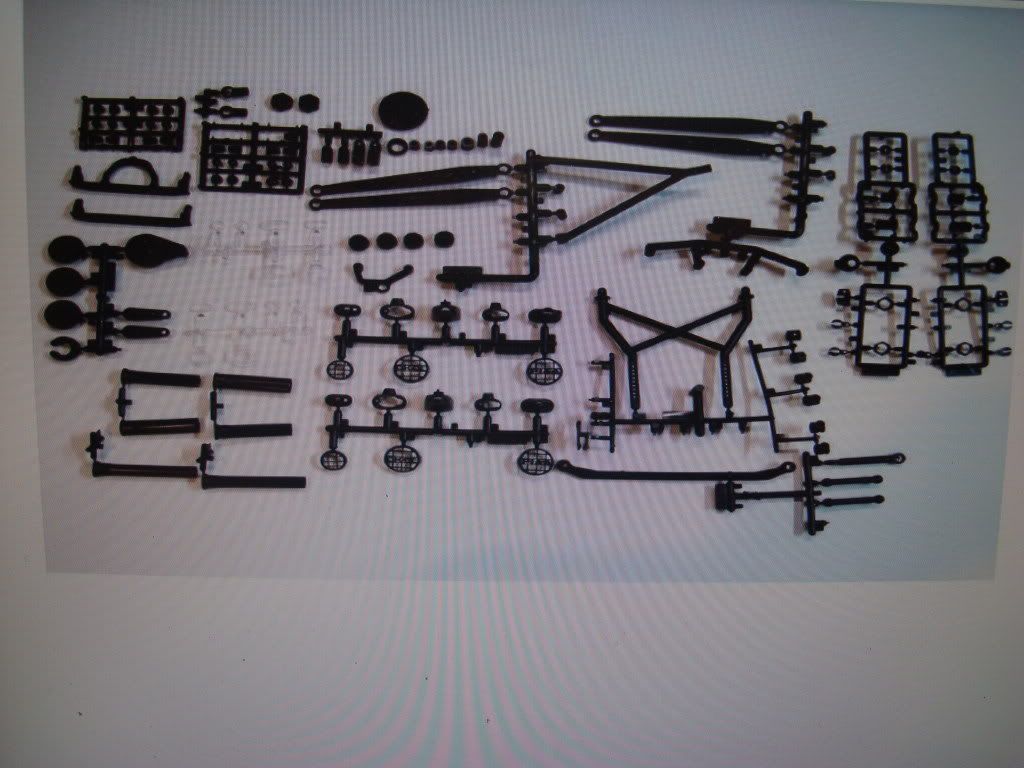

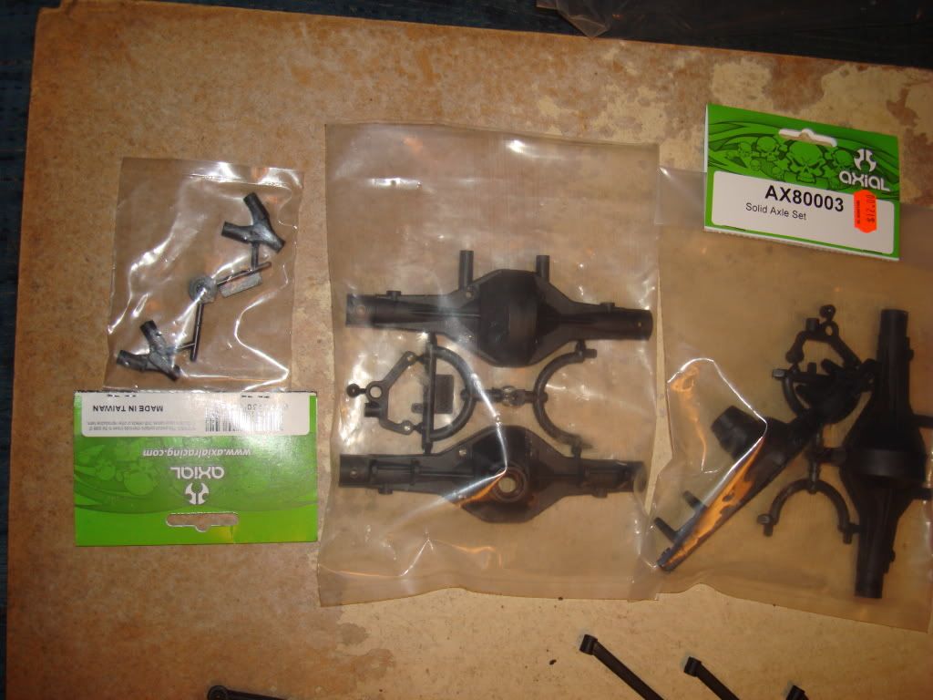

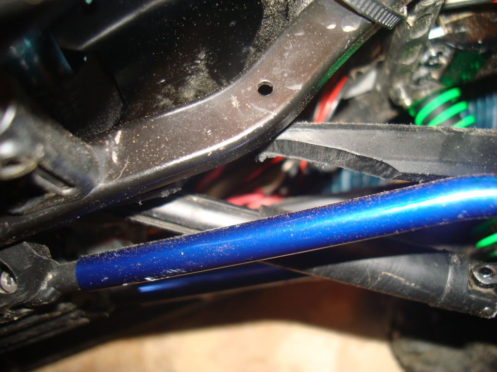

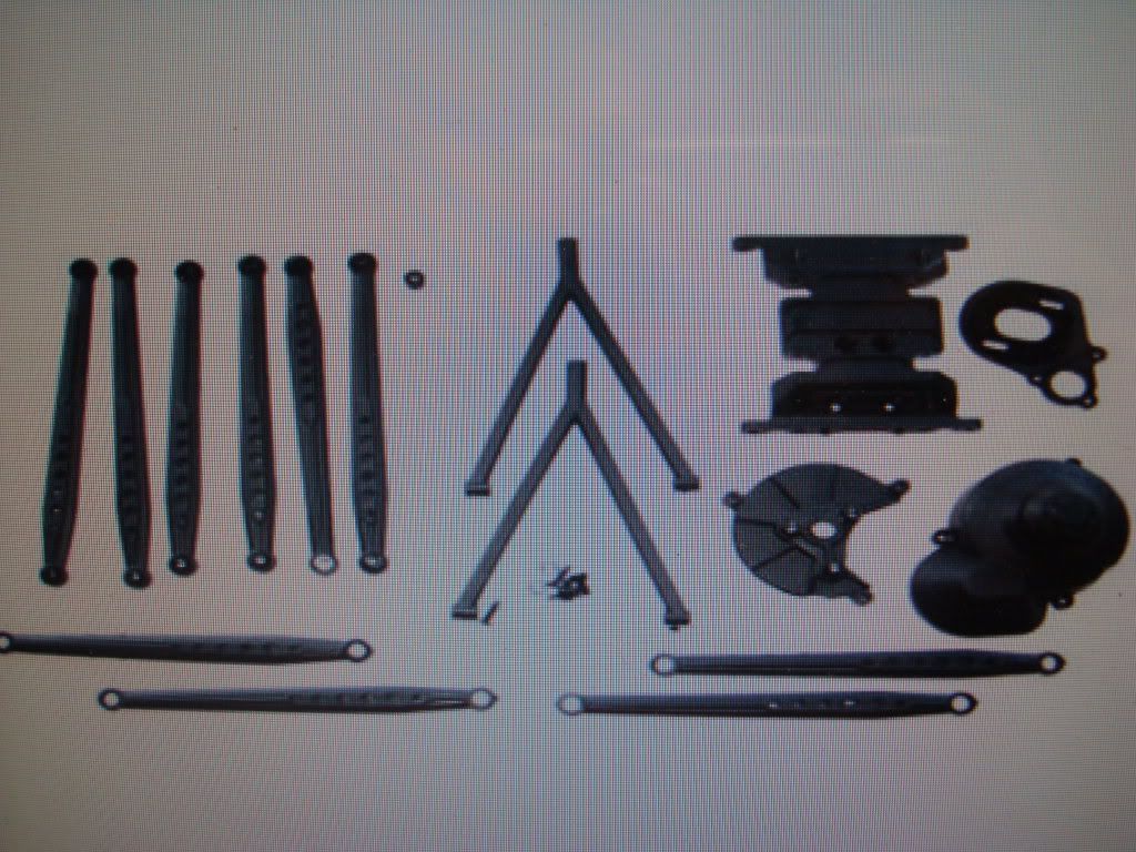

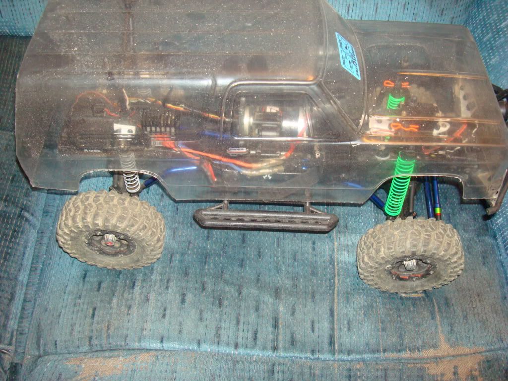

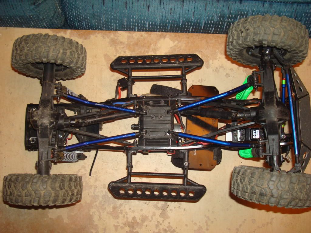

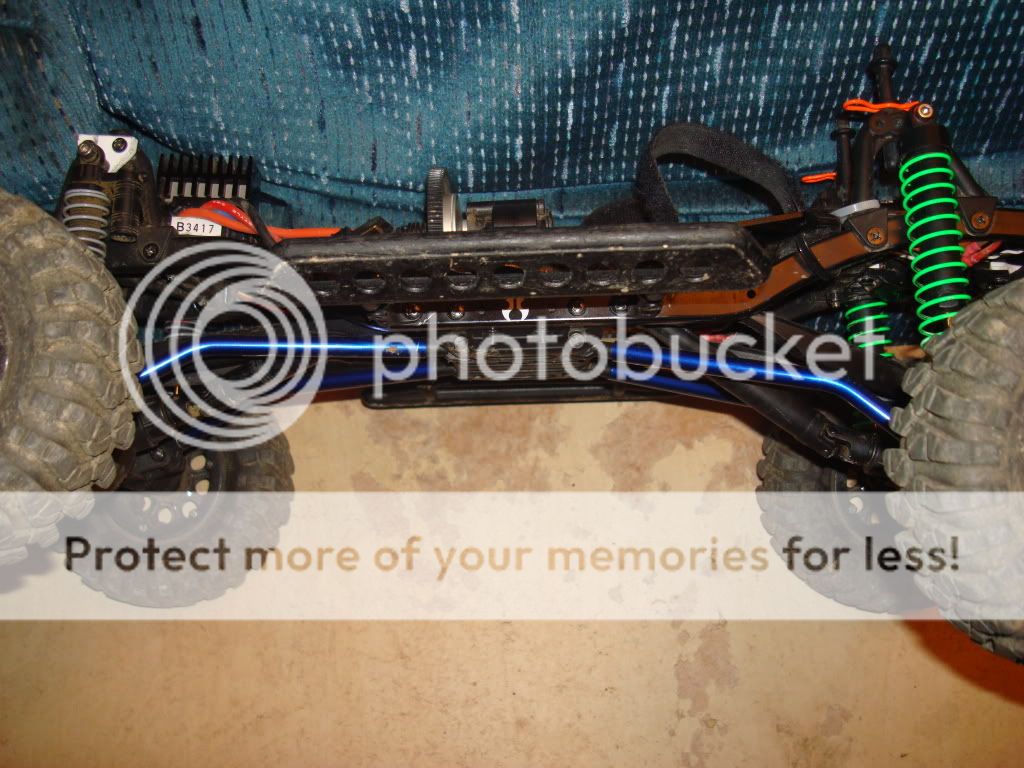

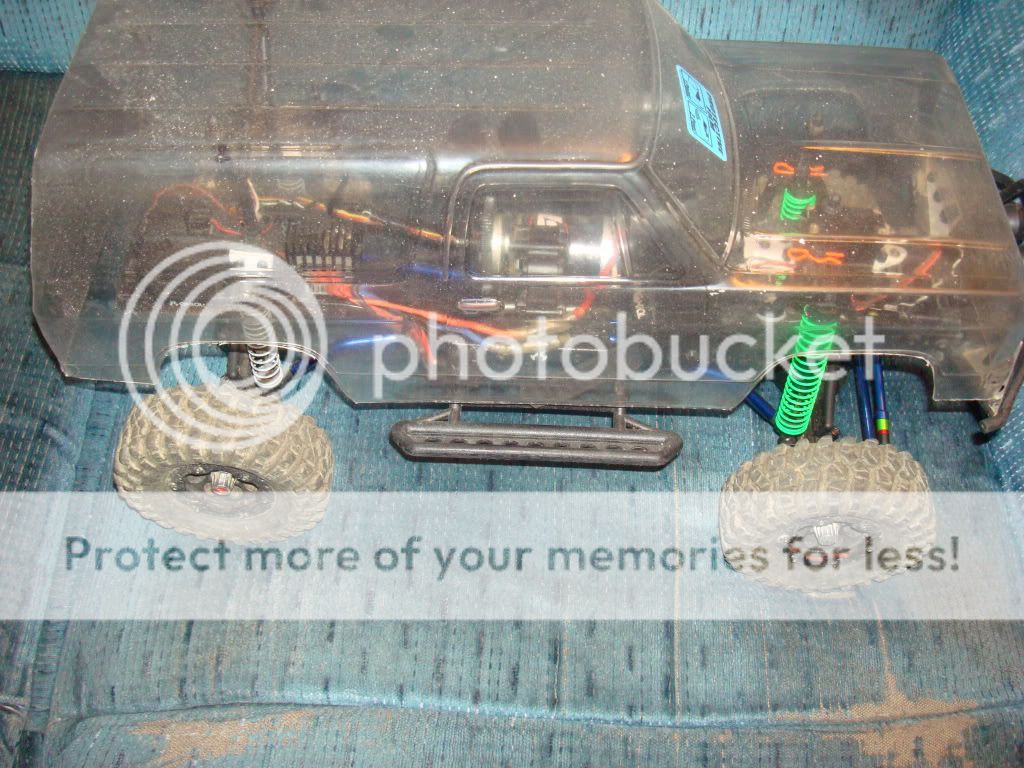

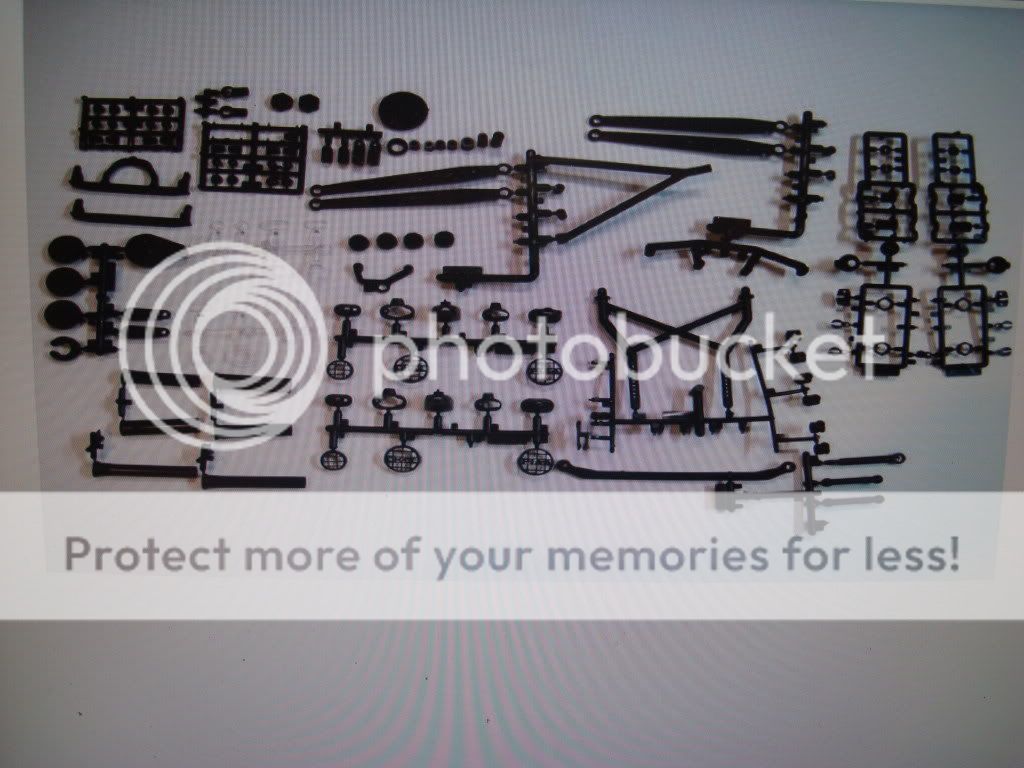

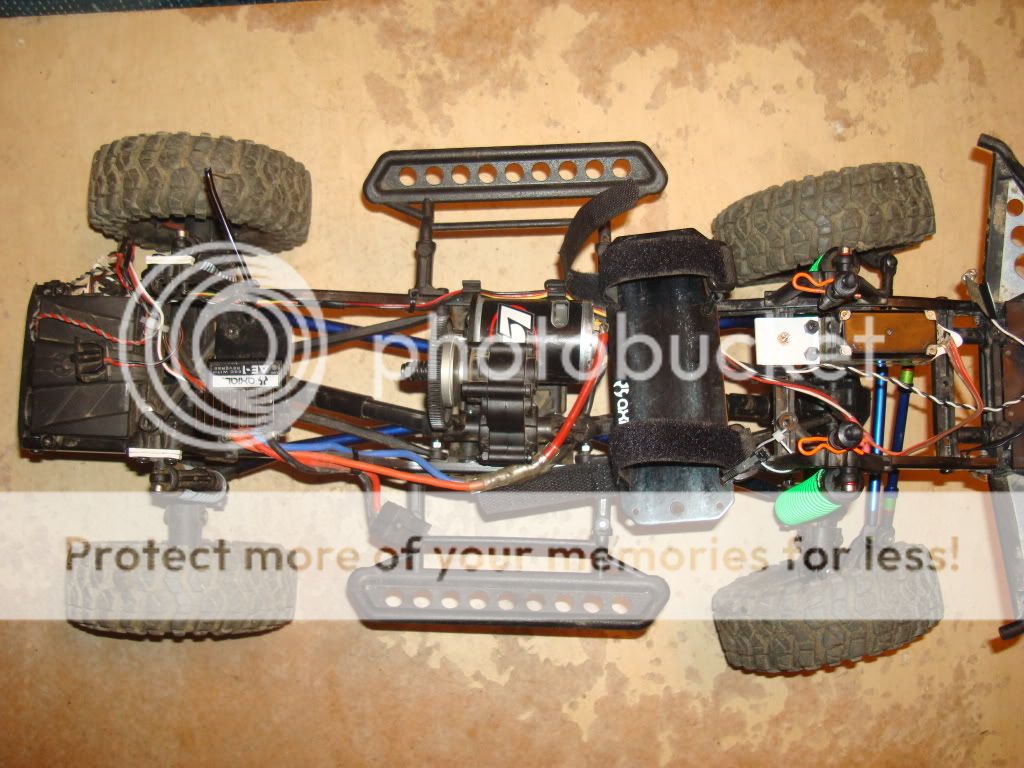

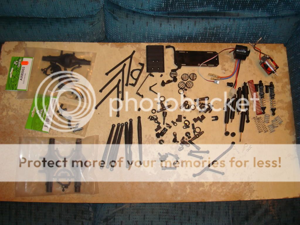

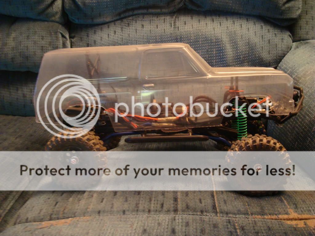

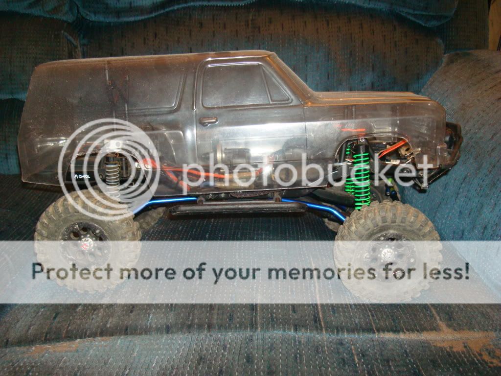

    ok here's the big picture.. with the new body on it it looks like shortening the wheelbase an inch will make it work.. but now iv noticed the front sits higher then the rear,so i put the stock shocks on it but there is not enough travel anymore(i dont know why) also here are some pics of what this guy did to it before i got it.. along with all the extra parts i have for it. also the steering servo is now on the frame which causes the steering to SUCK due to it moving the frame more then the front tires.. if i cant fix this and make it work.... maybe one of you guys would wanna buy it with all the extra parts and bodies,for the amount it will cost me to go buy a stock bottom of the barrel scx10 dingo.
    It looks to me like you've got everything you need there to make that crawler work well plus enough parts to hop it up or repair any future breakage.
    Moving the steering servo to the front axle would be pretty easy and it looks like you have some, if not all, the parts needed.
