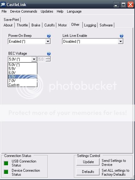

    For the Castle Creations Phoenix ICE line of ESC's we do have a choice of BEC voltages as
    shown in the PIC below. And BEC max voltage tops out at 7vdc ... However for their
    older Phoenix ESC's different BEC voltages was not an option enjoyed, well not with the one
    I own it's certainly NOT a choice ;)
    I think having a choice of 'BEC voltage' is their newest feature offered with all their new or
    newest ESC's
    newest ESC's

    I checked in my castle software, using the demo mode for the entired line of Sidewinder ESC and the SV2 and it look like adjustment of the BEC is not a option for these escs. there is no "other" tab like your phoenix has. however you can pull up the external casltle BEC adjustment page from the drop down menu on the opening page. I would rather not spend $25 on a BEC though...
