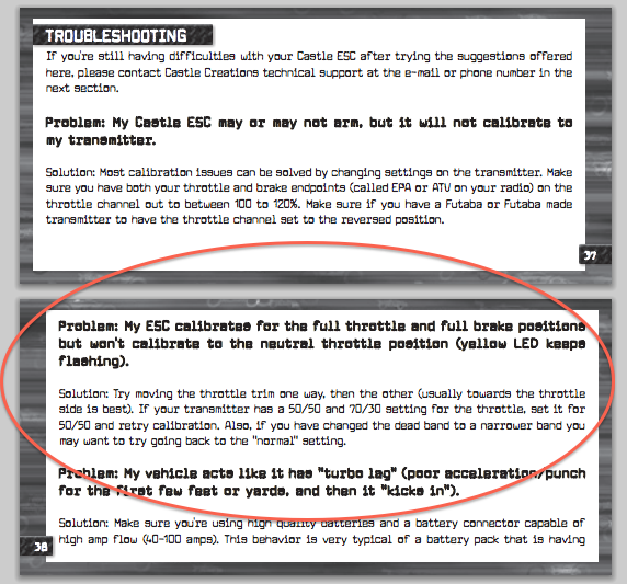

    Reading the manual helps immensely here fellas, instead of drawing conclusions find facts.  Flashing yellow means that there is a fault in the esc.  In this case it could be an overvolt situation, or fault of the board to see total RPM.  Either way read the instructions they are there for a reason.
    Good idea:
    Castle Creations Sidewinder SCT:
  9. sinistercad
    Read through what he is saying John, The esc "works" it will go forward and reverse which means the neutral set is close enough to work.  But when he hit "full throttle" it cogs or as he said it "clicks" and wont move and stops.  This points to the two issues I referenced earlier.
    Caleb - When I read his original post I understood that it was working (properly I presume) and then later started to cause him trouble when he gave full throttle.  That would indicate that the neutral had changed.  I would try a re-calibration...it's free.
