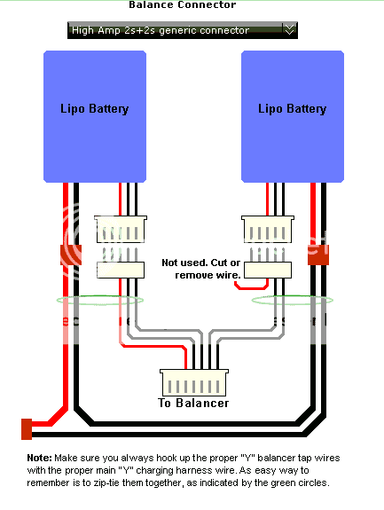

    Here's what I'm considering...
    please excuse my drawing skills.
    [glow=red,2,300]
    [size=2em]OK the above diagram is bogus![/size][/glow]
    This is what I'm looking for:
    http://scriptasylum.com/rc_speed/lipo.html
    scroll down to "Balance Connector" and select "High Amp 2s+2s generic connector".
    Hi Smitty
    I assume the following is the set-up your looking for
    If so unfortunately I would only know HOW to make it myself, DIY ...  or even MacGyver'ed
    As to where to BUY this Balance Y-Harness I would have to search for it?
    Off the top of my head I have NO CLUE as to where to buy as I never had the need to look, sorry bud
    Maybe someone else knows better ??
    Good LINKAGE by the way, going to bookmark for my own reference [​IMG]
  8. smitty
    I have found a Y harness for 2 x 3S from a 6S but so far not what I'm looking for.
    But with this diagram, I can build my own.
    Thanx for posting that diagram.
