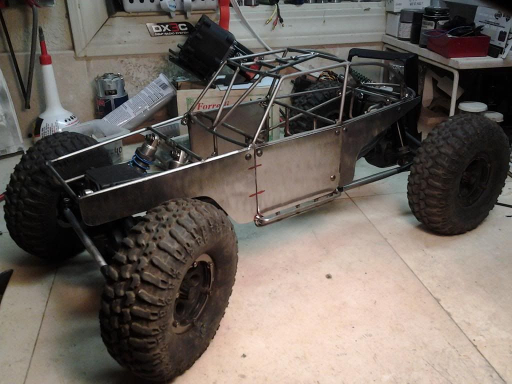

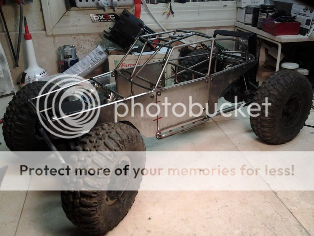

    Its a lot of work doing build threads that no one really cares about. Taking pictures and dealing with uploading them is kind of a pain if your doing it for no real reason? Then on top of that all the negative karma points thing i figure most would rather i keep to myself and dont wanna hear what i have to say. If i dont feel welcome somewhere a LARGE part of the local crawling community wont either. We are all still out there and building new rigs and running them though. Im building a ultra4/rock bouncer right now. Bullet proof custom frame with all hand cut steel body panels.

    Wow, that's really bad ass Erin! I too like the build threads and I'm sorry that a few bad users we have here have made people feel unwelcome. I know what you mean and certainly can't blame anyone for feeling that way. John and I have tried to remedy some of that, but I still see it from time to time :(
    Anyway, back to your new build. What are you using for drive gear and electronics?
    What's a "rock bouncer"?  Is that something new?  Does rock bouncing require such a heavy duty chassis?  You chassis work looks awesome, as does all your work.

    that things is coming along great erin!

    It has Axial axles built with some super tough parts and a Venom Creeper tranny. I chose the creeper because of the wide internal gears and durability. Also the motor is centered above the outputs allowing me perfect shaft angles and minimizes torque twisting under power. Im gonna feed it 3s and 4s off a BH LT4 120a into a Tekin or Viper sensored motor. 13.5 or 10.5 depending on what Im doing. I might even drop in an 8.5 and some paddles and use it for some water skimming :D.

    I dont really like the term "rock bouncer" only used it because more people know them by that name. They are southern buggys by a better name. Not really new but recently gaining popularity in the last few years due to some insane buggies and even more insane drivers. They use the toughest cages of any motorsport on the planet hands down. They use a ton of short runs of tube with tons or triangulation. A lot of guys that don't understand them will call them spaghetti buggys because of all the tubing used. They have between 400-1000 hp motors and the toughest axles under a vehicle. Their axles are now being built stronger than a monster trucks even. They are built with the sole purpose to kill the nastiest steepest hills possible. They are like our American version of Formula Offroad or FOFF.

    Dude thats ganna be bad ass!! Now its got me thinking!!!!
  12. bozzoreed89@gmail.com
    That beast looks super tough good work man

    So if these style 1:1 trucks have all those powerful engines and super strong axles how will that equate to your RC version?  Are we taking about a Castle Creations Mamba Monster ESC and 1/8 scale motor in a 1/10 scale truck running 6S with monster truck axles?  It looks like your chassis will handle anything you could throw at a RC truck.

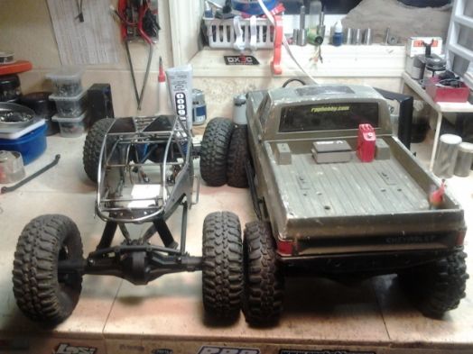

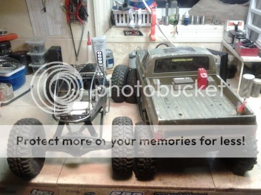

    Its actually a lot smaller than it looks and surprisingly light. It is all 1/8 rod not the more common3/16. Im only looking for a top speed in the 25-30 range so I hope a 1/10 system gets me there. I think a 10.5 on 3 and 4s will be wild like those videos.
    Here it is next to a clod bodied truck thats on the smaller side of 1/10 itself. The large 1.9s on the buggy are a bit deceiving when viewed alone. You kinda assume its big because of them.

    As they say on the east cost "That there's wicked awesome!" Can't wait to see her go!
    Oh yeah, I see what you mean.  I thought it was E/T-Maxx size.  4S?  That will make it go!  Looking forward to some more photos as you progress.
