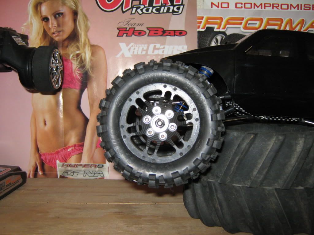

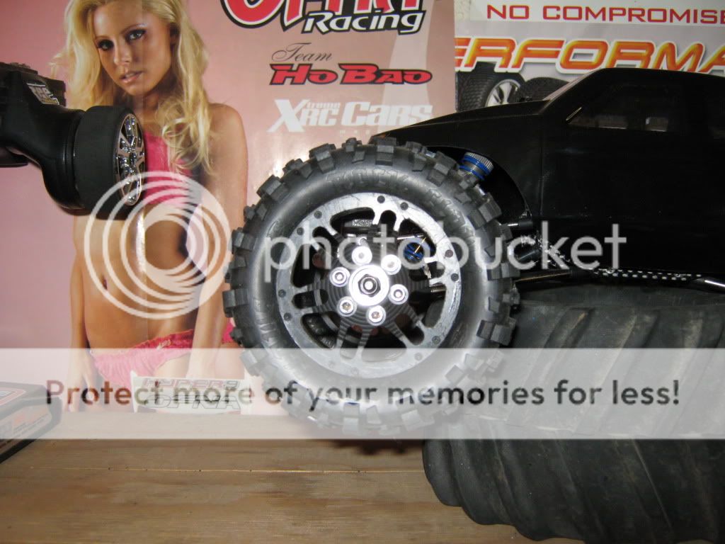

    http://i1234.photobucket.com/albums/ff401/80yotapane/Snapbucket/024cc7d1-aeaf-4329-904e-0e13f78bde68.jpg
    these are the CAC 2.0 derlin wheels ill be puttin on this thing, the chassis has since been re-worked due to poor planning on my part the front suspension had great travel but not enough room for the front driveline ,and the rc4wd trex axles being total crap(broken 3 knuckles just test fitting stuff!),so... ive grafted the front framerails and skidplate/motormout to the rear of my chassis, keeping the rear leaf springs and re-mounted the bumpers, in turn, I was able to lower the body on the frame and correct a small wheelbase issue it had.

    saw it tonight....looks great.black cab,bumpers,and wheels really works......nice rig.

    Looks like a sweet project for sure with some nice body work. That bumper is nice it looks like a Road armor one kinda. I look foward to seing more of this build as it goes. Also on the pics with photobucket if you copy and paste the img code (bottom one out of the 4) the pictures will appear directly on the forum
  9. highlandcrawler
    Those are my favorite of the ones they make. I have a set on my mrc right now ;D
