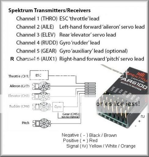

    I'm not into Heli and need help on what wire plugs in were on spektrum reciever!!??
    This should help, the Blade Sr if not mistaken runs the Spektrum AR6100e?
    Assumed correct the following is the same Rx except as in your case the designator "e" of the AR6100e model number stands for "End-Pins", the Pin-Outs are horizontal vs vertical. Vertical is shown here but technically it's the same Rx

    So think I got reciever plugged in right but I go to throttle up and blades spin for bout 5 sec then power down tail keeps spinning tho!!!!! Plz help I wanna fly this heli!!!!!! I can txt pics! Or email discrete86@gmail.com

    If the servo and Gyro connectors are all connected per the diagram posted by w00d, and the polarities are correct, it sounds like the ESC may be faulty.  Do you have any other ESC available to plug in as a test?  Even a car/truck ESC with a motor connected that is not mounted to the helicopter would suffice for testing purposes.
