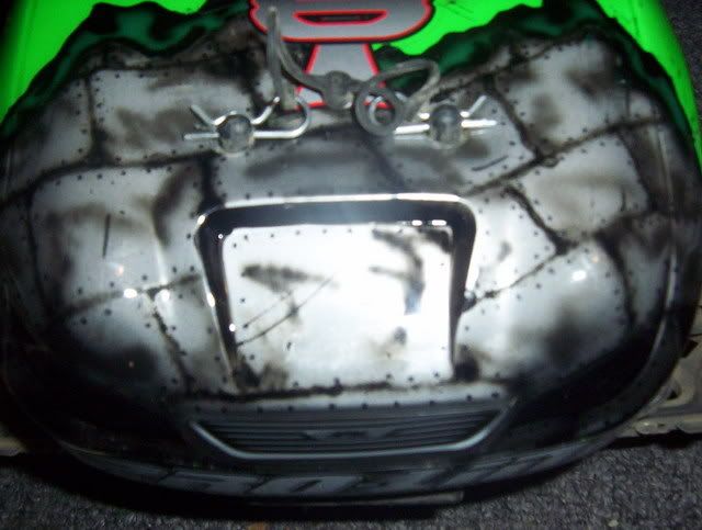

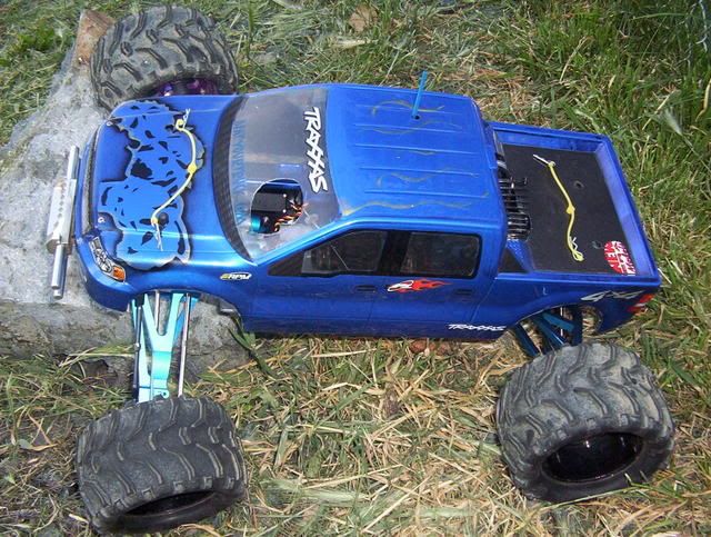

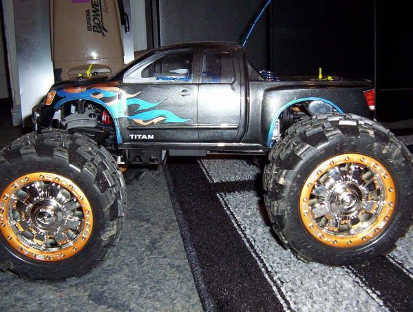

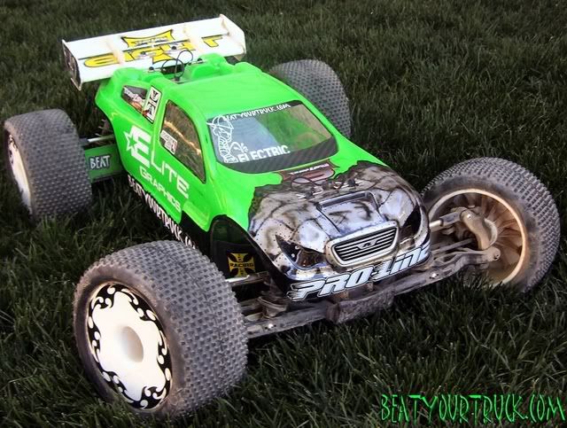

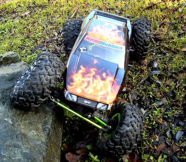

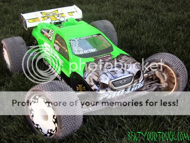

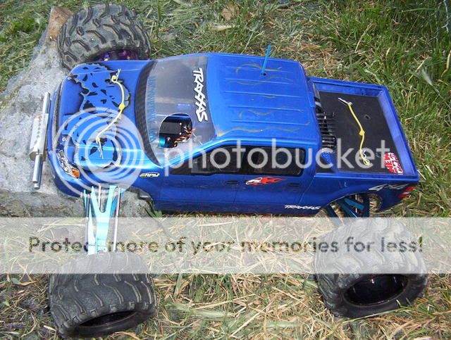

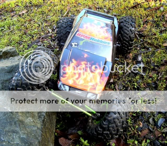

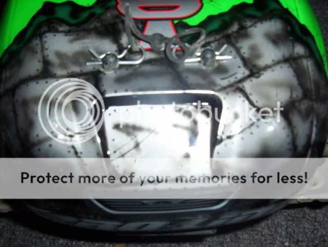

    What were you using as a thinner? What kind of paints are you using? The biggest thing to remember when airbrushing is the consistency of your paints should be like 2% milk, the reason your paint was coming out stringy can contribute to a few different factors, air pressure or improper mixture of your paint.
    If you are using to low of an air pressure the paint will dry as it is coming out of the gun (hence stringy)
    If you mixture is to thick it will dry faster as well.
    water based paints spray at a different pressure then lacquer base, and depending on what type of work you are doing your pressure needs to be adjusted to the work. I run a iwata dual action and use lacquer based paints that I thin with denatured alcohol or paint thinner, and if I am doing detail work I am usually running a 8 psi or lower pressure, for large cover I run close to 14 - 20 psi.
    I will try and find some of my work for ya.
    Hey Rookie,  Did you do those flames and rivet plate paint jobs?  That is some great work.
  8. pile of toys
    inspired=rookie is the MAN
  9. Rookie
    Rookie Registered
    17
    Yes everything in the pictures I provided was painted by me.. and thanks guys I try
